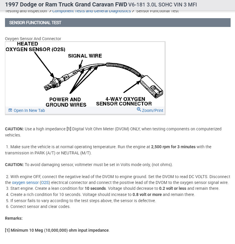

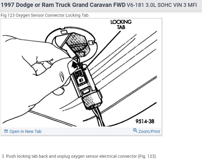

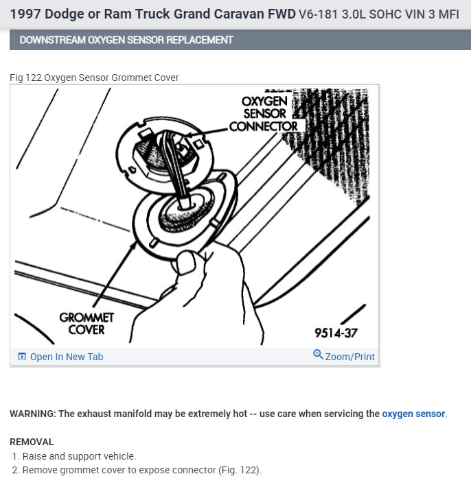

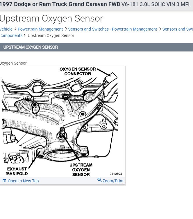

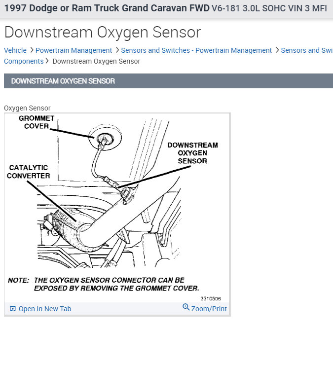

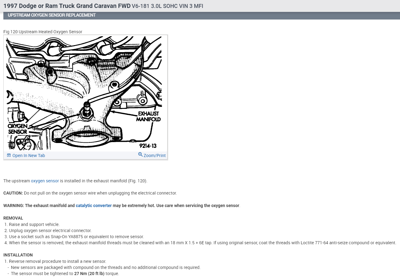

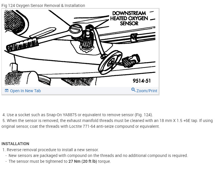

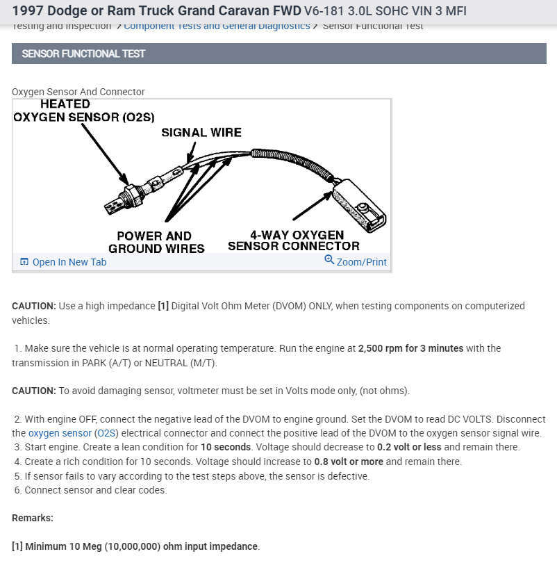

Where is the oxygen sensor located on my 1997 Dodge Grand Caravan, 3 liter V6?
Monday, July 21st, 2008 AT 8:59 PM
SQM
MECHANIC
6,383 POSTS
There are three oxygen sensors for this vehicle.
One in each exhaust manifold and one after the catalytic converter.
https://www.2carpros.com/articles/how-an-oxygen-sensor-works
https://www.2carpros.com/articles/how-to-test-an-oxygen-sensor-02-sensor
https://www.2carpros.com/articles/how-to-replace-an-oxygen-sensor
