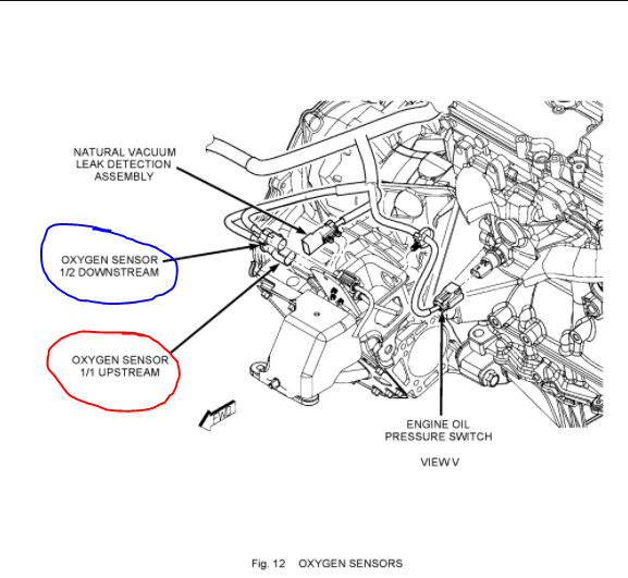

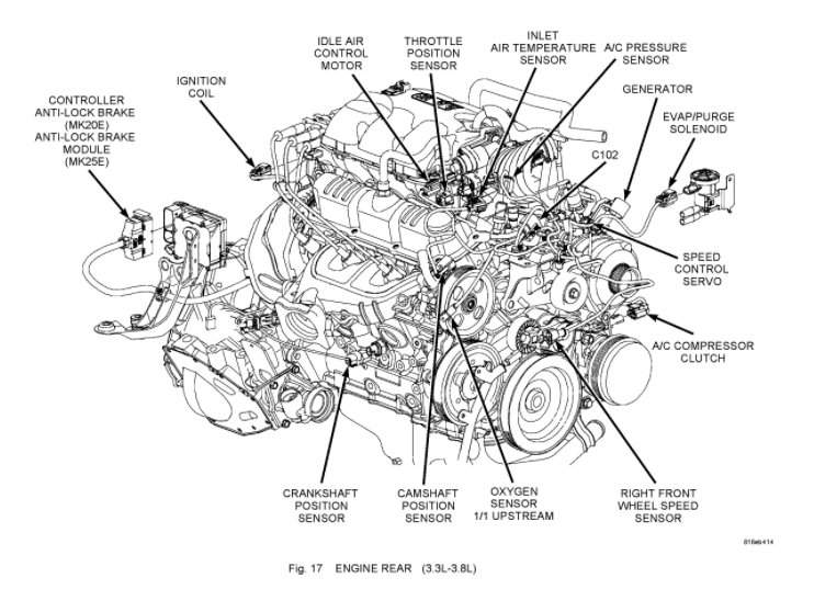

I need to change the bank 1 sensor 1 oxygen sensor
2007 DODGE CARAVAN
58,000 MILES • 6 CYL • 2WD • AUTOMATIC
THEREDDOOR
Apr 23, 2010 at 8:13 AM
DANNY L
  • 5,648 POSTS
Hello, I'm Danny.

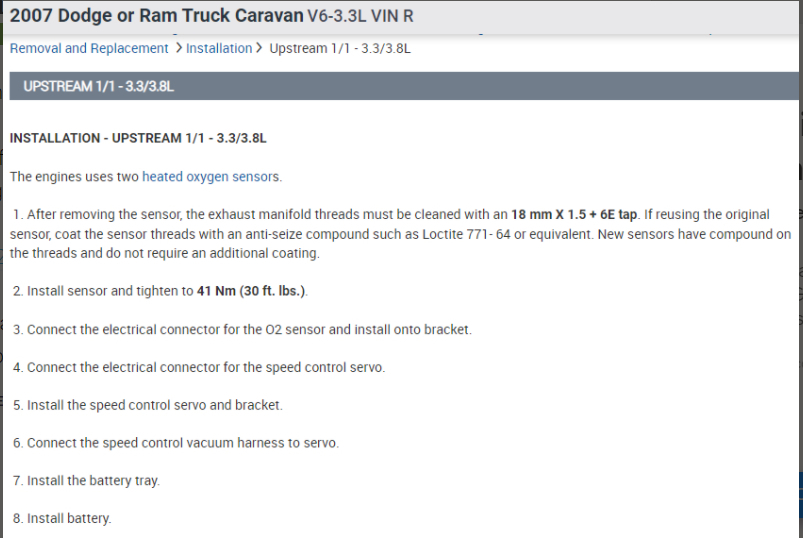

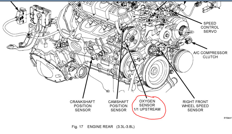

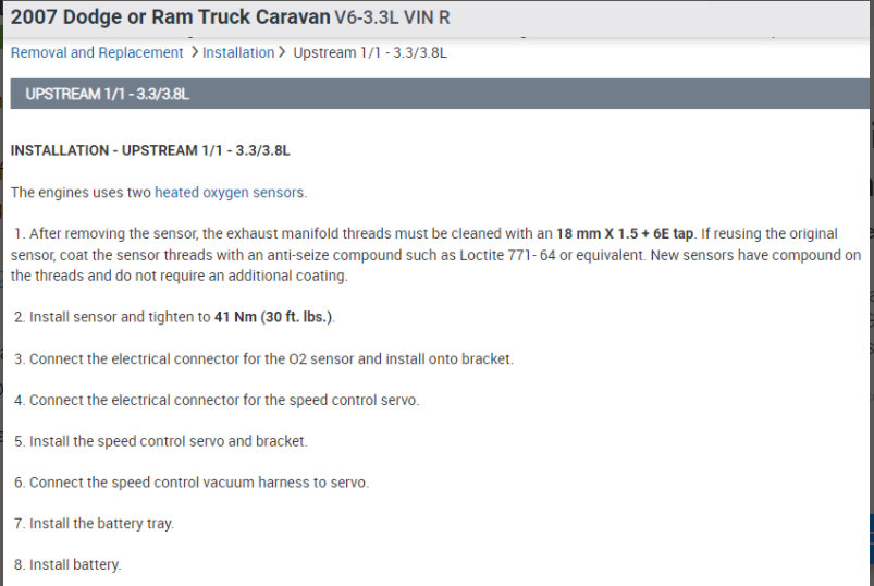

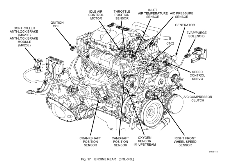

Here is the information you requested. This is a tutorial for you to view showing oxygen sensor replacement:
https://www.2carpros.com/articles/how-to-replace-an-oxygen-sensor
I've attached a picture step below showing oxygen sensor replacement for your as well as pictures of the Bank 1 oxygen sensors on your Caravan. The sensor I've circled in red is the Bank 1 sensor 1 you want to change. The sensor I've circled in blue is the Bank1 sensor 2 downstream sensor. Hope this helps and thanks for using 2CarPros.
