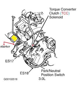

I need to know where the starter is located in this vehicle. I am having a problem with it starting intermittently and I need to check to make sure that the wiring is tight.
Had a similar problem last year and had someone tighted the wires and it has worked fine since then until now.
It will start sometimes very consistently and other times not.
Nothing in my owners manual shows me where the starter is located so that I may check the connections.

Hello, This guide should help https://www.2carpros.com/articles/starter-not-working-repair
https://images.2carpros.com/forum/automotive_pictures/99387_plymouth_tcc_3.jpg

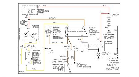

I have a 1995 Dodge caravan shut it off and suddenly it won't crank over. Has a 6 cyl engine 185,000 mi. I have checked the fuses and the battery. Lights and horn and information lights in the dash work. Starter does not seem to engage and i'm not sure where the starter is to check the wiring. I'm not sure what else to check. Can you help me ?
Aug 20, 2019 at 5:49 AM (Merged)
  • 75,988 POSTS
Find the starter its in between the engine and transmission. At solenoid brown wire-look for power there while key is at starting positon-Power present, replace the starter. No power see below
https://images.2carpros.com/forum/automotive_pictures/12900_1994_dosge_caravan_starting_circuit_1.jpg
