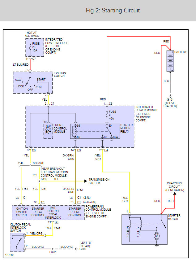

Is the security light flashing? if so I would try resetting the security system here is a guide.
https://www.2carpros.com/articles/how-to-reset-a-security-system
If not I would check the neutral safety switch or starter relay. Here are guides and diagrams to help.
https://www.2carpros.com/articles/how-a-neutral-safety-switch-works
and
Check out the diagrams (Below). Please let us know what you find.

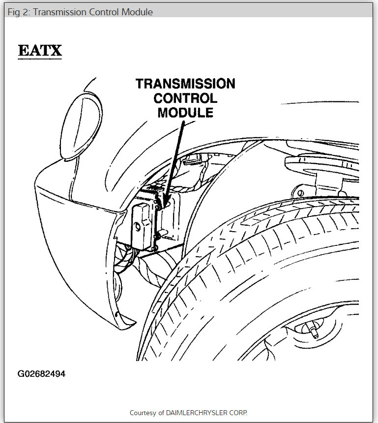

It does not have grounds to the relay coils to latch relay contacts that was my guess that the computer went out. thanks, I did not have a schematic of the computer but using logic that is what I came up with! the other part of the question was which one was it? another site tells me in my van there are two computers, one behind the driver headlight and one behind the driver side bumper. my guess it is the one behind the head light. Thanks, Jerry
Feb 4, 2009 at 5:47 AM
  • CERTIFIED EXPERT
  • 75,992 POSTS

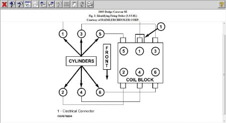

Below is for the transmission control module the main computer for both the transmission/engine so you can see the location (below)
Feb 4, 2009 at 2:07 PM
JERRY 9947

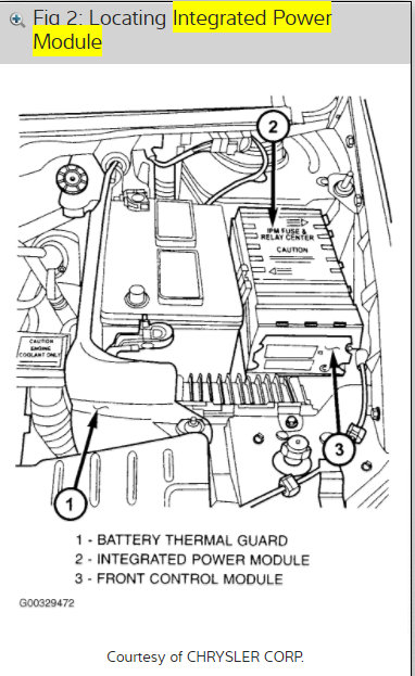

my van has two modules I took both out 1) one was behind the bumper on the driver side. 2) the other was in front of the battery on the driver side. Your diagram is for an inline six cylinder engine this one is a trans-axle side ways engine. I have the part numbers for both modules. the one in front of battery is #472521aab the one behind the bumper is 4727721ae. I know of no Caravan with a straight inline engine. I took both modules to Autozone who advertises they check modules, but they do not do it!
Feb 4, 2009 at 3:14 PM
  • CERTIFIED EXPERT
  • 75,992 POSTS
It is not an inline engine it is a 3.3L/3.8 Transverse engine.
https://www.2carpros.com/forum/automotive_pictures/12900_transverse_engine_1.jpg
Feb 4, 2009 at 4:13 PM
JERRY 9947

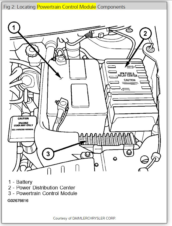

Sorry you are right v6 not straight six. too many cars here to keep up with but only one Dodge. I got the right module location it was the one in front of the battery not the one behind the bumper that's the transmission module Haynes manual was incorrect as to where the PCM module is. However, the Dodge dealer said there were two different late and early starting 2003 the early model used one module and later went to two modules. thanks for all your help! this was a learning experience for everyone involved. I will order module from internet tonight $199.00 with lifetime warranty in stock and includes shipping. Dealer did not have it ten to fifteen working days to get it. No brainer the net has it and I will have it in three days not weeks. I will post to let you know if that cures the problem I think together we agree it has to be the module. Jerry
Updated 3/5/09
It was the PCM module. I replaced it with the $199.00 from the web came pre-programmed ready to plug in. that is what I did. cured all problems plug and
play the code reader did not show a code or fault that was what I could not
understand. but all the electrical checks pointed to the PCM module so I went
with logic; replaced the PCM module it will fix it! removed the two bolts
from top bracket and the three bolts that hold the headlight assembly and
remove headlight assembly for access to the one bottom bolt for the module
unplug the two cables replace module and reinstall every thing in reverse.
It is a done deal in fifteen minutes in the dark. Jerry
