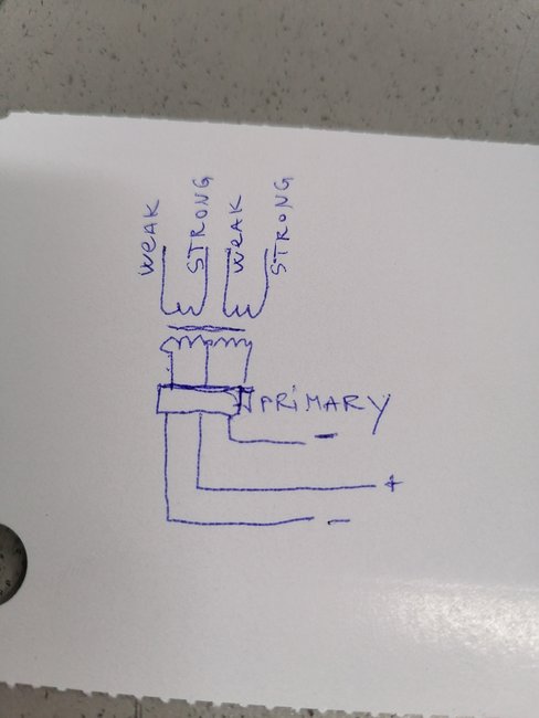

Should the spark be with same intensity on all cylinders? Mine is weak on 1 and 2, and very strong on 3 and 4. I have replaced the spark plugs, wires, and ignition coil pack, but result is the same. What can be the problem? Car listed above has had engine replaced with Zetec 1.8.

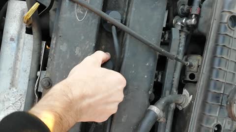

I'm going to make short video with the sparks in about 2 hours when will be back at home because I'm night shift at work at the moment.
Sep 30, 2020 at 12:39 PM
WISH30
  • 124 POSTS

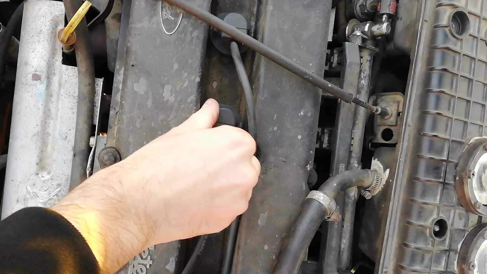

Here it is. First and second are the same, third and fourth have strong spark.
Sep 30, 2020 at 3:13 PM
Okay. That helps. I don't think you have weak spark. Just because it is not arcing or sparking out of the boot when you remove the wire doesn't mean it is weak. I agree that the other cylinder sounds stronger but if you have a rough running condition then we need confirm some other things first before we go to a weak spark.
As I was saying earlier, the strength of the spark is determined by the primary side of the coil supplying the low voltage and then the igniter in the coil causes the high voltage for the secondary side to deliver to the spark plug.
I would suggest checking for a vacuum leak and compression of the engine before we go much further.
The other reason I don't think you have weak spark is because when you pull the wire from that cylinder you can hear the engine change as it is now misfiring and it is about the same as the other cylinder did.

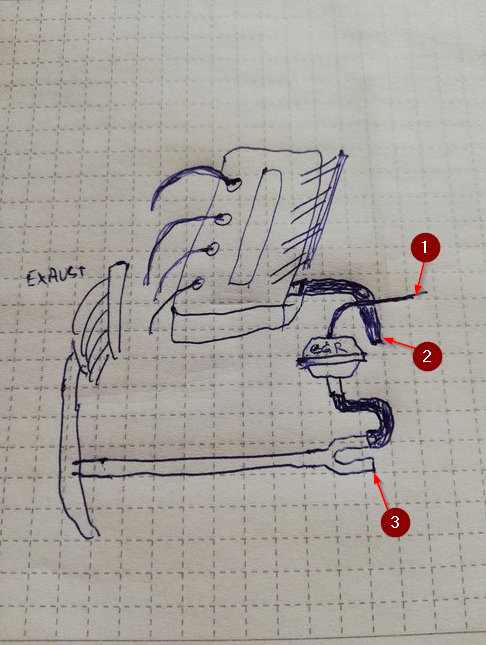

I went to a local mechanic and he says that compression and vacuum is good. After that I removed and cleaned the IAC valve, measured its resistance it was 11.1 ohms and tested with 12v adapter. After placing, the driving is more smooth, stalling is almost unnoticeable but still persist, and idle rpm is more stable. But, rpm is still high and not as normal as it should be. When stay in one point and in idle, rpm is about 1200, when driving in some shift it variates depending of the speed of moving, but, when moving in idle it stays on 1500 until the engine completely stop and then it rise to about 2000 for a second and drops to 1200. What I noticed is that one of the cracks of the pipe that comes from exhaust is connected by hose to EGR valve, and other is not connected to anything. Also the upper right corner opening on the head cover is just a hose plugged and not connected to anything.
Oct 7, 2020 at 8:06 PM
Okay, that is progress.

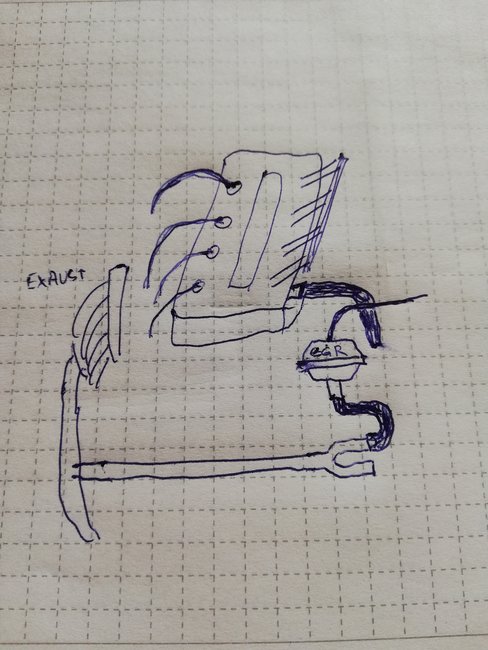

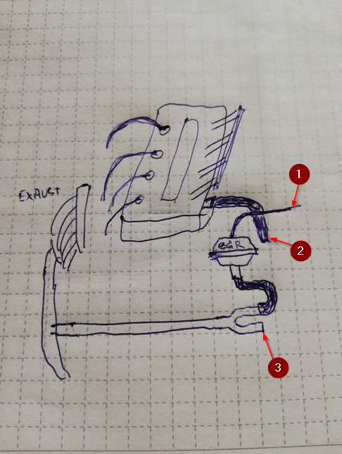

Let's start with clarifying this so that we are on the same page. On your drawing did I number the locations of open hoses correctly?
If so, number one should be connected to the engine/airtake. This is where the exhaust gases enter back into the engine so that they can be used to reduce emissions.
Number 2 appears to be the PCV system that takes engine crankcase gases/blow by gases and puts them back into the intake to be reused. Again to reduce emissions.
Number 3 I do not know what that would go too so I am hoping that is not an open hose.
Oct 8, 2020 at 11:39 AM
WISH30
  • 124 POSTS
Sorry I have a mistake on my drawing. There should be one more main pipe that goes directly to EGR valve, and those two fork pipes should be connected to DPMF sensor (I saw it on diagram on Google). One of the sensor hoses was unplugged and I plugged it on the pipe but nothing got better or worse. Then I tried my last option, unplugged the vacuum hose from EGR and blocked it to prevent vacuum leak. After that driving got too much better and very smooth, but idle got worst. When stay in place it is still high, about 1250, but when drive in idle, it fluctuates between 1000 and 2000 (I made a short video). When driving in some shift, and want to stay and change in lower shift, in that moment while stopping and pressing foot brake and clutch, rpm rises to almost 3000 until you put the gear in shift and rpm normalizes while unpressing the clutch slowly to get drive. Also what is suspicious (maybe not a factor) is that digital speed meter show some value when staying in place for example 20-30.

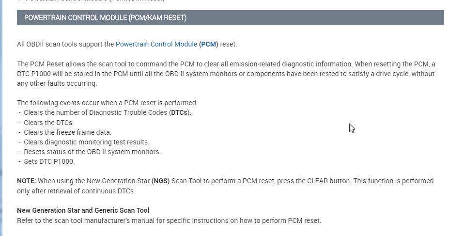

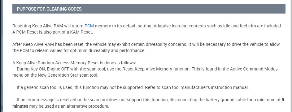

Okay. How long have you driven the vehicle since you unhooked the battery? You are in effect wiping the keep alive memory which supports the fuel adaptives and the idle. Take a look at the information where it explains what happens when you reset the PCM. Clearly the best way to reset this is with a scan tool.
Are you touching the cables when you unhook the battery and then leaving them off for 10 minutes? This is a capacitive discharge which will drain the PCM's keep alive memory. If you unhook the battery for 10 minutes the keep alive memory may be wiped but there is a chance it will remain as this was designed to try and hold this small amount of power so the vehicle doesn't have to relearn all this if the battery is changed.
Oct 10, 2020 at 8:11 AM
WISH30
  • 124 POSTS
Yes, I connected both cables with a wire while the battery was disconnected.
Oct 10, 2020 at 11:01 AM

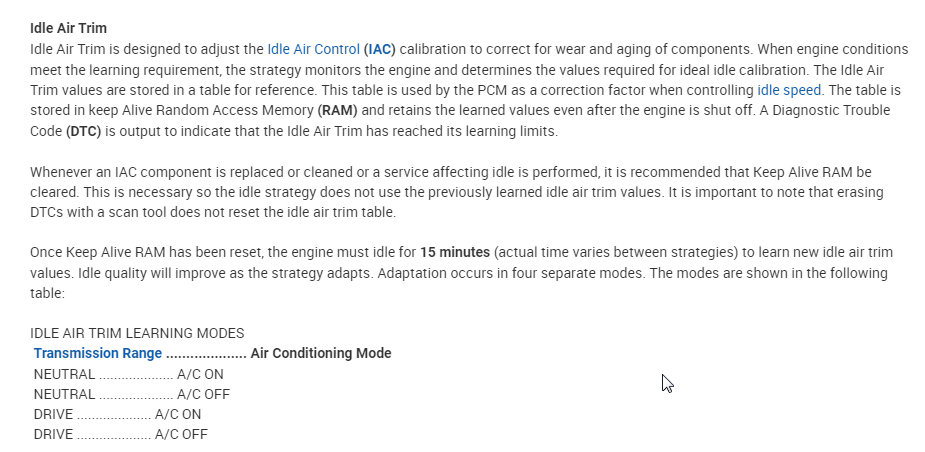

Okay. Take a look at the last attachment where it runs through the learn process for the idle. Then it will adjust as you drive the vehicle. If it is running stable but just a high idle or RPM then I would recommend putting some miles on it and see if it adjusts. If not we can address the idle control which is part of the throttle body.
I would say to let it idle for 15 minutes and then just put about 50 -100 miles of normal driving on it and see if it brings it down.

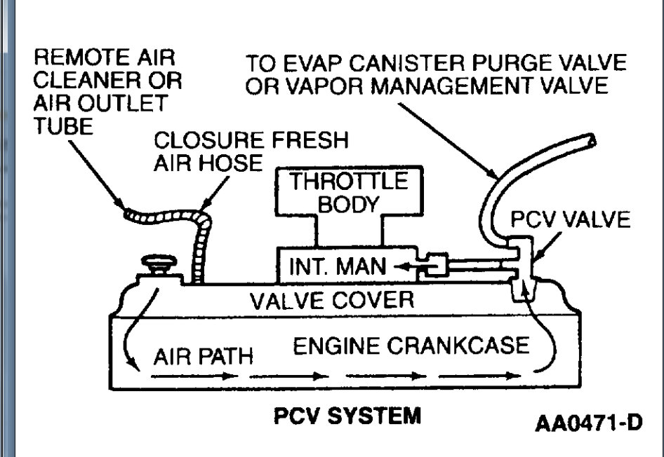

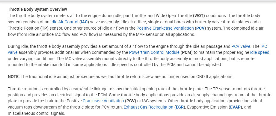

Can it be caused by cam cover ventilation hose (that one attached on the upper right corner of engine cover) because it is not connected on intake system?
Oct 10, 2020 at 11:46 AM

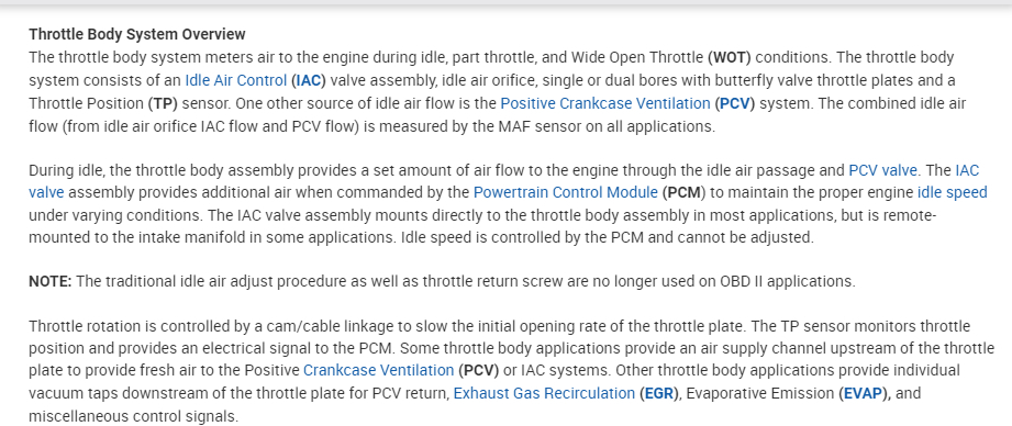

You mean the positive crankcase ventilation (PCV) hose? Here is the diagram of it. Yes. If this is not hooked up then more air will enter the engine and can raise the RPM. I guess I made the assumption that everything was hooked up correctly.
Maybe get a picture of it just to be sure. Also, is there anything else not hooked up?
Oct 10, 2020 at 11:53 AM
WISH30
  • 124 POSTS

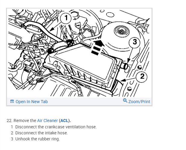

I mean for this hose, this is not my car, it is from Google, but on mine is the same.
Oct 10, 2020 at 12:06 PM
Yeah. That looks like the PCV. They call it the crankcase ventilation hose. See the attached.
Oct 10, 2020 at 12:19 PM
WISH30
  • 124 POSTS

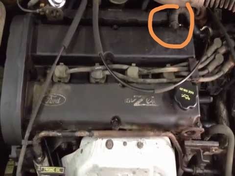

it is not attached to intake.
Oct 10, 2020 at 12:21 PM
Then I will need a picture of your engine and we need to trace this hose to find where the other end attaches. The picture you attached has the hose coming out of the valve cover in the back drivers side corner of the engine. That matches the diagram that I attached which would be the PCV. Based on the information that you provided, I am not sure what else this would be. In order for me to help figure that out we are going to need more detail and pictures of your engine.
Oct 11, 2020 at 3:54 AM
WISH30
  • 124 POSTS

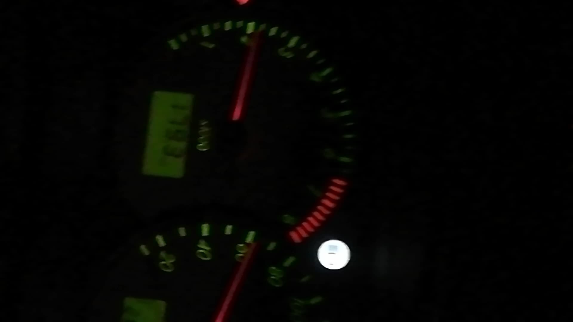

Yes, it is that hose. I took the stock filter box and saw the hole on the side where it has been previously connected. I have glued a small pipe there with a silicone and these days going to mount stock filter box and connect that hose there and will see if there is some change. Until then I would like to ask one more question, about the speedometer, does someone have an idea what can cause the problem.

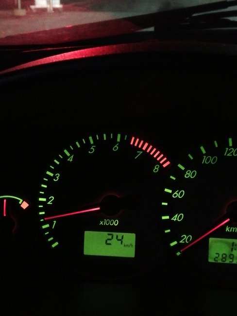

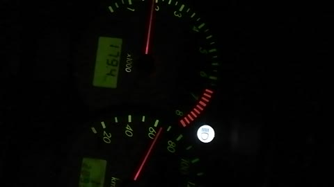

The problem is: When you drive, the needle meter show the correct speed, but the digital meter show incorrect numbers. For example you drive 50kmh, and numbers say 40. When you stop, needle goes to 0, and digital numbers stuck to some value as 15 kmh or 20-25 kmh.
Oct 12, 2020 at 5:31 PM

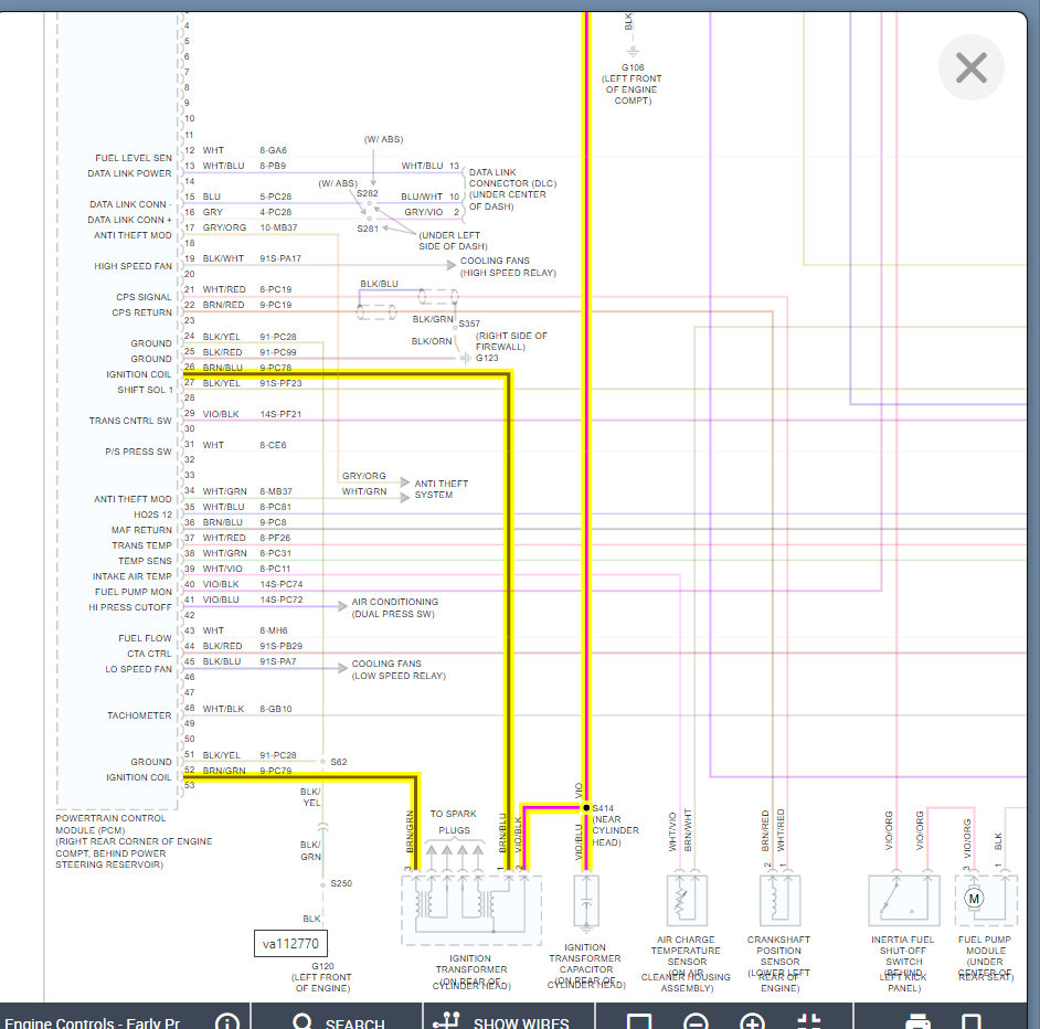

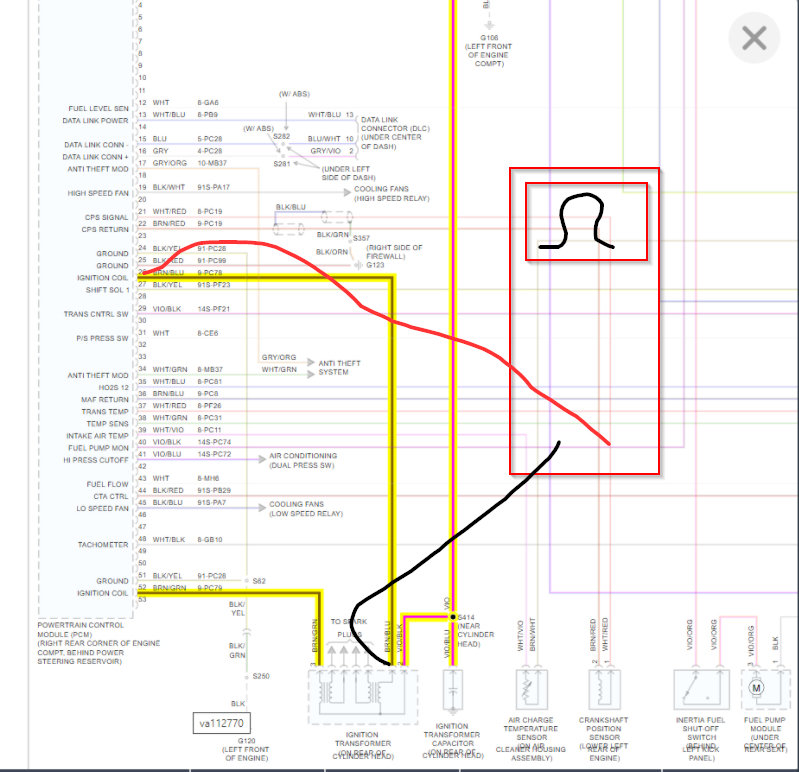

Can someone give me diagram or words explanation about the wiring of the ignition coil pack to be able to try put some new wires? Or tell me if that is normal to have one weak spark and one strong on the same coil. Because I bought new ignition coil pack, cables are almost new (also tried with another set) and there is still weak spark on 1 and 2, and strong on 3 and 4. It is noticeable, because when cable is removed, on 1 and 2, spark starting to jump only on 1-2 cm away of spark plug and is almost not noticeable, what is not case on 3 and 4 where the spark jumps about 10 cm anywhere and is strongly noticeable. Thanks
Sep 26, 2021 at 7:57 PM
The way this works is power (12 volts) is supplied to the coil through the violet and black wire. The fact that one side of the coil is fine and the other is not shows that this 12 volts is not the issue.
However, the coil then takes this 12 volts and when the signal is interrupted by the PCM it creates high voltage and sends this to the spark plugs.
What I would do is measure the resistance in the two wires coming from the PCM to the coil and make sure it is less then a half ohm in each wire.
You do this by disconnecting the circuit at the coil and PCM then set your meter on ohms and probe both ends of the circuit and see what the meter says.
Here is a guide that covers this.
If the wires both show less than a half ohm of resistance then more than likely the issue is in the PCM that is no interrupting the signal so you have 12 volts going to the plugs rather than the high voltage needed.
Take a look at the wiring diagrams below.

Dear, thanks for your answer and for your diagrams. I am going to do the measurement tonight after work and give you a feedback answer. As I understand you, I should measure the resistance between the two (as I think ground) points that come from PCM, because the center wire is common + for both coils in the pack. Here I would ask you one (between) question. Can the ignition capacitor somehow affect the spark? Because as I can read on internet it is only for radio interference removal. And mine is removed, because when I bought the car, it's wire was cut and it was just screwed, so when I replace the coil pack, I dismounted it. I mean for this capacitor on the photo attached.
Sep 27, 2021 at 9:41 PM

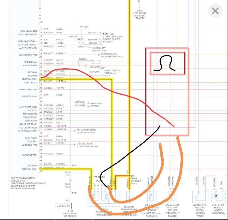

That is correct. Unhook the connector from the coil and PCM and put your leads on both ends of the wire and measure the resistance (ohms).

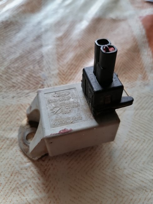

As for the capacitor, it would not cause this issue on just half of the plugs. It is there to reduce the "noise" on the circuit so that you get a good clean signal.
If yours is removed, it is a good idea to reinstall it, but I doubt that will fix this issue.
Take a look at the diagram and I marked on the diagram to try and help explain this.
Thanks

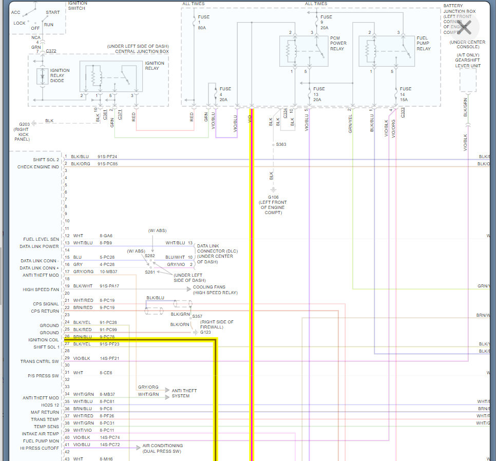

I thought that I should measure these two points as showed in attachment. But in this case as you attached, I should remove the PCM and measure the resistance from one wire end to other wire end as I can understand?
Sep 28, 2021 at 5:18 AM

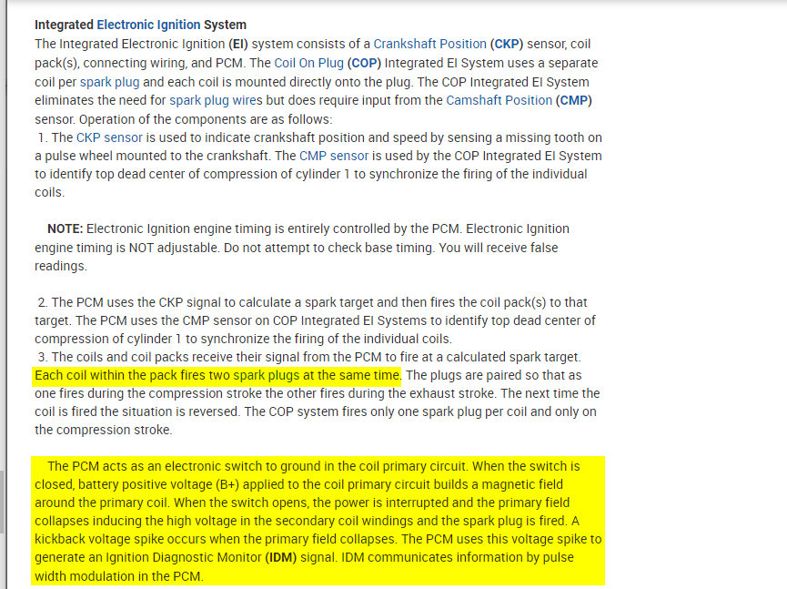

That is exactly correct. The way in which you are showing is testing the coil for an open circuit within the primary windings.
That is a good test, but I don't think that is your issue because you are getting spark on all four plugs just weak spark on two of them.
So that means either the new coil has an issue with the secondary wirings or the PCM is not opening that ground side to cause the field collapse for the voltage spike.
Basically I think you are going to have no issue with the wire and the PCM is just never opening the ground side when those plugs are supposed to fire so you never get the high voltage spike.
Clearly this is all going off the fact that you are seeing a weak spark.
With a new coil doing the exact same thing, either the spark is not weak or the PCM is not spiking the voltage.
Take a look at the info below.

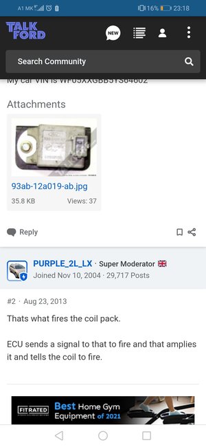

I also found this on Google about that capacitor, is it true?
Sep 28, 2021 at 7:20 AM
This is not true. The condenser or capacitor is only there to absorb excess current flow. It does not deliver high voltage or amplify it. That is solely done by the coil.
There are two main reasons for this part. First if there is excess current from other sources, it absorbs this current so that the signals are not interrupted.
The second is so that there is no arcing in the coil when the PCM interrupts it.
So now that I say this, how long did it take for the new coil to have a weak spark? I understood that it was immediate. Meaning you had weak spark, put the new coil on it and still had weak spark as soon as you started the engine.
If you have no capacitor then the coil will eventually fail because when the PCM interrupts the signal in order to create the high voltage, the current actually tried to jump across the coil and it can burn them up.
Normally this takes a little bit of time which is why I said it would not cause this. However, if you don't have one it may be the cause of the coils failing.

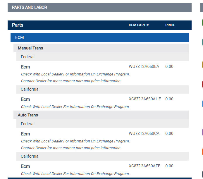

Car was bought in chaotic condition, but no one is guilty about my fault. It was bought with replaced engine. Now the engine is zetec 1.8, also it has added modified LPG (not one of new types with injectors) and also it has problems with driving and idle. I cleared the EGR valve, but it didn't help, so I completely remove it. Then it got better in driving, and not so stable idle. As I mentioned I also replace the IAC valve, but idle was the same. I found some vacuum leaks with a cigar smoke test and fixed them, so idle stabilized a little bit more. When you stop, it is high and slowly goes down, sometimes to 900, sometimes to 1,100. Sometimes it immediately stops on 1,000. The issue with the spark I noticed when was replacing spark plugs and wires. Then tried with other coil pack (not new) it was the same. Then bought new one and it was still the same and went to 7-8 mechanics here in our stupid Macedonia and everyone says When it has a spark, it is a spark, it works, and it drives, so it is completely okay. About the PCM must be honest that I don't have money to replace it. Also, as there is written it acts like a ground switch, so when it sends signal to both coils as I think it should be okay. Also, last night I found a little module under the hood on the driver side and googled its number, it shows cruising control module, so I plan to try unplugging and try to drive because maybe it causes unstable IAC work somehow. When you have million of issues you don't know where to start.
Sep 29, 2021 at 9:46 PM
Oh man. This is a much larger monster then I ever thought. So, what vehicle did this engine come out of and did you use the PCM out of that vehicle as well?
We have been working off a wiring diagram and information for the engine that came in this vehicle so looking at the correct engine diagram may change our direction.
Also, I just went back and watched that video. Can you get a clear picture or video of the plugs with the weak spark and see what the spark actually looks like? If it is blue, then just because it doesn't arc as far as the other side of the coil doesn't mean that it is causing the varying idle issue.
If that were a case, it would cause a misfire on those cylinders each time they fired. So, a ranging idle is due to the air fuel ratio not remaining stable. So that would be unmetered air due to a vacuum leak or leaking fuel injectors or pressure issues in the fuel system.
Let us know this info and we can go from there. Thanks
