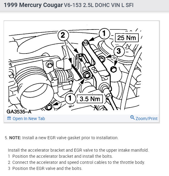

How can I get to back three plugs to replace them?
1999 MERCURY COUGAR
135,000 MILES • 6 CYL • FWD • AUTOMATIC
CHUCKT528
Thanks
Jun 22, 2008 at 4:19 AM
SQM
  • 6,383 POSTS

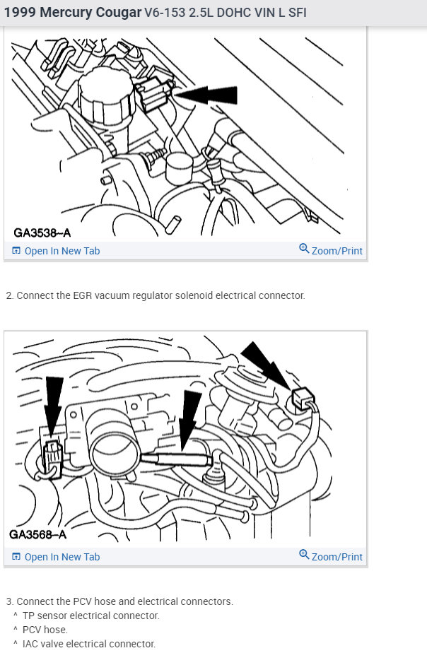

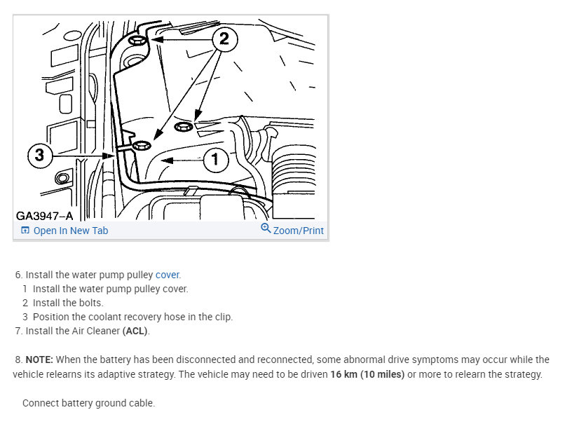

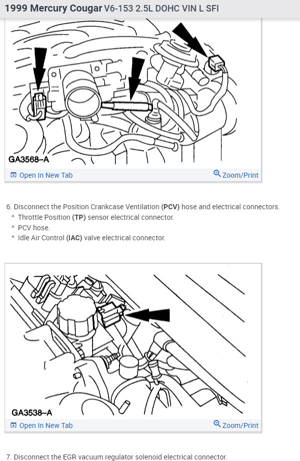

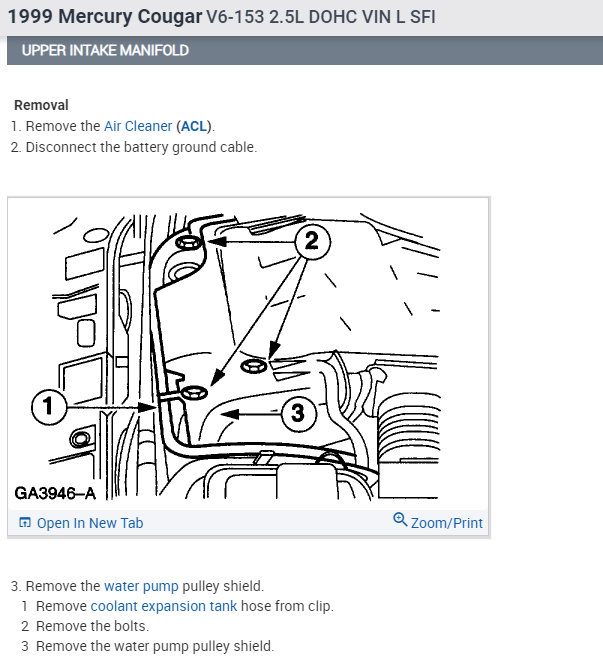

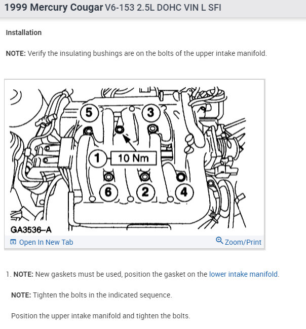

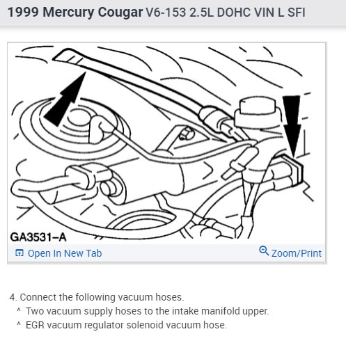

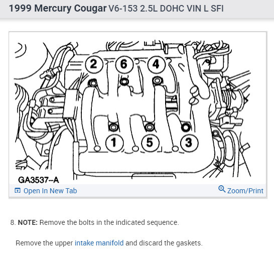

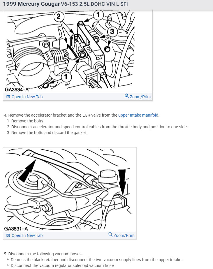

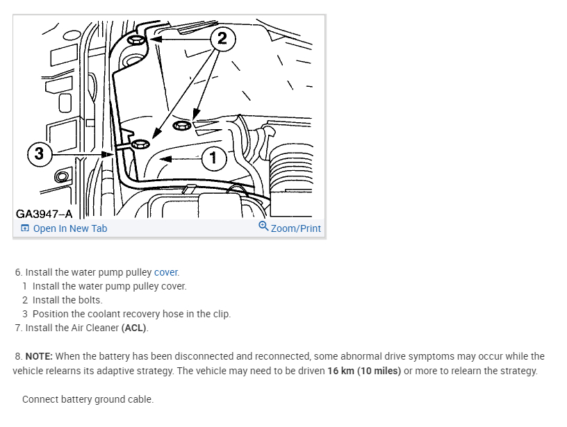

In order to replace those spark plugs, you will have to remove the upper intake manifold.
This will allow access to them.
https://www.2carpros.com/articles/replace-intake-manifold-gasket
I have attached the removal process for the upper intake manifold below.
