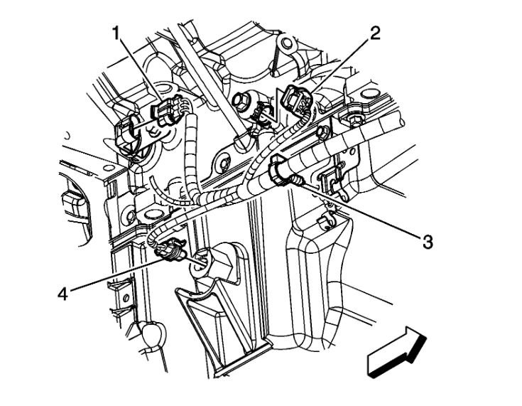

My truck will start and run for about twenty minutes then it shuts off randomly. Then it will not start back up again. I've replaced the fuel pump, relays, cam sensor, and mass air flow sensor. It does not throw codes and I am super confused on what else it could be. It has fuel pressure when running, but is hard to tell when it is going to stop running.

The check engine light came on and we read the code. The code is a crankshaft sensor. Do you think this could be the problem?

  • 52,797 POSTS
What is the code number? There are several codes for the crank sensor.
Yes, it could be the sensor.

  • 52,797 POSTS
Codes rarely identify bad parts just failed systems.
It could be the crank sensor but without the code it is just a guess.
It is located behind the starter motor. I attached a picture for.
Once installed it has to go through a relearn program and that has to be done with a scan tool.
