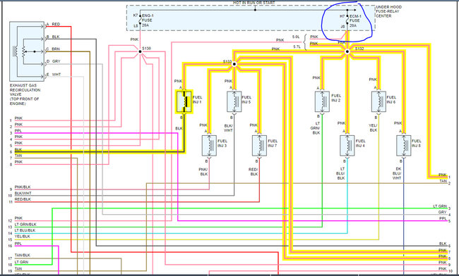

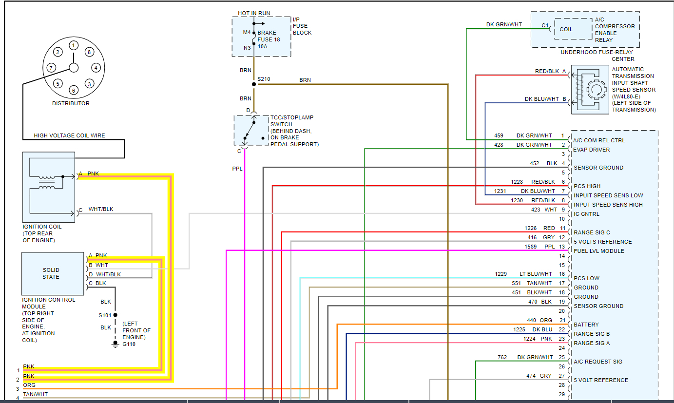

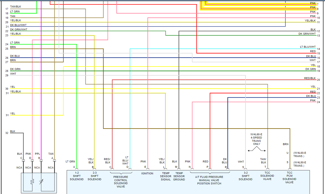

I've changed everything, but I have fire and 62 lbs of fuel pressure but it will not start unless you pore gas in the breather box. I'm ready to bring it unless someone can tell me what the problem is.
Dec 4, 2020 at 1:02 AM
Good afternoon,

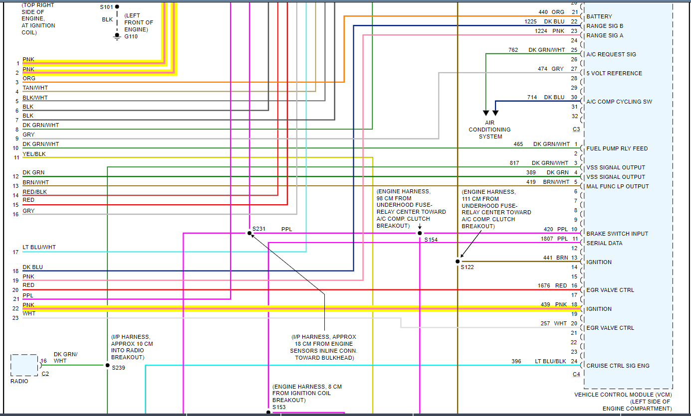

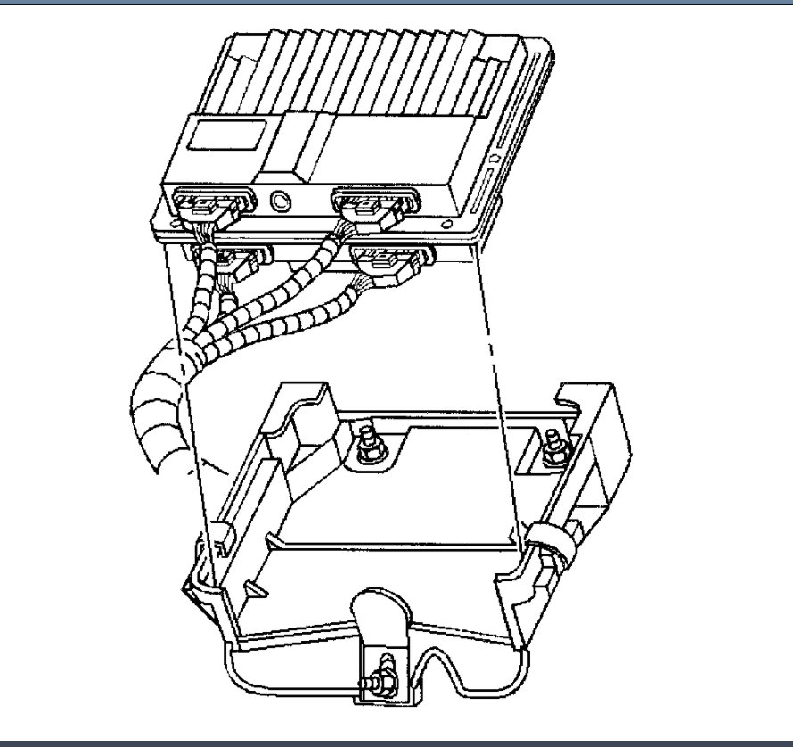

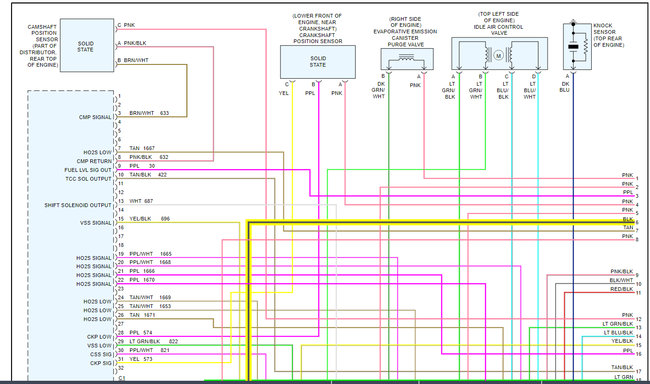

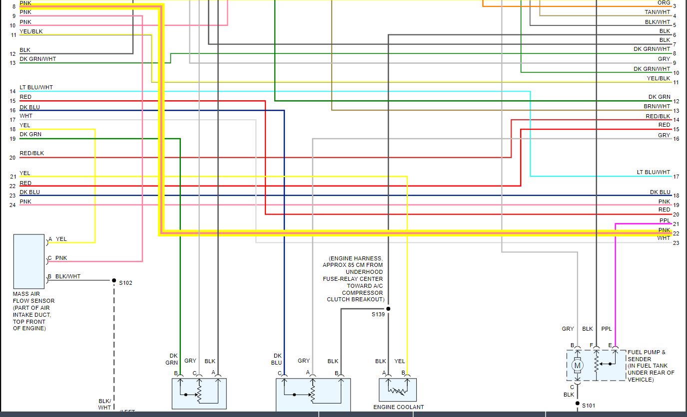

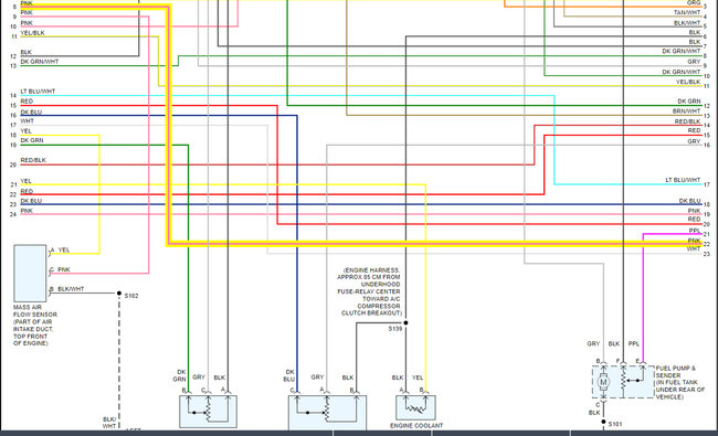

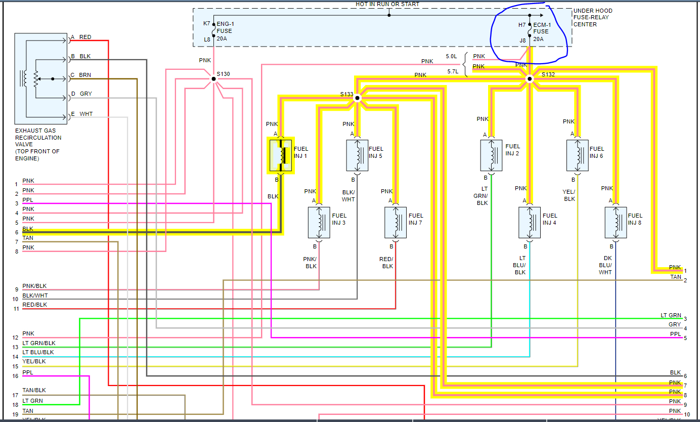

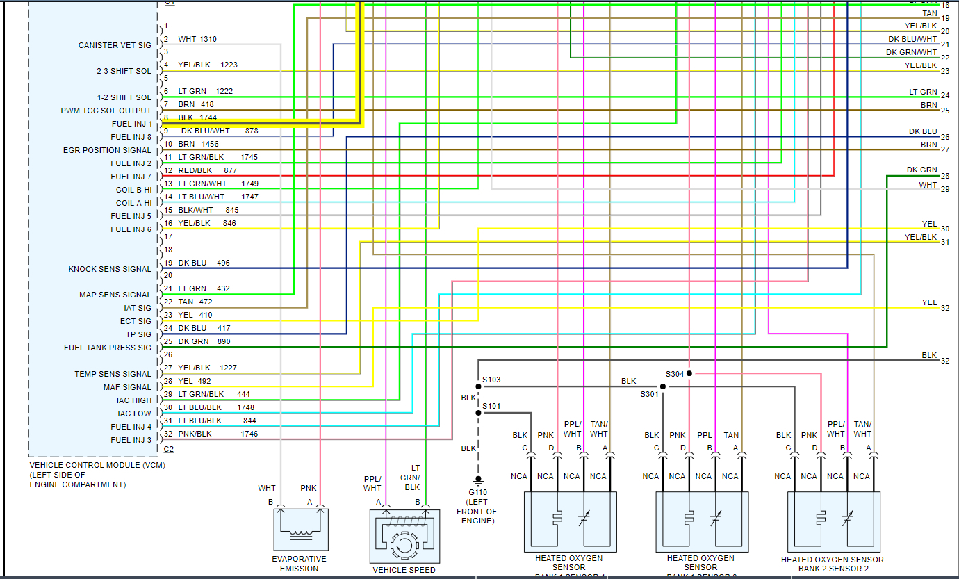

This sounds like the ECM is not commanding the injectors to flow.
You will need a noid light to see if the ECM is grounding the injectors. If it is not, then the ECM is bad.
I attached the location of the ECM for you as well.
