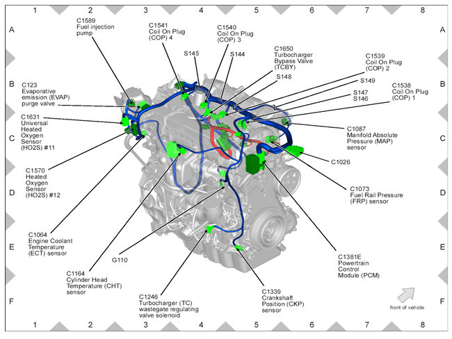

The coolant temperature gauge had been climbing to three quarter and then going back to middle. Sometimes it gets a little bit hotter. I have replaced the thermostat already and it was fine for a week and it is doing it again. I have got a replacement coolant temperature sensor for it but I cannot find the location of the sensor to replace it. Do you know where I can find the location of the coolant temperature sensor?

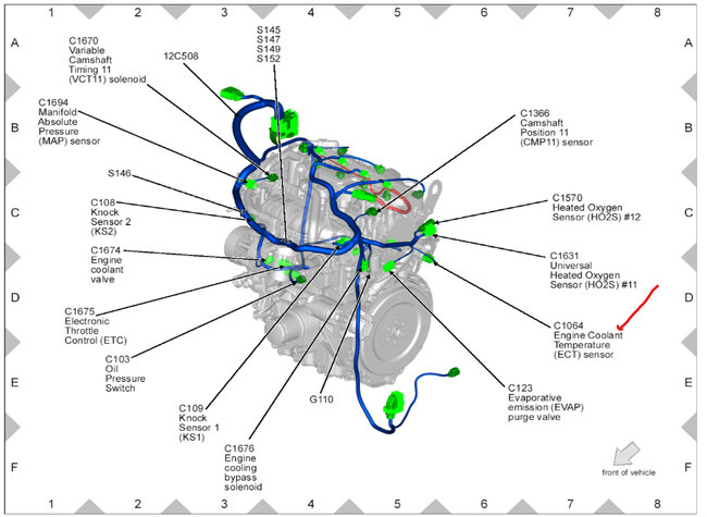

Here is the location of the engine temperature sensor and all the other sensors with a guide to help see whats going on if the sensor does not fix it.
https://www.2carpros.com/articles/engine-overheating-or-running-hot
Check out the diagrams (Below). Please let us know what happens. (ECT is the sensor you are looking for.)

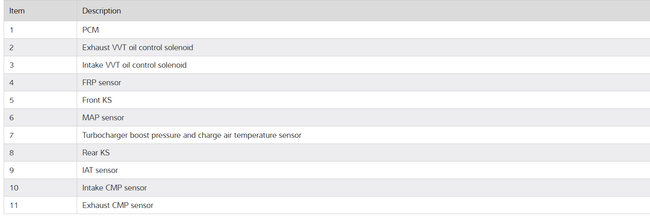

Need to check and or replace sensor to clear false overheating.
Saturday, August 29th, 2020 AT 1:00 PM (Merged)
BMDOUBLE
  • 1,139 POSTS

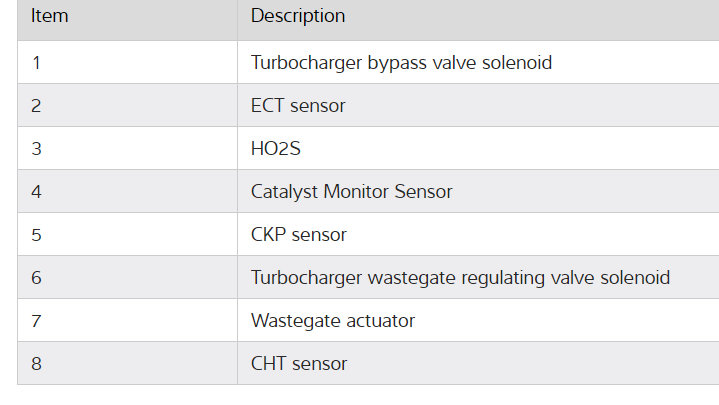

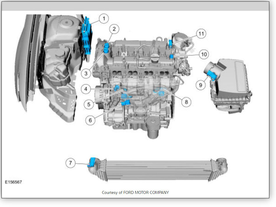

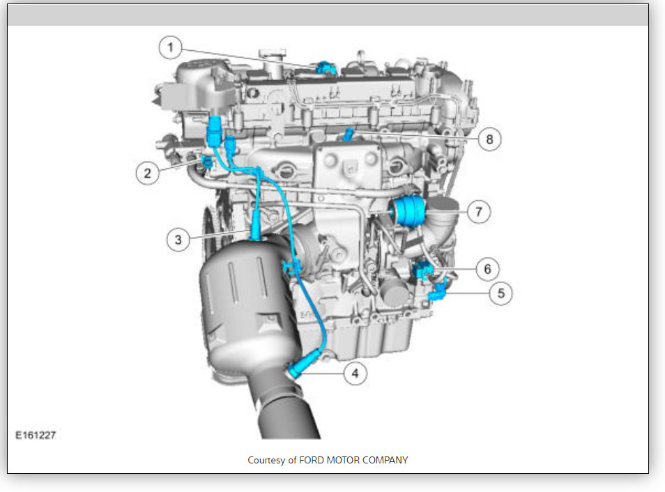

There are two different places it can be depending on the engine which I have supplied both. Check out the images (Below). Please let us know if you need anything else to get the problem fixed.

The 2.5 is not a turbo, so here is a picture of the 2.0 turbo cht location. The 1.6L and 2.0L are turbo models.
+1

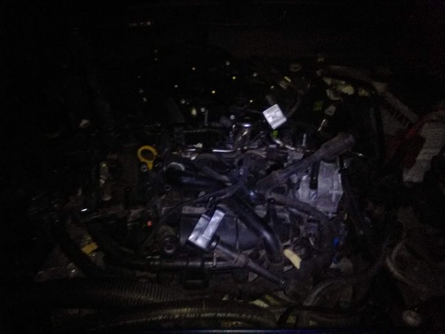

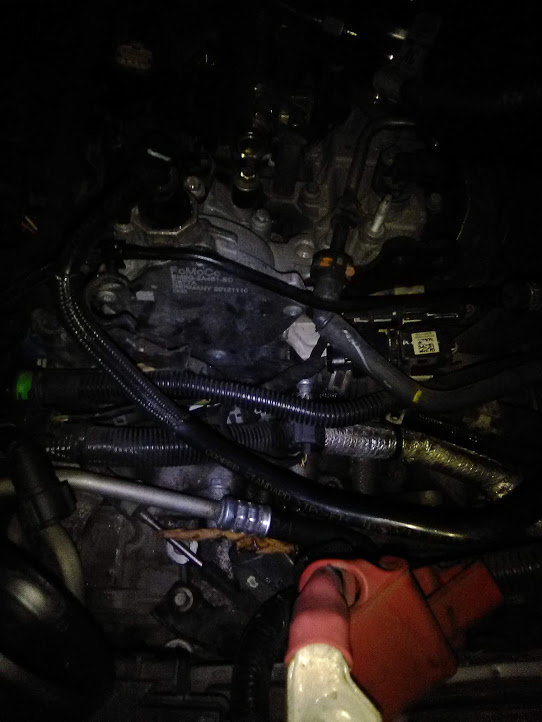

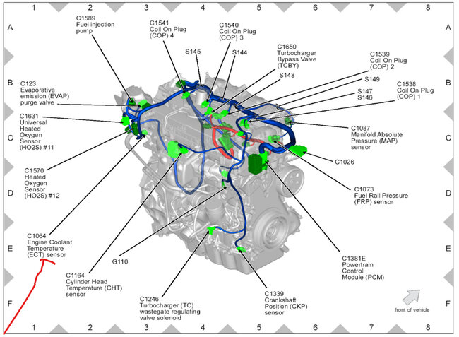

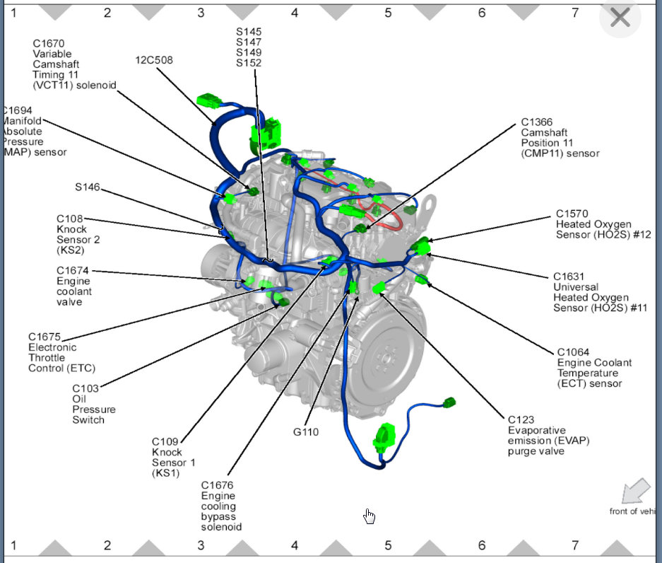

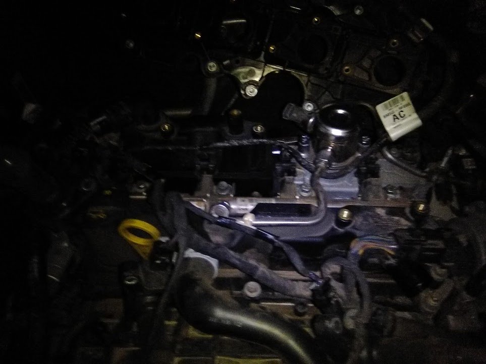

My apologies, I am getting to old for this. The mechanic I had said it was a 2.5 it is the 1.6.I have been working on this for 5 days now waiting from my local contacts to help with no luck. Sorry about the quality but here are some photos I just took.
BMDOUBLE
  • 1,139 POSTS
Okay, no problem, here is the 1.6 location.

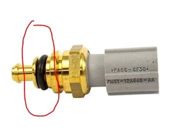

Coolant is leaking into sensor creating a miss. Read have replaced it twice. Was wonder if there is suppose to be a seal in the coolant sensor port?
  • 110,176 POSTS
Is coolant leaking past the threads? If so, there is no seal. Try using Teflon tape on the threads and then properly tighten.

Okay, I found it. It is the one held in with a clip. First, pull the connector off and see if it is wet inside. These commonly go bad an leak through the sensor into the connector and then out. Also, there is an o-ring on the sensor. If it isn't leaking through the sensor, remove the old one, make sure where it goes into the engine is clean, and lubricate the o-ring prior to install. I usually use something like vasoline. If you don't lubricate the o-ring, there is a good chance it will be kicked and leak.
Make sure the sensor is fully pushed in and that the clip is properly seated.
I attached a pic of the sensor and circled the o-ring that I mentioned. However, remember that the o-ring may not be the problem but instead, it is leaking through the sensor, into the electrical connector, and then out.
Let me know if this helps.

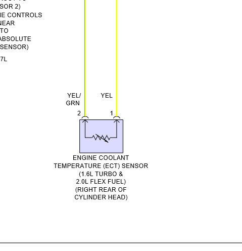

Trying to locate the ECT sensor on my car it is the SE model.

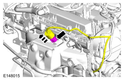

HMAC300
  • 48,601 POSTS
You might not have one and instead you have a cylinder head temperature sensor which does about the same thing. But you do have a ECT which is on right top of cylinder head. See picture.
