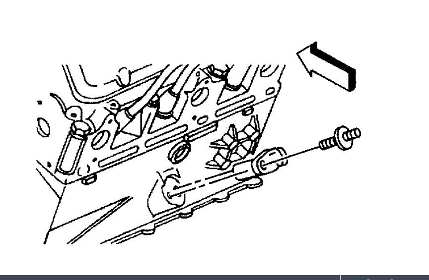

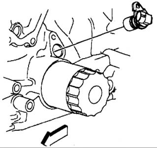

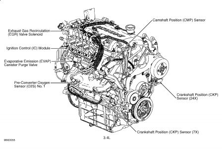

Needing to know where the crankshaft sensor is located at.
Sep 30, 2018 at 3:23 AM
Good afternoon
There are two for this model. I have attached pictures and procedures for both.
Do you have a code for this repair?
This is the one on the back of the motor
REMOVAL PROCEDURE
1. Turn the steering wheel fully to the left.
CAUTION: Refer to Caution in Service Precautions.
2. Raise vehicle on hoist.
3. Disconnect sensor electrical connector.
4. Remove bolt/screw.
5. Remove sensor from engine.
6. Inspect for the following:
6.1. Inspect the sensor for wear, cracks, or leakage. Replace the O-ring if necessary.
6.2. Lubricate the new O-ring with clean engine oil before installing.

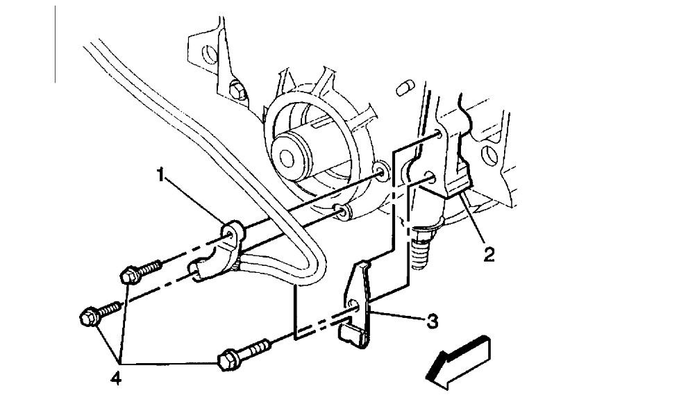

This is the one behind the crankshaft pulley in the front of the motor
REMOVAL PROCEDURE
CAUTION: Refer to Battery Disconnect Caution in Service Precautions.
1. Disconnect the negative battery cable.
2. Remove the serpentine drive belt from crankshaft pulley.
3. Raise the vehicle on hoist.
4. Remove the crankshaft harmonic balancer retaining bolt.
5. Remove the crankshaft harmonic balancer.
6. Note the routing of sensor harness before removal.
7. Remove the harness retaining clip with bolt (1).
8. Remove the sensor electrical connector.
9. Remove the sensor bolts (2).
10. Remove the sensor.
if you replace the one behind the crank pulley, it has to have a relearn procedure done with a scan tool.
The crankshaft position system variation compensating values are stored in the PCM non-volatile memory after a learn procedure has been performed. If the actual crankshaft position system variation is not within the crankshaft position system variation compensating values stored in the PCM, DTC P0300 may set. Refer to Diagnostic Aid for DTC P0300.
The Crankshaft Position System Variation Learn Procedure should be performed if any of the following conditions are true:
^ DTC P1336 is set.
^ The PCM has been replaced.
^ The engine has been replaced.
^ The crankshaft has been replaced.
^ The crankshaft harmonic balancer has been replaced.
^ The crankshaft position sensor has been replaced.
IMPORTANT: The scan tool crankshaft position system variation learn function will be inhibited if engine coolant temperature is less than 70°C (158°F). Allow the engine to warm to at least 70°C (158°F) before attempting the crankshaft position system variation learn procedure.
The scan tool crankshaft position system variation learn function will be inhibited if any powertrain DTCs other than DTC P1336 are set before or during the crankshaft position system variation learn procedure. Diagnose and repair any DTCs if set.
The crankshaft position system variation learn function will be inhibited if the PCM detects a malfunction involving the camshaft position signal circuit, the 3X reference circuit, or the 24X reference circuit.
^ If the scan tool indicates a problem with the Cam signal, refer to DTC P0341 Camshaft Position (CMP) Sensor Performance.
^ If the scan tool indicates a problem with the 3X crank signal, refer to DTC P1374 3X Reference Circuit.
^ If the scan tool indicates a problem with the 24X crank signal, refer to DTC P0336 24X Reference Signal Circuit.
1. Depress and hold the service brake pedal.
2. Block the drive wheels.
3. Ensure the hood is closed.
4. Start the engine and allow engine coolant temperature to reach at least 70°C (158°F).
5. Turn OFF the ignition switch.
6. Select the crankshaft position variation learn procedure from the scan tool special functions list.
7. Follow the instructions displayed on the scan tool. If the procedure is terminated, refer to Important above for instructions.
8. Observe DTC status for DTC P1336.
9. If the scan tool indicates that DTC P1336 ran and passed, the crankshaft position system variation learn procedure is complete. If the scan tool indicates DTC P1336 failed or not run, check for other DTCs. If no DTCs

Your vehicle has 2 crankshaft sensors. The 7x CKP sensor runs to the ignition control module and the 24x CKP sensor leads to the main computer. The 24x CKP is the one with a lead wire so you will have to look over the diagram to point out which sensor you are needing replaced..
https://images.2carpros.com/forum/automotive_pictures/261618_Graphic_20.jpg

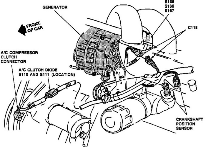

GT HEADACHE
Gt v6 crankshaft sensor on back of the block you can change it by removing the alternator and belt tensioner can't see it but you can feel it use a 10mm tight fit for your arm easiest way I found to do it for access.... used old tire iron between oil pan gap underneath car to work rusted sensor out to a point ...then removed it.

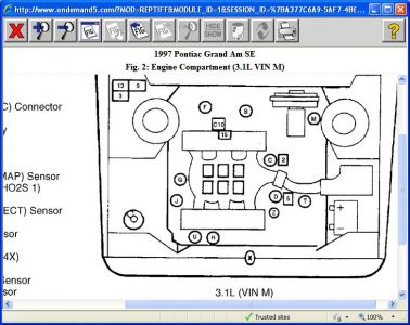

BRANDENTWIST
Electrical problem
1997 Pontiac Grand Am 6 cyl Two Wheel Drive Automatic
I'm trying to locate where the crank shaft position sensor on my 97 grand am v6?
Jul 13, 2020 at 12:31 PM (Merged)
SATURNTECH9
  • 30,869 POSTS
https://images.2carpros.com/forum/automotive_pictures/416332_1997_pontiac_grand_am_crank_postion_sensor_1.jpg
It's letter J in the diagram.

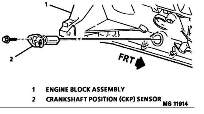

TAISHA24
Electrical problem
1996 Pontiac Grand Am 4 cyl Front Wheel Drive Automatic
Does the quad 4 engine have a crank sensor & where would it be?
Jul 13, 2020 at 12:32 PM (Merged)
WRENCHTECH
  • 20,761 POSTS
It's on the side of the block next to the oil filter.
https://images.2carpros.com/forum/automotive_pictures/561653_Crank_sensor_96_24_1.jpg

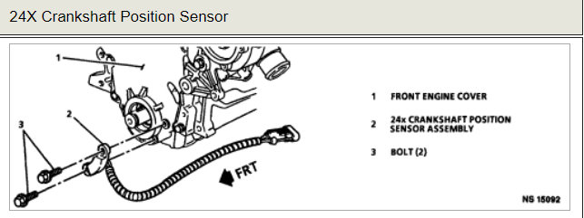

MERLIN2021
  • 17,250 POSTS

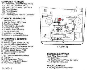

They are two kinds here is a guide to help you see what you are in for when doing the repair.
Here are diagrams for both sensors
