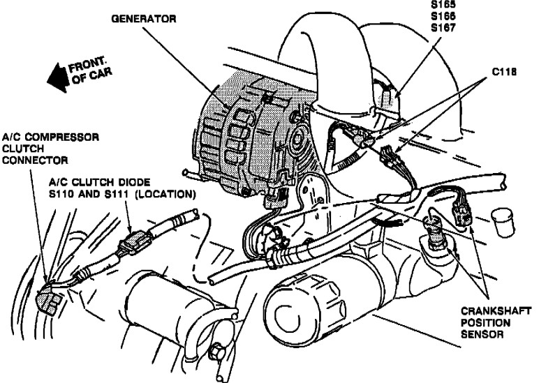

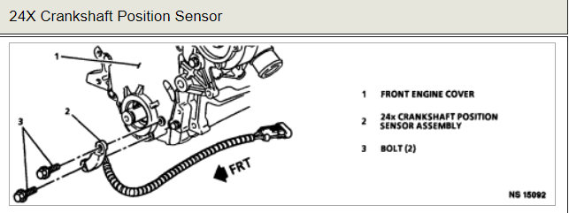

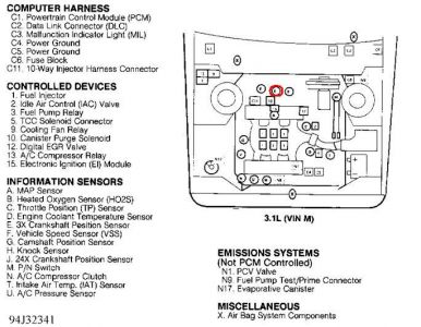

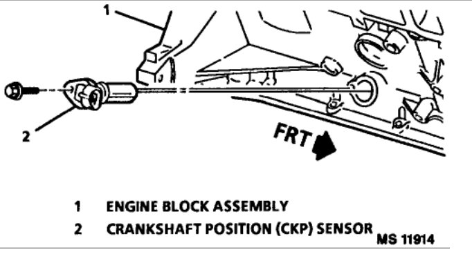

I bought a 93 grand am and put a timing chainin it and it won't start. it has fuel pressure a new crank sensor checked the coils checked the injector new plugs and fuel filter. it shows no engine codes any sugestions?
Jul 13, 2020 at 12:33 PM (Merged)
  • 75,988 POSTS
If both fuel and spark is present-check the valve and ignition timing, this will lead you to problems
with compression and valves opening and closing at the wrong time/broken or jumped timing
belt/chain.
