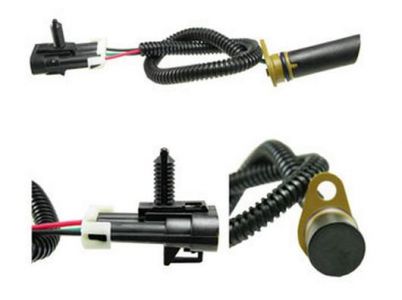

It broke off in the engine block. Can push back down on to the oil pan?
May 10, 2017 at 11:08 AM
HMAC300
  • 48,601 POSTS

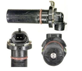

you might try to drill it but I kind of think it will not work. the sensor will hit the crank shaft If you can drill a hole then use a screw to screw into it you may get it out otherwise you will have to pull the pan and use like a screwdriver to push it out. it is magnetic however. Here is what the crank sensor looks like. Check out the diagrams (Below). Please let us know what happens.

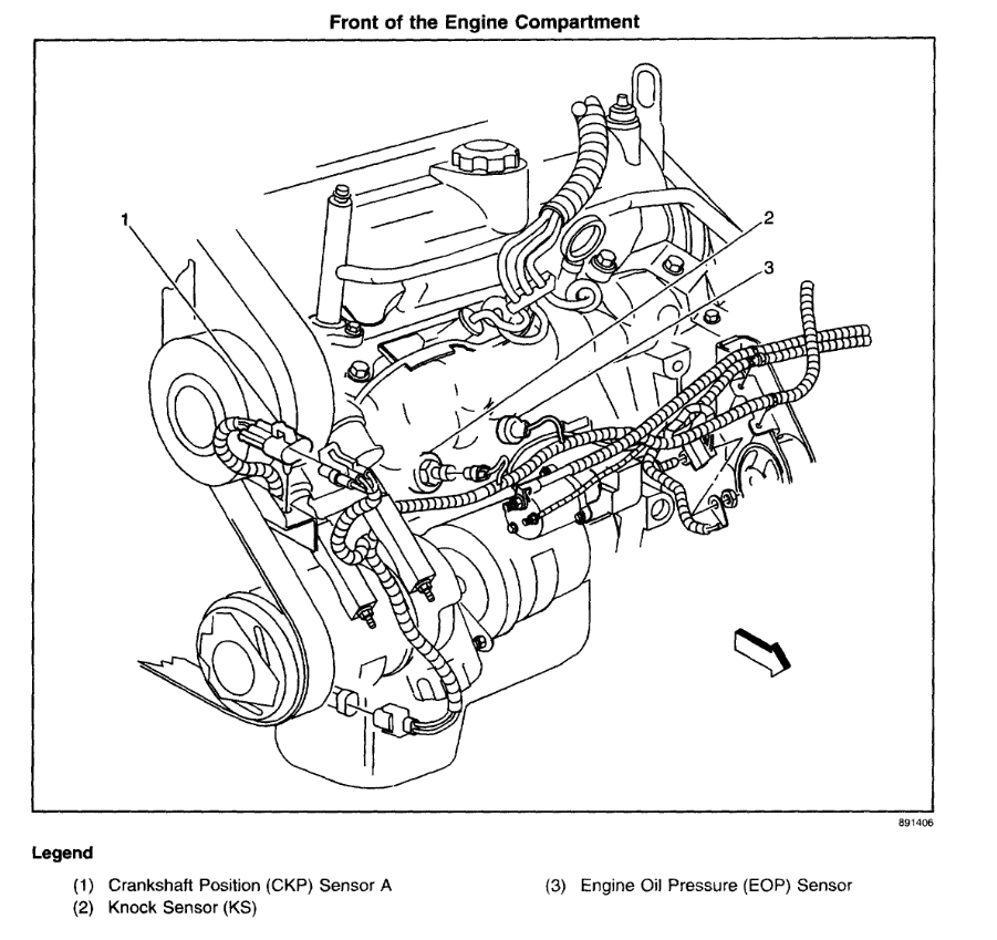

I need to replace it because it's causing my no spark problem and haven't had much luck finding out how to do it. I know how to do the 24x sensor that's under the power steering pump but not the 7x that's at the rear of the engine.
Thanks
Jul 13, 2020 at 12:22 PM (Merged)
  • 55,423 POSTS

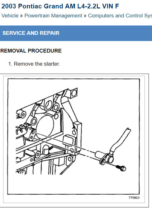

There are two sensors on the V6 engine one on each side of the block the 4 cylinder has just one crankshaft angle sensor. Here is a guide that will give you an idea of what you are in for when doing the job.
You will need to jack the car up to change the sensor
Here it the locations for your car (below)

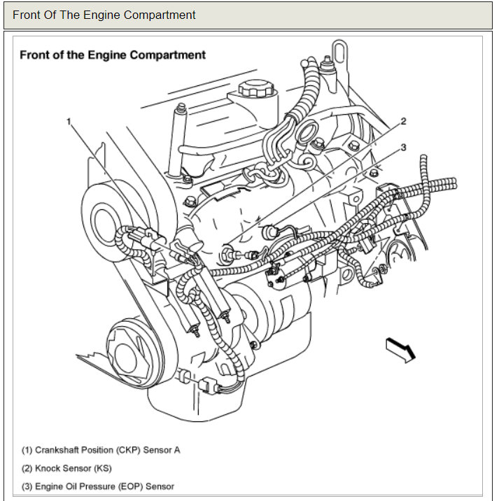

DOCFIXIT
  • 18,828 POSTS
the camshaft sensor is at the rear of the engine. Check out the diagrams (Below). Please let us know if you need anything else to get the problem fixed.

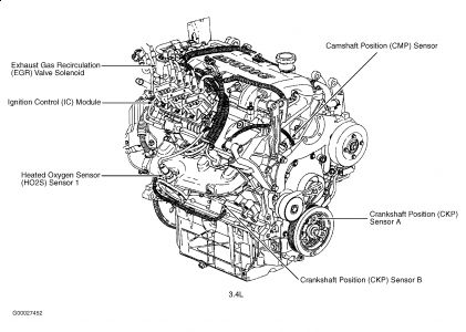

Where is the crank sensor located?
Jul 13, 2020 at 12:25 PM (Merged)

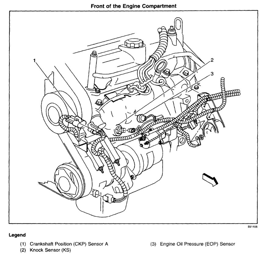

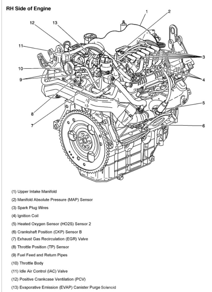

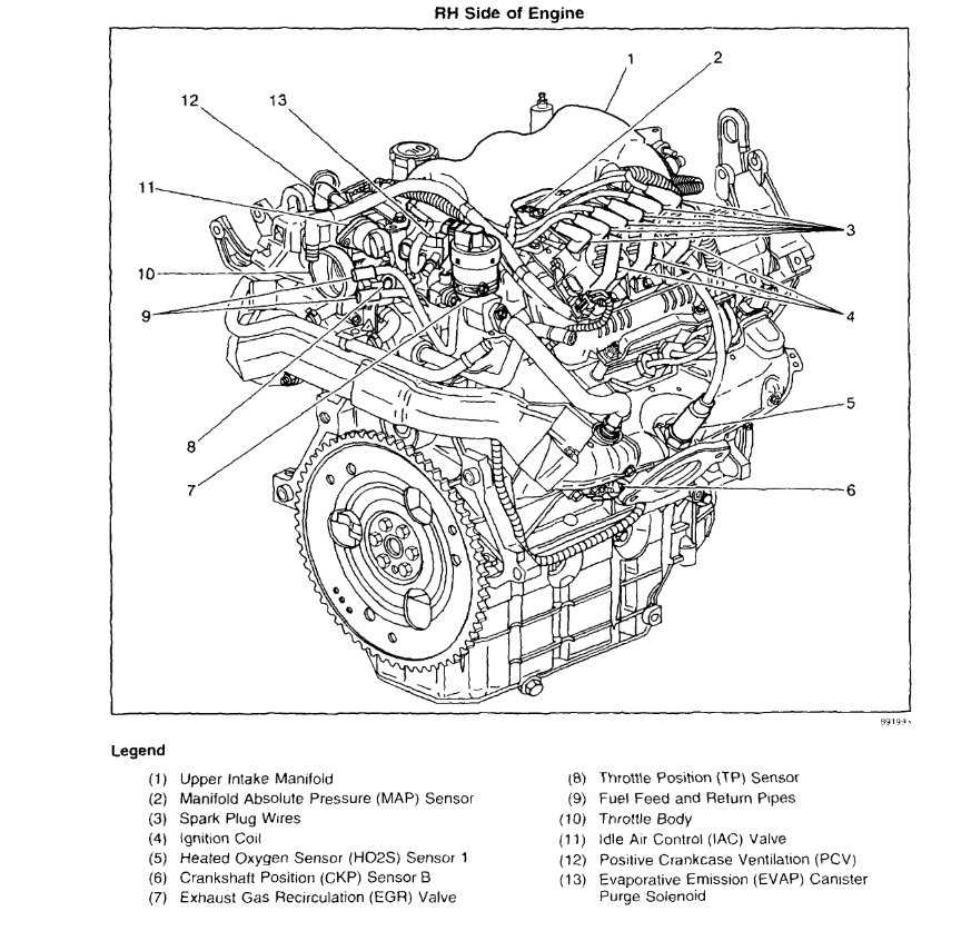

BLUELIGHTNIN6
  • 16,542 POSTS
CKP is located lower left side of engine , near oil filter on the 2.4L engine.
CKP (7X) is located lower right side of engine on the 3.4L and the CKP (24X) is located left front of engine on the 3.4L .
