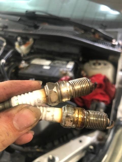

Fuel pump went, got new.
Still no start, now starter sticking and will crank only, got three new relay fuses,
new ignition switch, still crank only,
Took relay fuses out used paper clip it started, put relays back in, crank only.

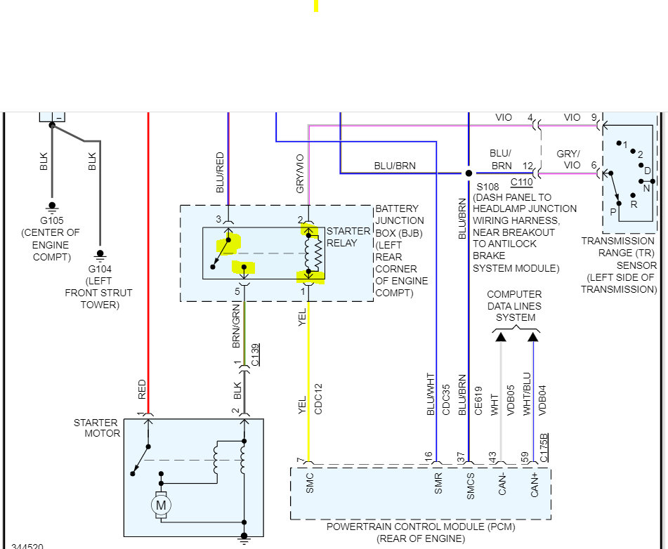

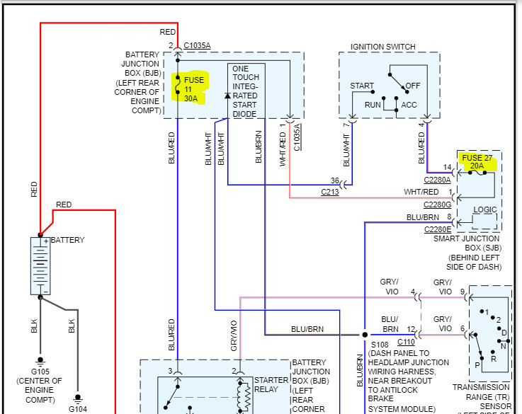

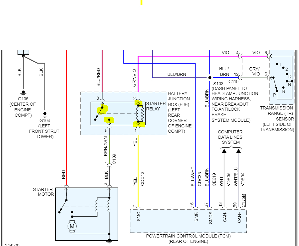

Did you use the paper clip to jump the relay and engage the starter?
Do me a favor and take a look at the wiring schematic below. I need you to check the fuses I highlighted. In addition to checking the fuse, confirm there is power to and from them. Here is a link to help:
Also, you indicated you got three new relay fuses. Do you mean both the relay and fuses were replaced? If not, switch the relay with a different one having the same part number and see if that makes a difference. If there isn't one, here is a link that explains how to test a relay:
One other thought. Try starting it in neutral to see if that makes a difference.
Let me know what you find. Also, when looking at the schematic, let me know which pins were jumped with the paper clip.
See pics below. Note: I had to cut the schematic in half to make it readable. I did overlap the two so you can follow from one to the next.

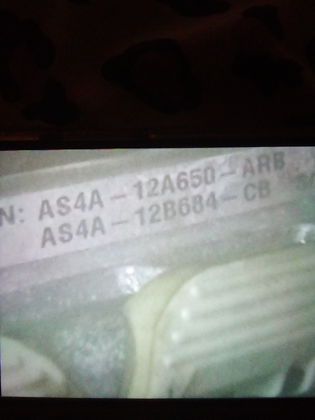

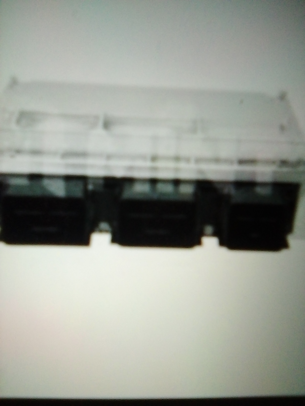

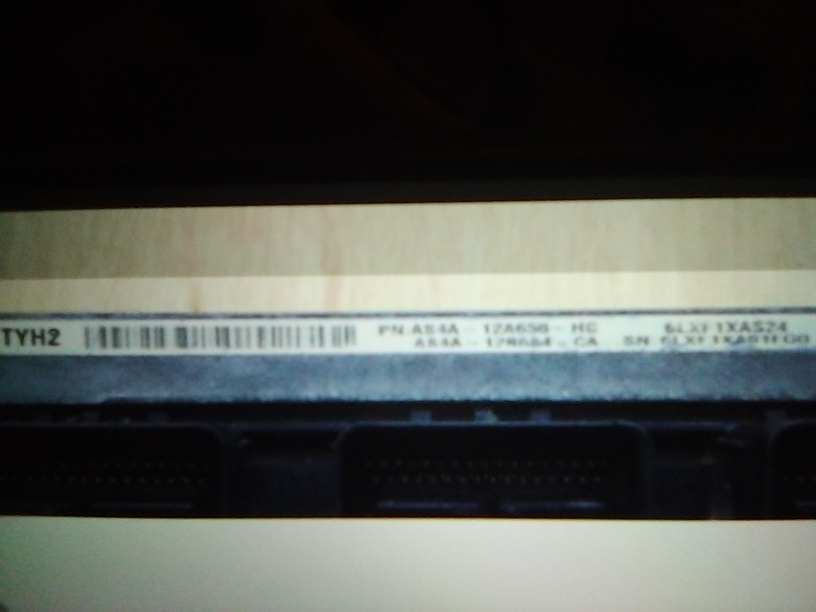

Hi Joe,
Thank you again!
I have 2.0L 4 cylinder.
I got a used ECU.
And the one they sent has hc after number on top line
Mine is ARB after numbers,

The idea that the part number is different is a concern, but I question if that is causing the no-start condition. The new ECU is programmed to recognize the key in the vehicle it came from.
What I would recommend is this. Check online for remanufactured ones that are "plug and play". Basically, they program it for your vehicle and then it just requires installation.

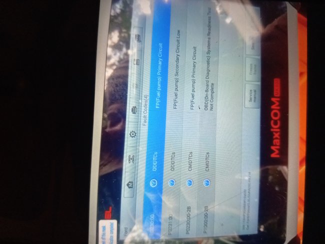

It sounds like he had a scan tool. By chance, did he tell you what codes he found?
Let's try something. Using starting fluid, see if it starts for a couple of seconds and then stalls. If it does, then we know it's a fuel-related issue. If there is no change, it would likely be ignition related. If that is the case, we need to check for ignition spark at the plugs.
Here is a link that explains how that is done:
https://www.2carpros.com/articles/how-to-check-for-ignition-spark
Try this and let me know what happens. Also, let me know if you hear the fuel pump turn on briefly when the key is first turned on.

Oh, no didn't give codes, yes, the fuel pump kicks on.

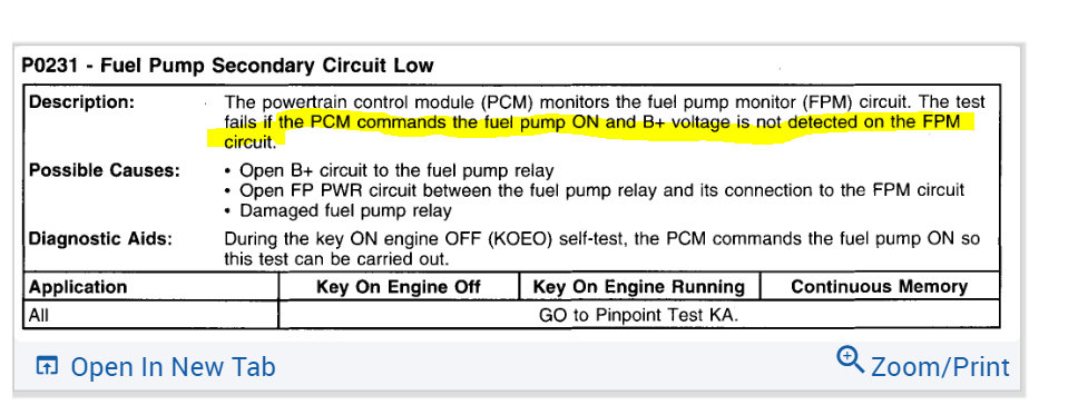

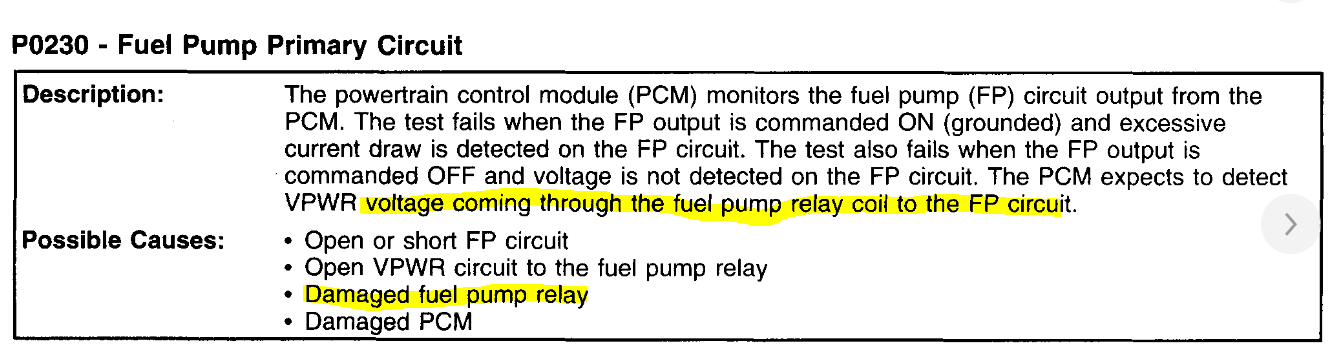

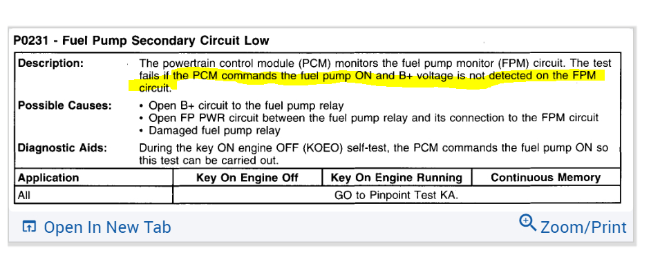

Hi Joe.
Sep 9, 2022 at 1:38 PM
  • 110,248 POSTS

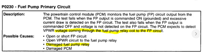

I was unable to read the first code. The next two can be caused by a few things. Are you certain the relay is good and has power to and from it?
Take a look at the two pics below. They are the definitions of the codes. Based on what I see, we are not getting power via the relay.
Let me know your thoughts.

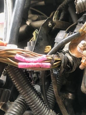

SBRACKENS
  • 26 POSTS

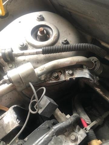

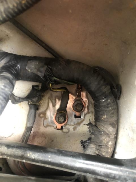

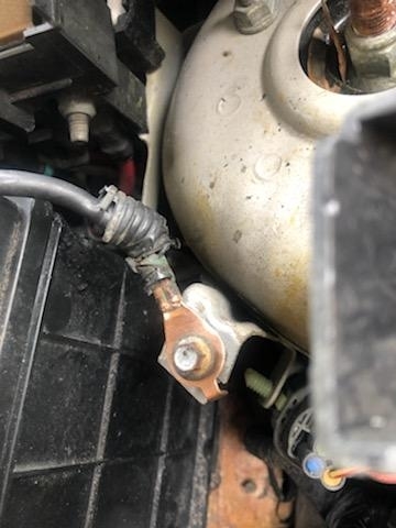

Hi Joe,
Finally!!
This is the mechanics text to me!
I'm so grateful to all that helped with this!!
We found out the problem. There was a short in the wiring harness to the computer hence the reason why we had no power to the fuel injectors, fuel pump, fuel inertia switch or fuel relay. The opening in the wire harness was caused by corrosion. After completing everything the total came out to $313.90.

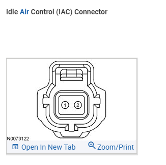

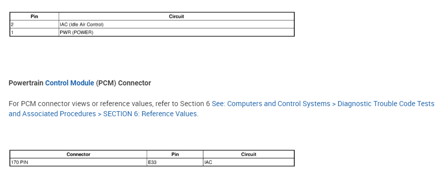

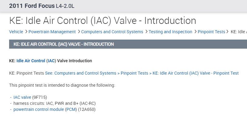

  • 110,248 POSTS
Hurricane? Heck no. LOL I'm just far enough west that at most, we get rain.
As far as the steering, it sounds like you are losing power assist when the engine RPMs drop.
If it is stalling when stopping or a light acceleration, the first thing I would be looking for is an engine vacuum leak.
Here is a link that explains how it's done:
If you find no leaks, then suspect there is an issue with the idle air control valve. On most vehicles, the IAC can be serviced or replaced. On this vehicle, neither servicing nor replacement is possible. The throttle body will need to be replaced.
Let me know. Also, I attached diagnostics below for testing the IAC circuit. Let me know if you are comfortable performing them.
