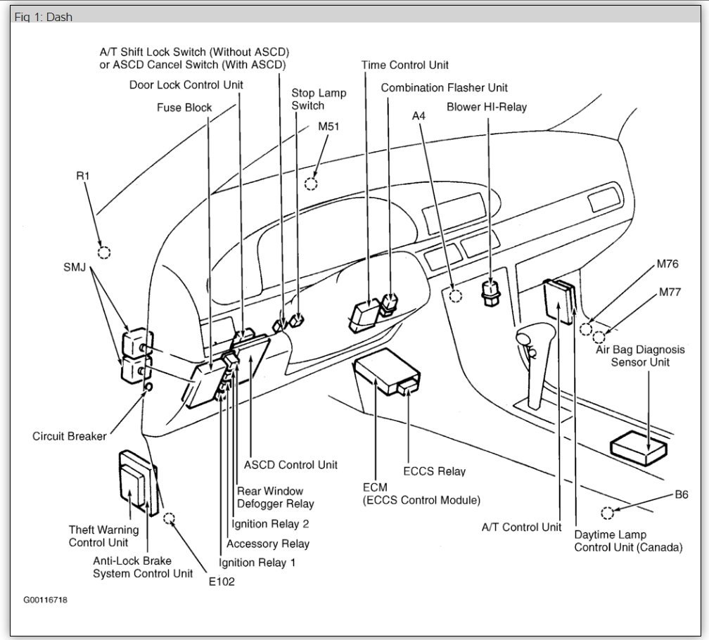

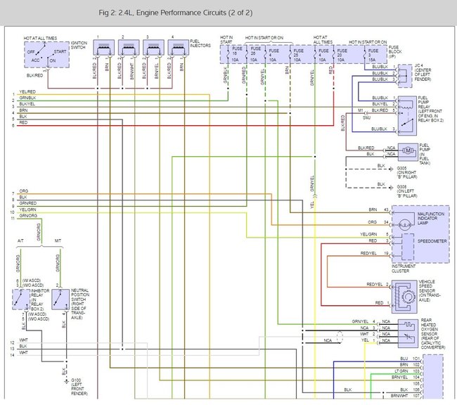

Engine will not fire. It ran perfect the day before. Went out the next day and all it did was crank. I have already replaced the distributor, plugs, wires, rotor cap and cover, crank sensor, mass airflow sensor, egr, knock sensor. It's getting fuel but won't fire. If it's completely cold I can get it to stuffer just briefly but after that I get nothing. Changing the position of the gas pedal does nothing as well. I am stumped because I didn't have so much as a backfire from it the day before it stopped starting and it always fired right up without hardly making a full rotation. Am I maybe missing some sort of sensor on the clutch? I did recently get it replaced.

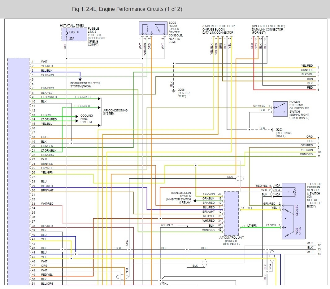

Hello BENJAMIN,

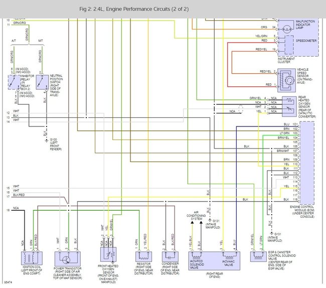

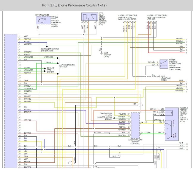

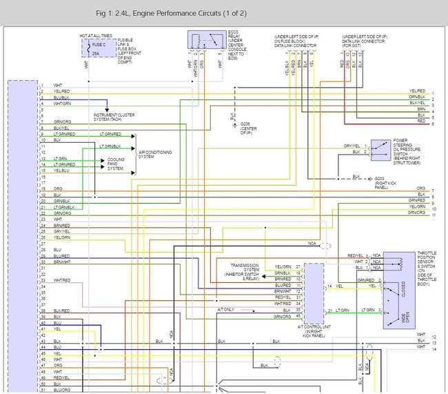

It sounds like you have an ECCS relay that has gone out, here is a wiring diagram so you can find it and a guide to test it.
Please run this test and get back to us so we can continue helping you.

BENJAMIN MENDELL
  • 13 POSTS
I have searched diagram after diagram and have been unable to locate this relay on my car. It all says it's suppose to be behind the center console. I have my whole car torn apart and there is nothing behind the console except for the air diverted box. There isn't even any wiring in the area except for the stereo

KEN L
  • MASTER CERTIFIED MECHANIC
  • 50,321 POSTS
I found the location for you its near the ECCS module
Please let me know if you need anything else to get the problem fixed.

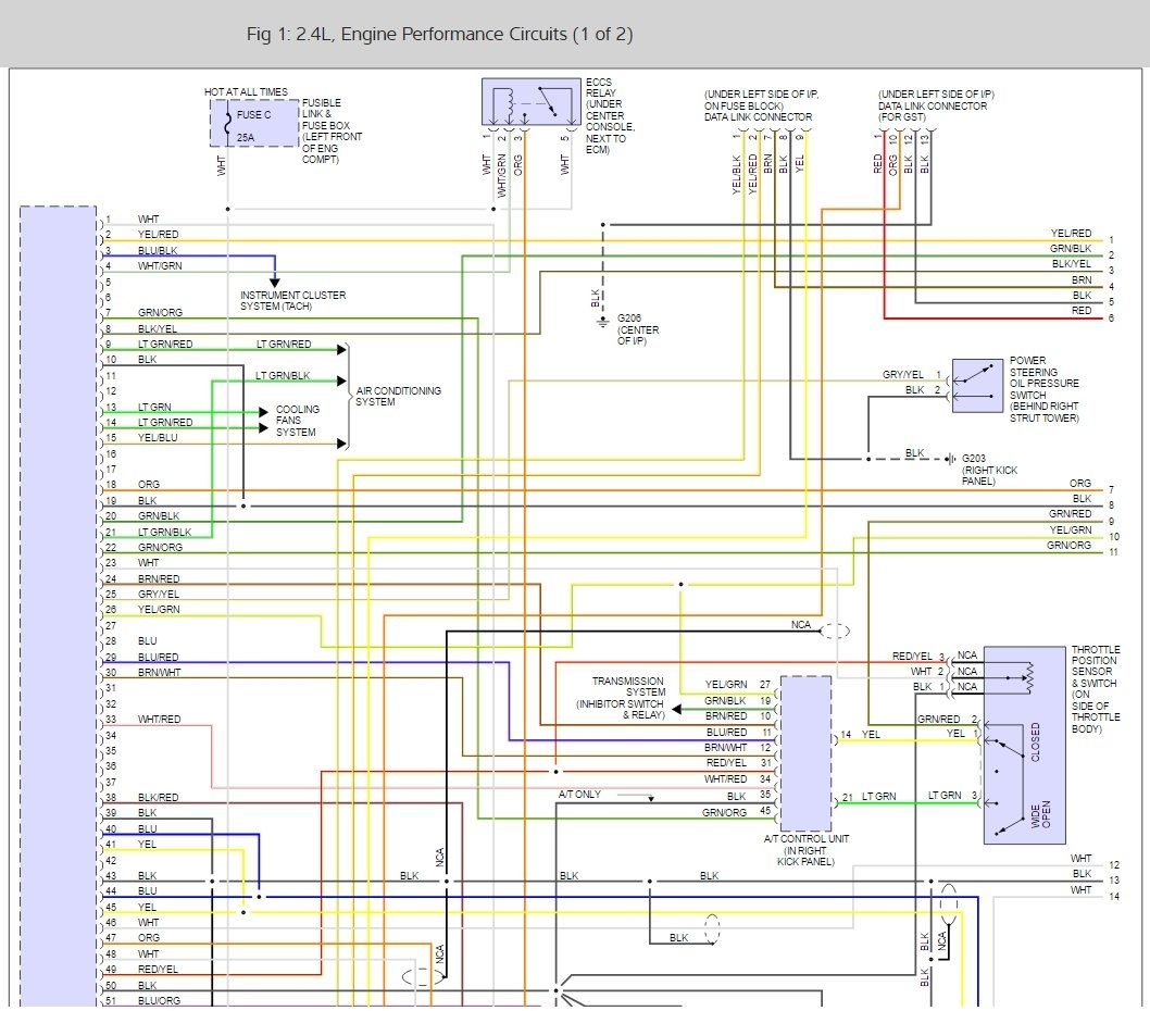

BENJAMIN MENDELL
  • 13 POSTS
This is the same image I've already studied. It not in that location. Unless I have to pull all the air duct out to get to it because it's definitely not within eye sight.

KEN L
  • 50,321 POSTS
Yep sometimes the relay is not where they say it is for some reason or you will need to dig deeper. Try to use the wiring colors is the diagram to make sure it is the correct relay once you find it.

BENJAMIN MENDELL
  • 13 POSTS
Finally had the weather to look again. Found that relay tucked away. Odered another one so ill soon find out if it was the issue. I didnt have any continuety between 3 and 5, thats the open and closed side of it.

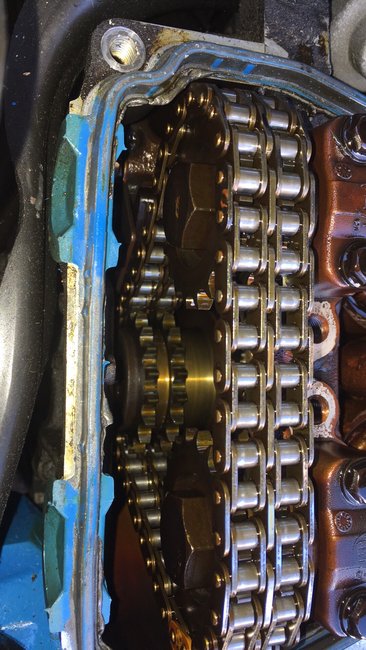

Ok I have a double timing chain on this car. And I might not be a proffesional but I'm not sure that the chances of two sets of teeth jumping is very high.

BENJAMIN MENDELL
  • 13 POSTS
And it all looks tight up here

It would be the lower chain that had a problem, a compression test would let us know if we were on the right track.

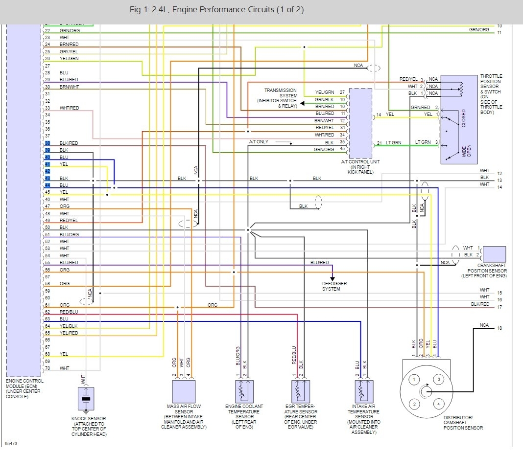

BENJAMIN MENDELL
  • 13 POSTS

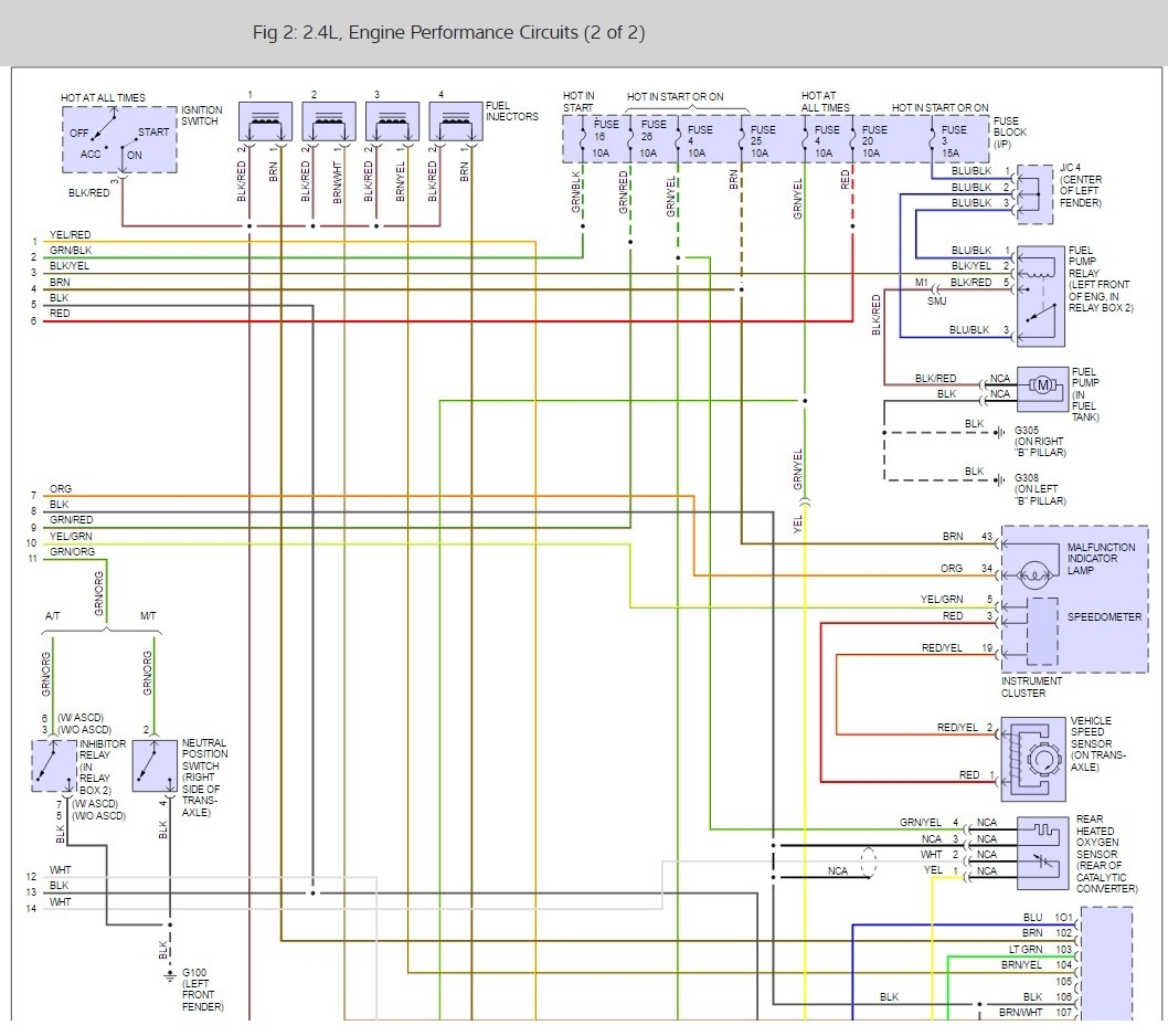

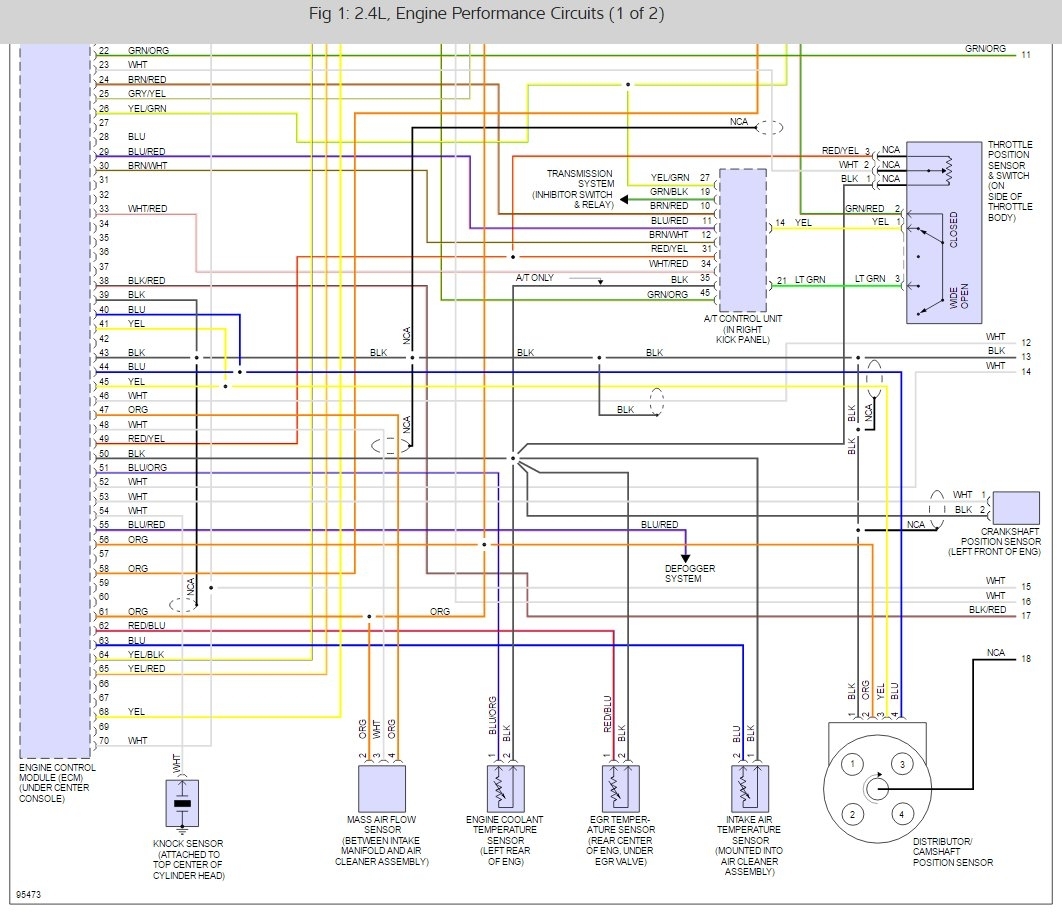

Well I did some more diagnosing and ran some more tests and it turns out my injectors arent getting any power. There isnt any fuse or relay for them so im pretty certain the computer finally went belly up.
Sunday, April 25th, 2021 AT 2:17 PM
KEN L
  • 50,321 POSTS
That does happen, here is a wiring diagram so you can check for power and grounds to make sure. Check the ignition switch power outputs as well and the fuses.
Does the ignition have spark?

Yeah I'm getting spark from all 4 plugs.

KEN L
  • 50,321 POSTS
That means the computer is getting signal. Try unplugging the injectors one at a time to see if you can get the engine to fire up. If one injector is shorted it will stop the others from working.'

Still didnt start from unplugging on injector at a time. It might just be the timing because when the engine is turning it just doesnt sound smooth. Its sounds like its uneven
