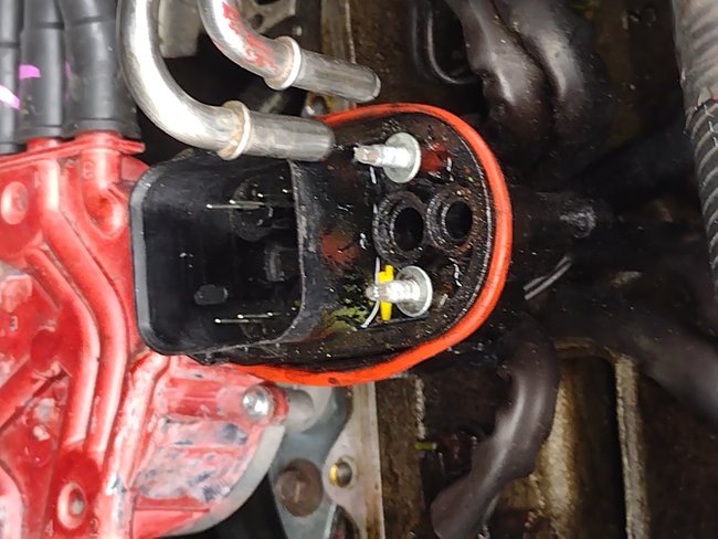

I already put it in a new throttle body and cleaned and polished it before I did. I checked this out I had to take off the plenum because the MAP sensor tip broke off and fell in. Look what I found in the pic attached.

That's the Fuel injection metering unit, correct? Were those lines already pulled out? And what's that yellow thing? Looks like a mess. I see liquid in the injector control pins too, I'm glad you did that, I was super worried about that unit, they fail so much.

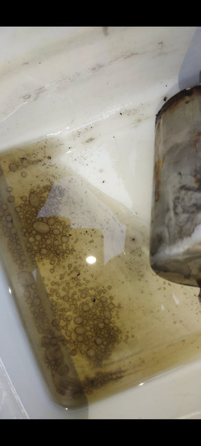

No, I pulled them out. Had to remove the upper intake. Because tip. Of map broke off and fell in. The other thing is paint chips I cleaned up I cleaned everything up really well inside but look at the orange gasket I think that was causing a vacuum leak. Finally replacing the fuel filter with the new one I could easily blow through but the old one hurt my cheeks trying. I think there was either bacteria living in the fuel or there was water in the gas I'm attaching a pic. It's running a lot better starts up runs fine but stalls under load.

Yeah, that looks like water or alcohol. So now we're down to stalling under a load. You replaced the MAF correct? My next thought would be to monitor fuel pressure during the stalling condition, because if the fuel filter was that bad, that fuel pump was definitely being overworked trying to push fuel through that filter. Thats probably also why your initial pulse width was so high, the bad rear oxygen sensor plus a clogged-up fuel filter, the engine was starved for fuel. Also suspect a pump on its way out when you find a filter that bad. And when I do a fuel pump, I do the fuel pump relay too. Since fuel pumps can draw 5 to 9 amps of current. I do both just to cover my bases.
And with that gas you have there, if you put it in a graduated cylinder, or a tube where you can see the liquid, the gas and alcohol will separate, one will float on top of the other. And you can tell by that the percentage of how much alcohol or if its water, is mixed in with the gas in the tank. But it looks like alcohol to me.
I know this isn't a flex fuel vehicle, but there seems to be a certain amount of alcohol in all gas now.
But see if the fuel pressure is dropping off under a load. And what are the Fuel Trims doing during that stall too? If its fuel related, you could graph the oxygen sensors and watch them go lean when the stall occurs. So low voltage signal, like what that rear sensor was at.

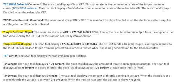

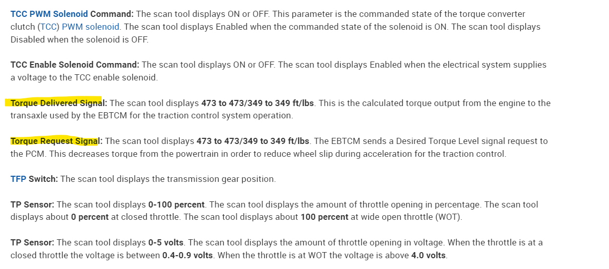

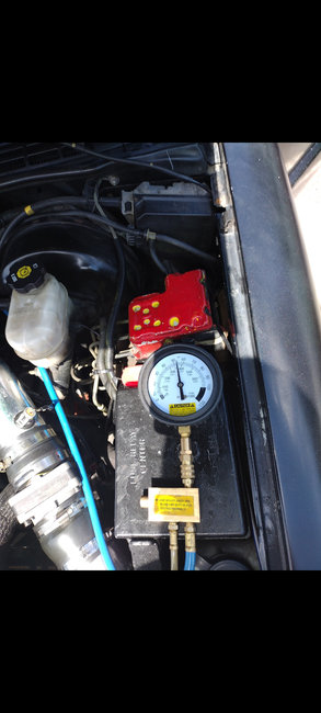

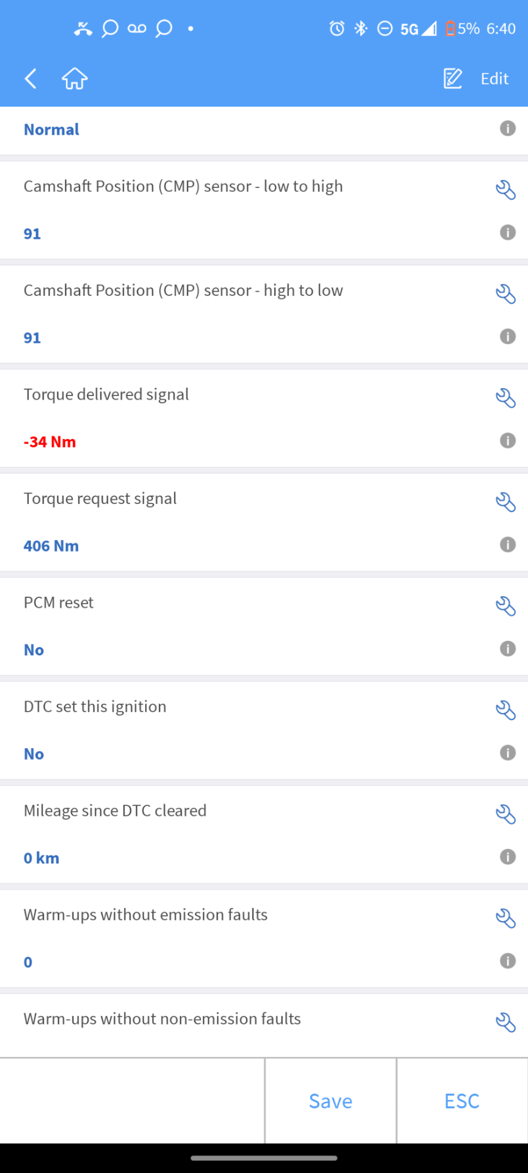

Yes, I replaced the MAF. I finally had access to the pressure test yesterday. It was reading 60 at a cold start. But after running a good while it dropped to around 53. Not sure how good a tester it was. Also, found torque delivered signal was off. Included two pictures.
Sunday, July 31st, 2022 AT 3:25 PM
AL514
  • 4,795 POSTS

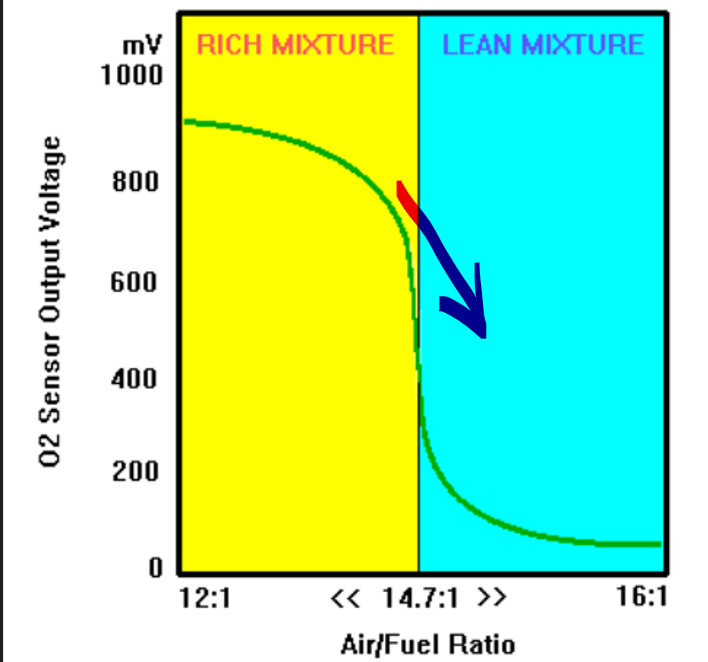

You should graph all 3 Oxygen sensors and go for a ride, if you can record the screen capture while driving so you can look at it when you get back but see if the oxygen sensors go lean when you have the load issue. These are just regular narrow band oxygen sensors, so they will read 0 to 1 volt. I think you'll find that when the load drops out occurs the oxygen sensor voltage will go very low, when graphed they will look like the first diagram below. That will tell you if it's a lack of fuel volume causing the load problem. You can have a good pressure reading but if there isn't enough fuel volume to back it up you will have a problem like that. It may also be the cause of the torque request signal. Why it's extremely low. Because that's basically no torque output at all. It's the TCM communicating with the PCM but getting nothing. I'm really surprised there are no codes. Are you in Global OBD2 or are you under the manufacturers side on your scan tool? And can you get to Mode 6 Data?

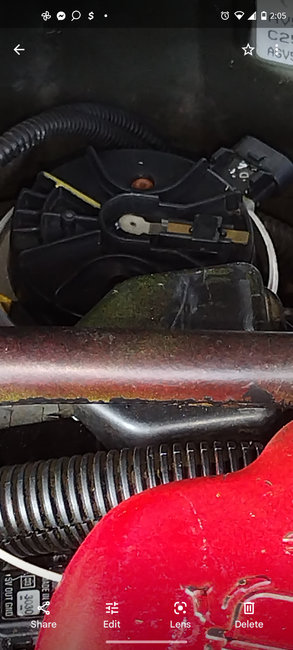

Got her running like a top. I think we had a multi fail scenario. Couldn't have done it without you I appreciate your help so much. The final nail in the coffin that I found when I popped off the distributor cap I don't know if you can see the pin hole in the tab. It wasn't there originally if it was it was very small because I took it all apart and cleaned it and didn't see it till this time pulling it apart.

Yup, I can see that, this truck has many failures, I'm sure the Ignition system was highly over worked considering how many things were going wrong with it. I think the Cat was actually the biggest deal, It was probably one of the major issues from the start, we just didn't know it at first. How are the Fuel Trim numbers looking? Ill bet the engine is breathing much better with the Cat gutted out. It's difficult sometimes because the Converters go bad slowly in most situations and it slowly reduces power over time, but that pulse width at the beginning is something I've never seen before, I didn't even think an ECM would open and Injector so far with setting a ton of codes. Kind of like the Fords, they take forever to set a cylinder misfire code and even then, there are 2 or 3 different levels of misfires. Anyway glad you're up and running again. Have a nice evening.
