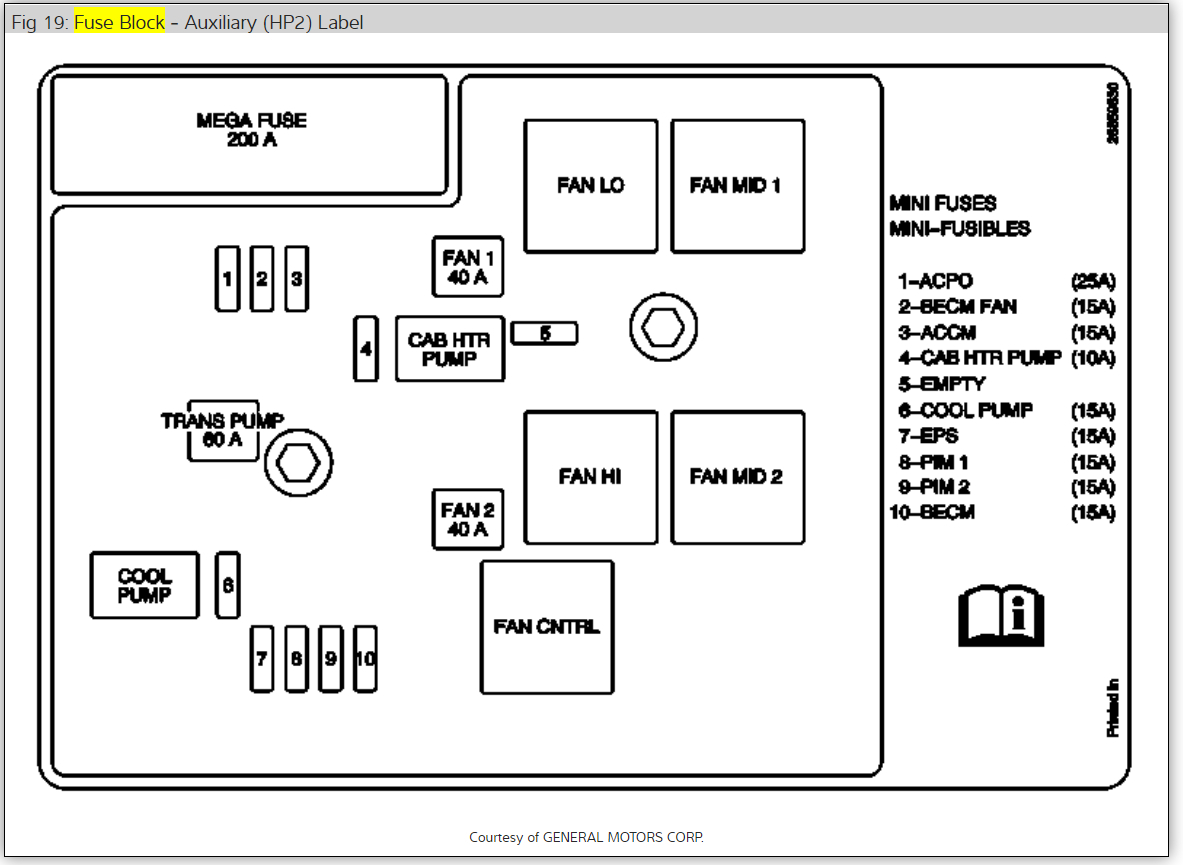

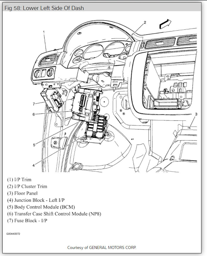

First, we should check the fuses, and then can you turn the truck on without cranking the engine over? Can you hear the fuel pump run inside the tank for about 5 seconds? If not, can you try switching tanks? I have seen one with two tanks. Is it aftermarket?
This guide can help as well to see if there are any codes:

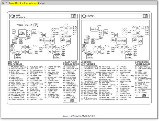

This can help check the fuses with the locations in the diagrams below:

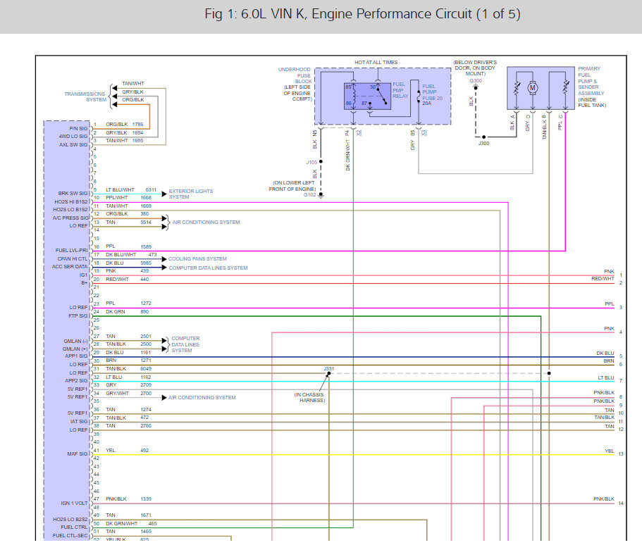

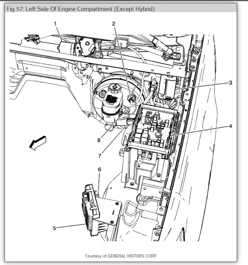

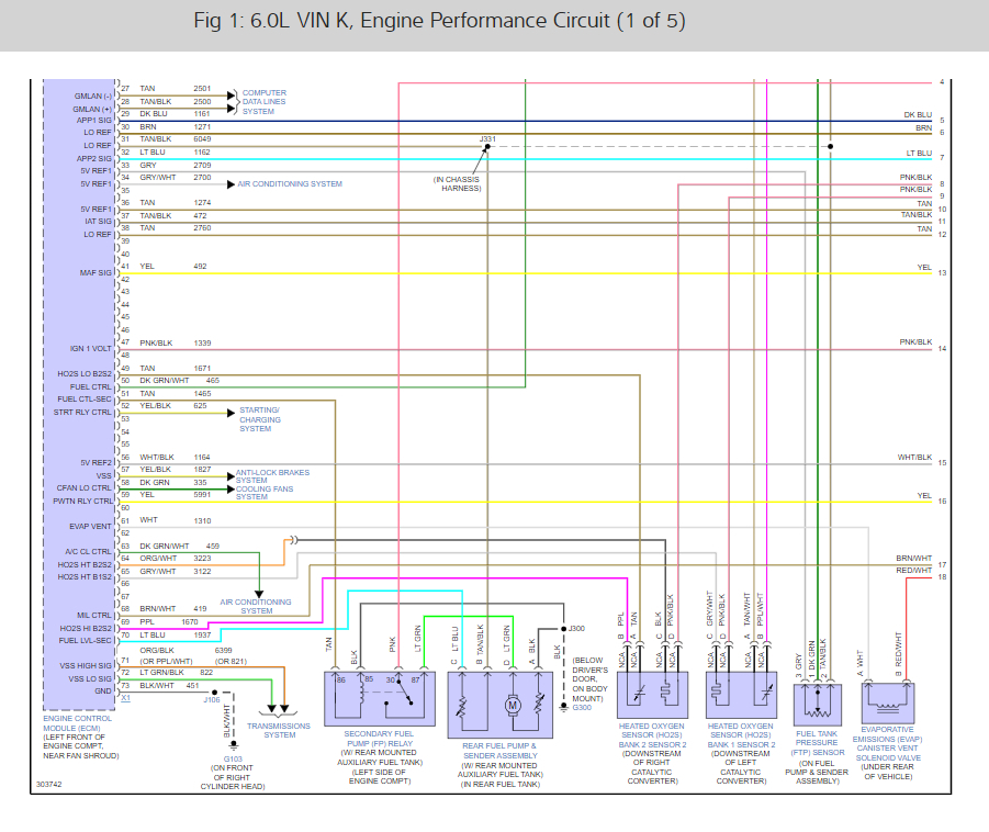

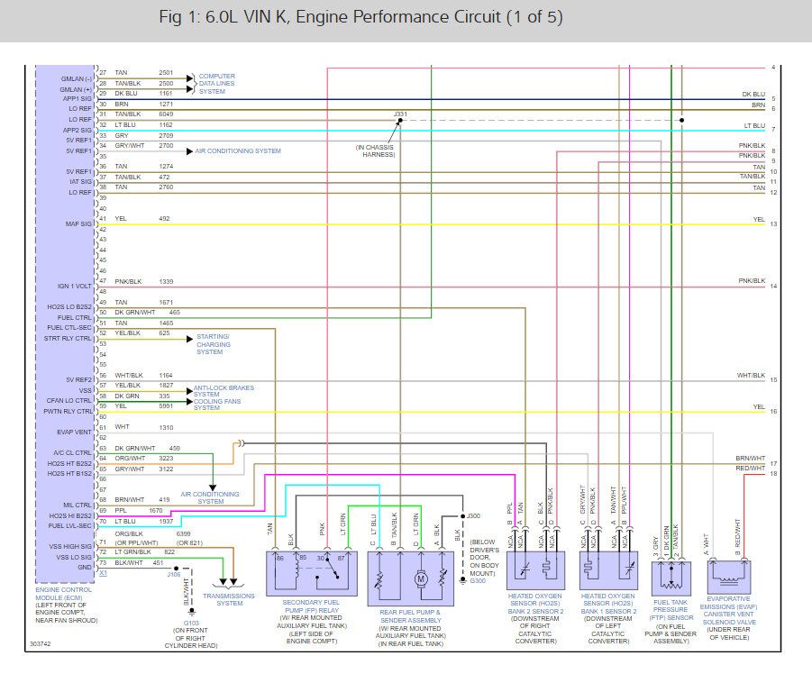

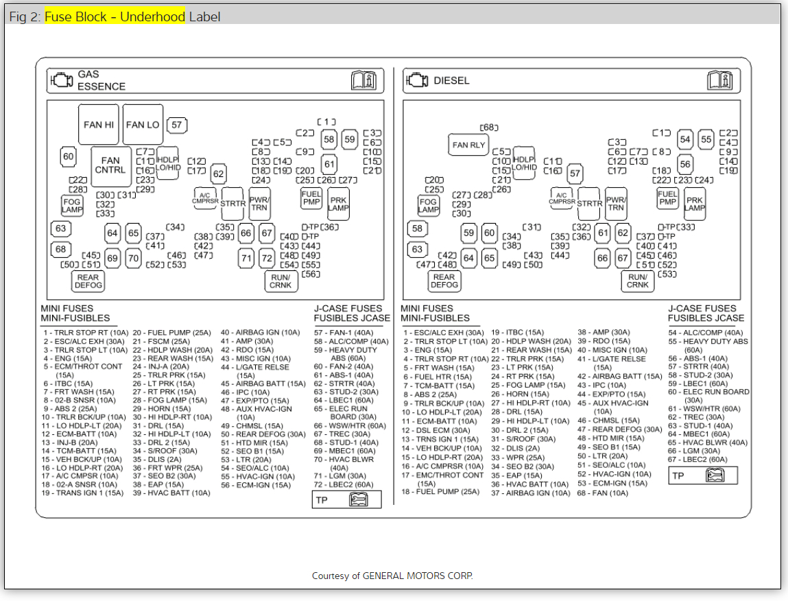

I would try starting fluid in the intake tube to see if it runs to help narrow down the system what is not working. It does sound like the fuel pump is out and if so, here is how to replace it. It looks like both pumps run all the time; do you gas in both tanks? I found the wiring diagrams for the cab and chassis. So, I believe if one of the pumps stops the engine will stop running due to lack of fuel pressure. There is a fuse with two relays as well that run the pumps so we can start by checking those. Please check the fuel pump fuse #20 in the under-hood fuse panel. Here is a guide and you can swap out the fuel pump control relays one at a time as well:
The primary relay is in the main fuse panel under the hood as well while the auxiliary pump relay is on the left side of the engine compartment. Check the wiring diagrams below to see how the system works. Please get back to me.
