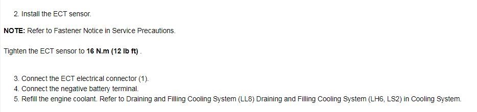

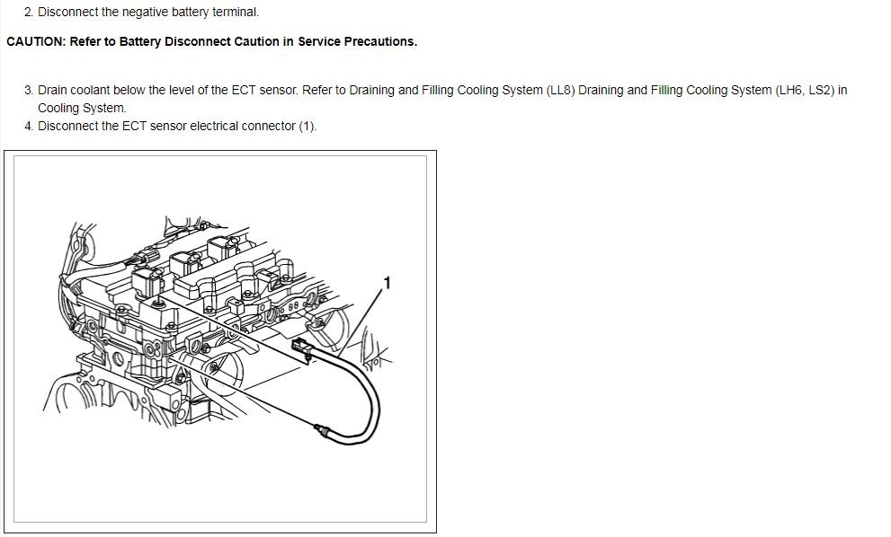

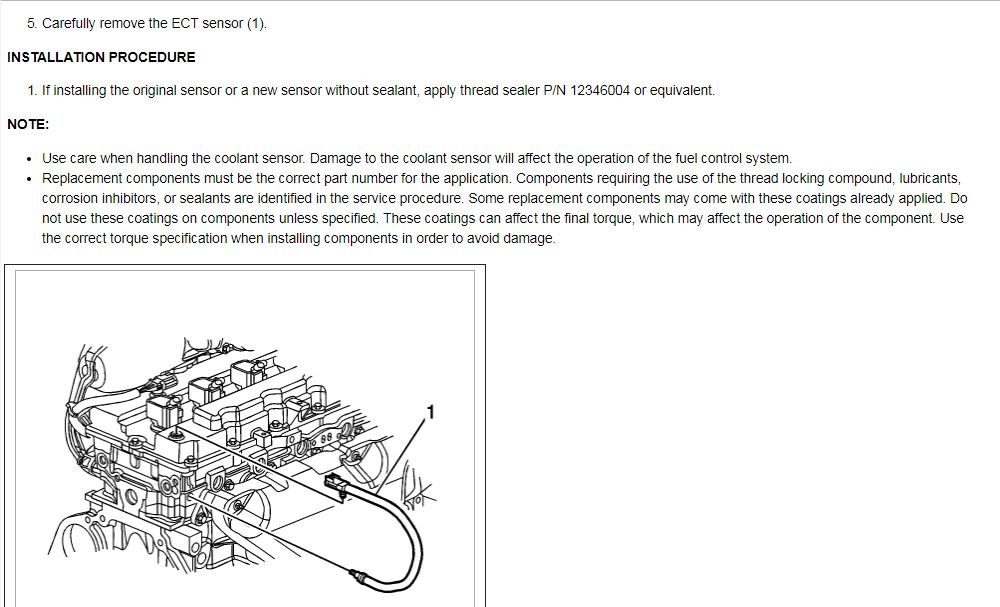

HARRY P
  • 2,292 POSTS
Here's the information that ALLData has on it, pictures and all. This is for the sensor that reports the temperature to the PCM, which is the one that you're needing. Hope it clarifies things for you.
