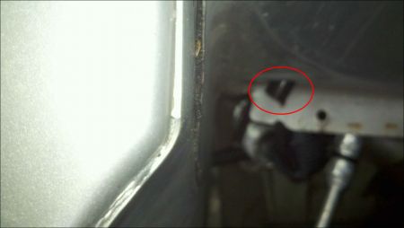

I have antifreeze leaking out of a tube on the front passengerside wheel well.. I thought this tube wasjust for AC condensation.. why is antifreezecoming out?

The AC drain is located on the firewall. Are you sure you are not seeing the coolant overflow line?

I believe it is the A/C drain tube there is a little tube about the size of my pinky coming through a little hole near the Firewall.. It is my understanding that the Coolant system is a closed system and there is not overflow tube. the pic (not so clear) is taken from the back of the tire and is the fire wall of the left and the wheel well on the top

From the picture, it looks like the AC drain. If coolant is leaking from there, the heater core may be the cause. If you turn the heater on, do you smell coolant in the vehicle?
