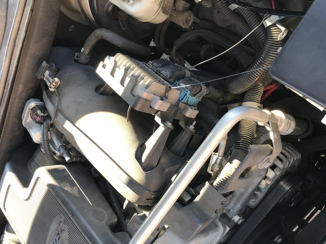

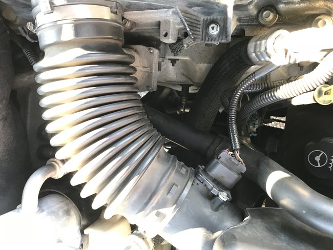

Can’t seem to locate the sensor. Every diagram I’ve looked at shows it in a location that has nothing but metal or screws. Even the dealer couldn’t tell me.
Oct 26, 2019 at 1:08 PM
Good evening,
I assume it is the 6 cylinder as there is no 2.1 motor.
I attached pictures for you to view. It is at the right rear of the engine.
Oct 26, 2019 at 1:15 PM
MADEINTXS
Right meaning passenger side or driver side? There is nothing on top. So, is it underneath the last spark plug? The one that’s really hard to get to?
Oct 26, 2019 at 1:23 PM
The passenger side at the back of the motor. Yes, it is difficult to access.

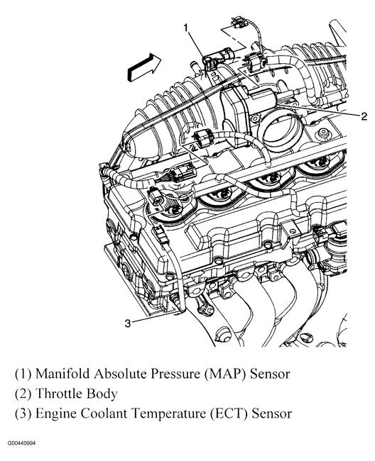

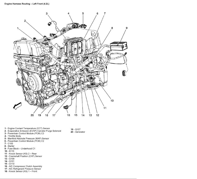

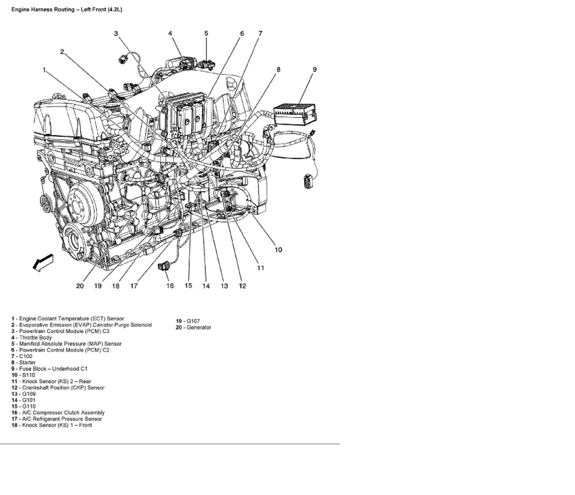

First you need to list the exact diagnostic fault code number. There are multiple codes for temperature sensors, and they mean very different things.
Also be aware that fault codes never ever say to replace a part or that one is bad. They only indicate the circuit or system that needs further diagnosis, or the unacceptable operating condition. When a part is referenced in a fault code, it is actually the cause of that code about half of the time. Before we waste your money on a part, we have to rule out wiring and connector terminal problems, and mechanical problems related to that part.

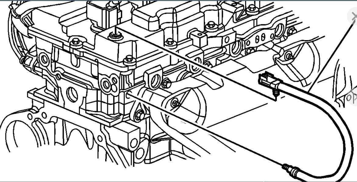

The coolant temperature sensor is number three on the drawing. It sits just under the valve cover, and just above the exhaust manifold. The arrow at the top left is pointing toward the front of the vehicle, so this view should be as though you were standing just behind the passenger-side front wheel. The sensor will be at the rear of the engine, on the passenger side.

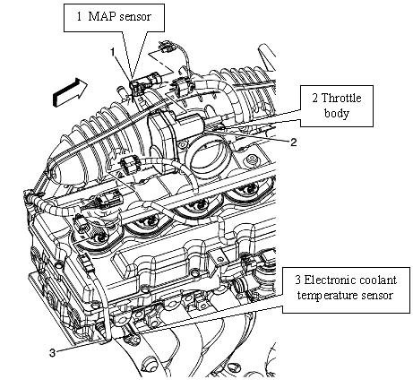

  • 55,694 POSTS

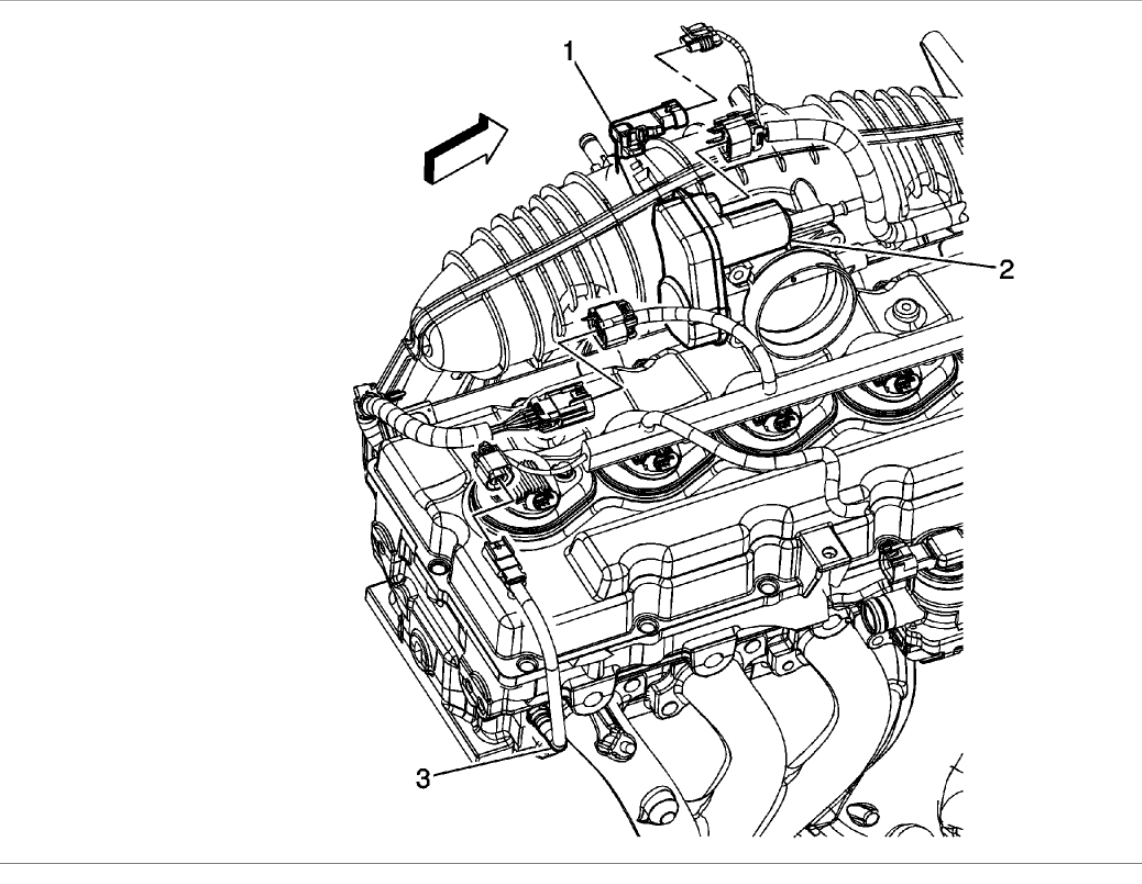

Here is the coolant temperature sensor for both engines and a guide to give you an idea of what you are in for when doing the job.
https://www.2carpros.com/articles/coolant-temperature-sensor-cts-replacement
Here are the diagrams (below)
Nov 2, 2020 at 7:19 AM (Merged)

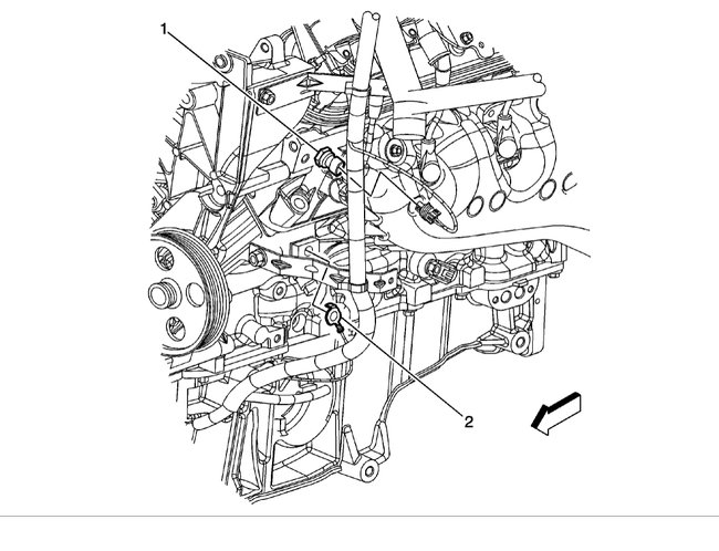

MARKHUNT09

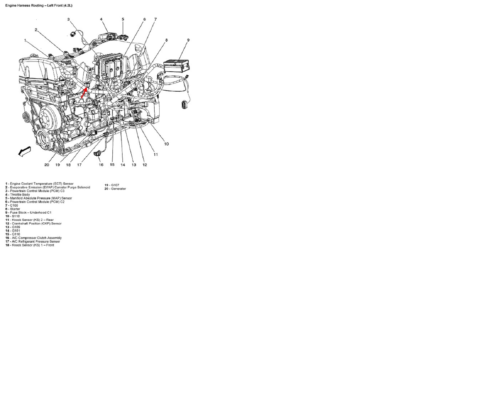

Could I please be told where the ECT sensor is located for my vehicle it is the LS model? I need to replace mine due to a P0128 code. I watch a video on YouTube but It was For a 2005 Blazer.
CARADIODOC
  • 34,414 POSTS
P0128 - ECT below thermostat regulating temperature,
Coolant temperature sensors are usually near the thermostat housing. Code 128 is set from the readings from a properly-working coolant temperature sensor.
I tried multiple times to resize the image, but it always comes out the same. The CTS is item number 1. I added a red arrow pointing to it.

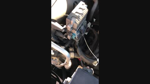

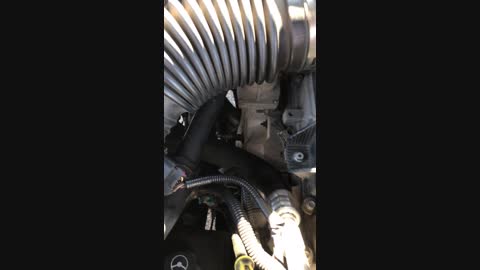

MARKHUNT09

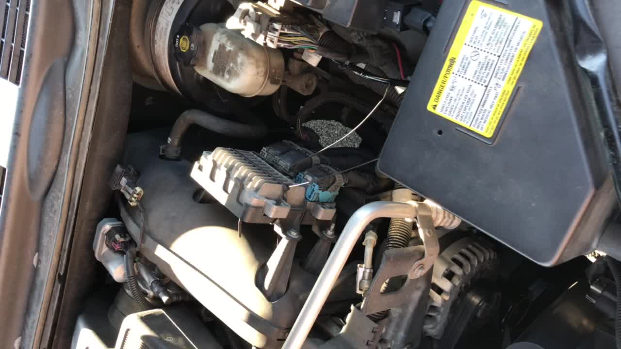

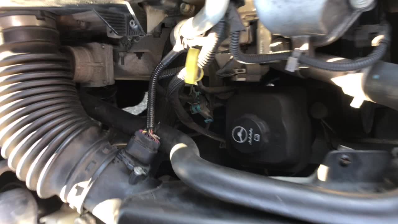

I am still having slight trouble locating the CTS. I took pictures and videos to try to help out.

CARADIODOC
  • 34,414 POSTS
I'm not familiar with your engine, but why are you looking for the sensor? Replacing the sensor won't solve the unacceptable condition it's reporting.
Coolant temperature sensors are usually close to or on the thermostat housing, and those are usually at the end of the upper radiator hose. As Heyman1104 said, the thermostat is the logical suspect. When it sticks open, the coolant doesn't stay in the engine long enough to get hot.

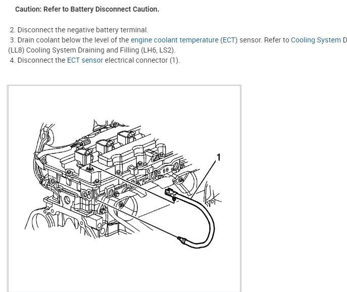

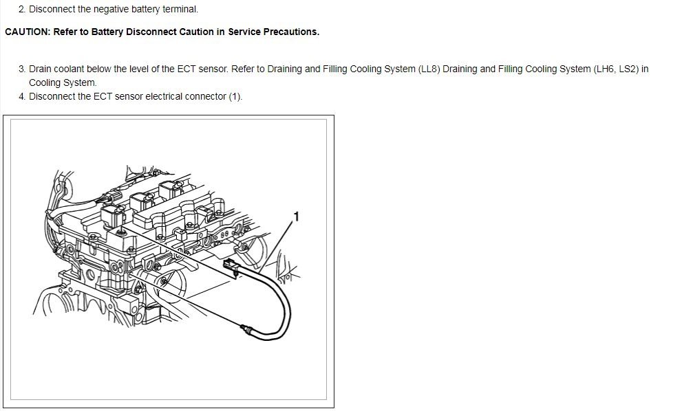

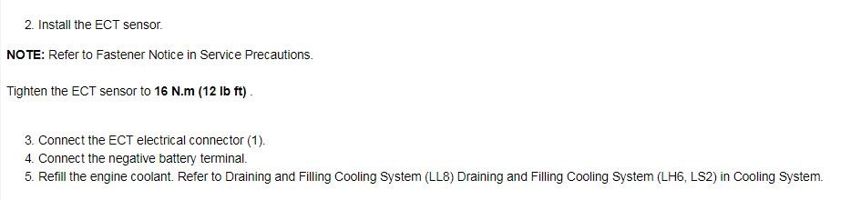

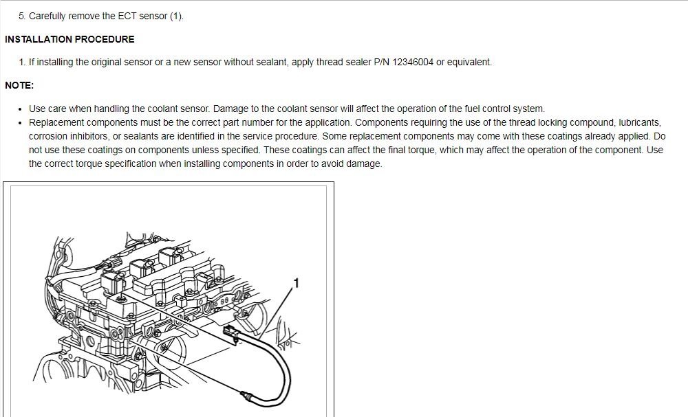

Here's the information that ALLData has on it, pictures and all. This is for the sensor that reports the temperature to the PCM, which is the one that you're needing. Hope it clarifies things for you.
