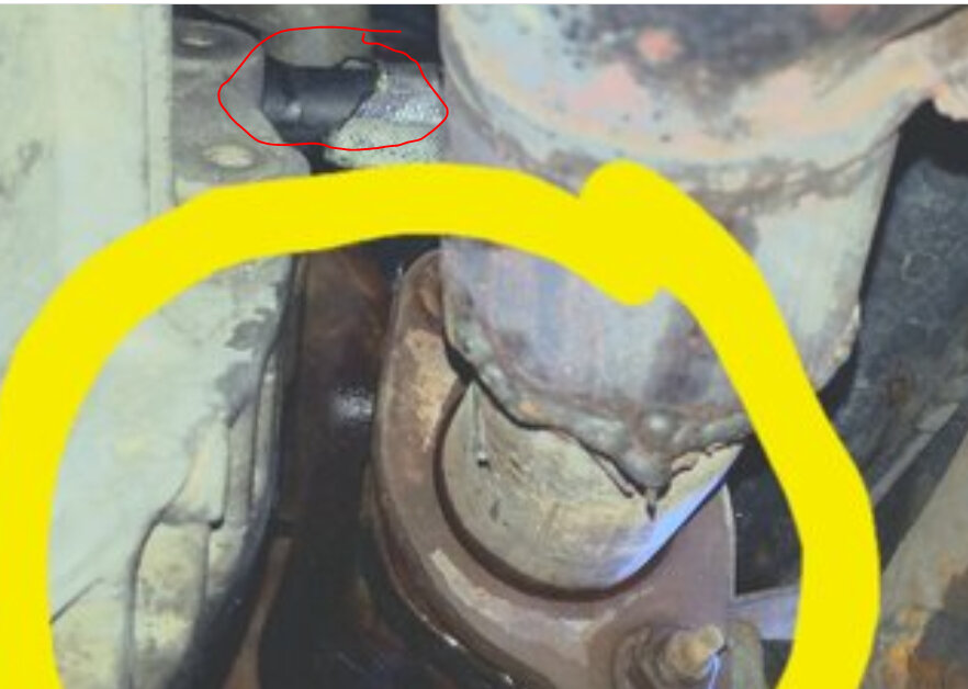

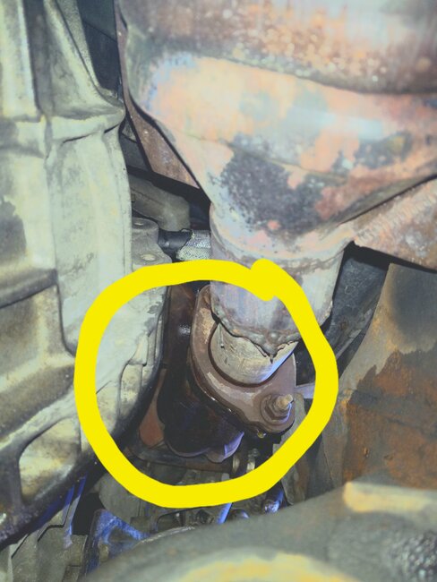

Let me try to clarify, the part that was leaking when I did the pressure test was the exhaust manifold itself, right before it attaches to the beginning of the muffler pipe, then after this I noticed that the coolant was leaking with my truck just parked there and no pressure whatsoever. See pic I took from under the engine. Thanks
Nov 17, 2022 at 4:09 PM
  • 110,244 POSTS
That is an interesting one. We know it shouldn't have coolant from the exhaust, so either it is coming from a head gasket issue or there is a cracked head.
Just for curiosity, what is the hose behind the exhaust that I see in your picture? I circled it below. Is that going to the heater core? Could that be leaking and dripping on to the exhaust?
See pic below.

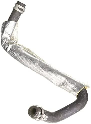

Thanks for following up with my questions, yes so coolant should not be leaking out of there, so how do I find what is the issue here? (Cracked head or head gasket) before I spend any money,
And to answer your question, that one is the heater hose.
I attached it.
Nov 18, 2022 at 12:35 PM
  • 110,244 POSTS
First, make sure the heater hose isn't causing the issue. It could be spraying and making it look like an engine issue.
If the hose doesn't leak, the next thing to do is remove the exhaust manifold and confirm exactly where the leak is coming from.

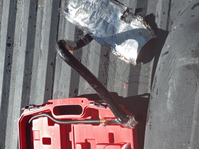

You were right! The heater hose was cracked, (the hose you saw in the pic) there was a burned spot on it. This was causing the leak that made it look like it was coming out of the exhaust manifold.
I also replaced the heater control valve since it has leaked in the past and it's been a while since the last time it broke (like 3 years)
I will keep an eye on it next time I try to use the defroster, maybe I can pinpoint the leak.
Thanks a lot for your suggestions.
