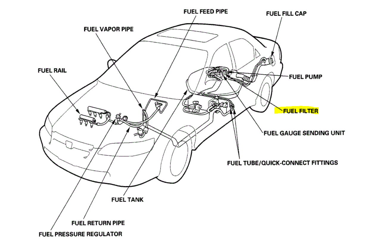

If you hear the pump, it doesn't mean it's good. Also, it's possible that the fuel filter is clogged.
I need you to try something. See if the engine starts for a couple of seconds using starting fluid. If it does, then we know it is a fuel-related issue. At that point, I need you to check the fuel pressure.
The fuel filter, which could be clogged, is an integral component of the fuel pump assembly. So, if pressure is low, we will need to remove the pump. See pic below
Let me know if it starts with starting fluid.
See pic below.

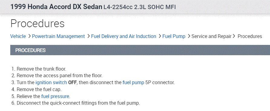

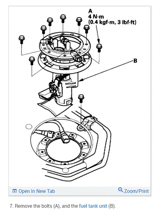

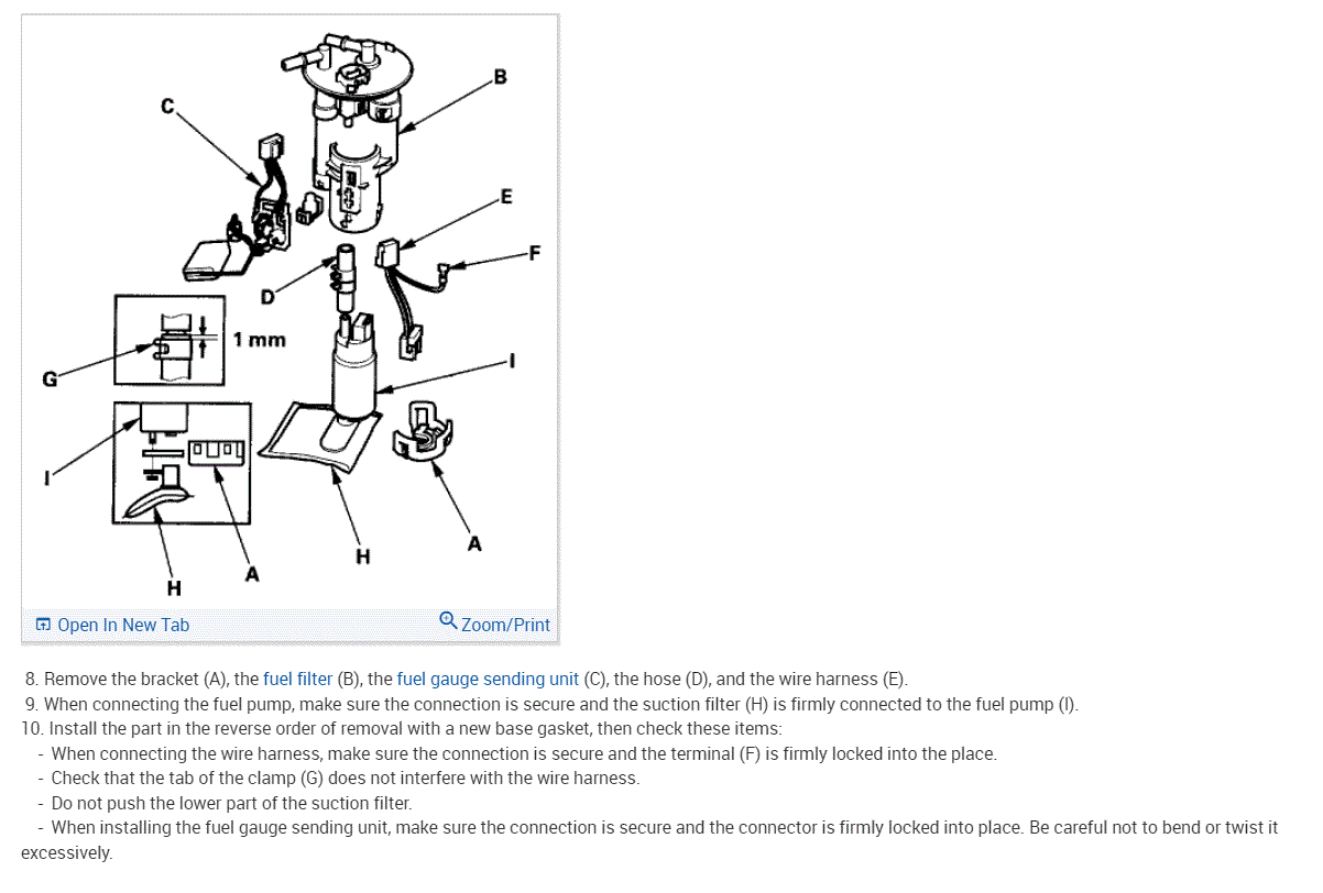

Although you hear the fuel pump turn on, it likely has failed. Even if you had a partially plugged fuel filter, you would see some fuel.
At this point, I would suggest replacing the pump. Please note that I am suggesting this based on the idea you hear it turn on. If it didn't, it could be a fuse, a relay, or a wiring issue. Also, since you had a lean fuel mixture code, the pump was likely going bad for some time.
If you look below, I attached the directions for replacing the pump. The fuel tank does not need to be removed. Open the trunk and remove the floor (removable). Once that is out, you will see an access port for the fuel pump that can be removed to replace it.
Additionally, here is a link you may find helpful. It explains in general how one is replaced.
https://www.2carpros.com/articles/how-to-replace-an-electric-fuel-pump
I think this is the issue. Let me know if I can help in any way. Also, let me know if this takes care of the issue.

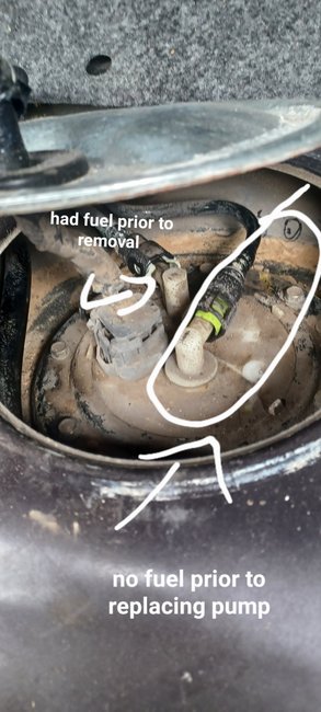

AMBI.SKYE
  • 21 POSTS
Hey Joe,
I replaced the fuel pump today. Thank you for the information and the diagrams.
Unfortunately the car still won't start.
One of the fuel lines seemed completely dry, the other had fuel in it.
I'll attach a photo to show which was which, incase that means anything.
After replacing and priming the pump I wouldn't start. I checked for leaks, thankfully there were none as best I can tell. I checked both lines again before closing the access port, now both have fuel in them.

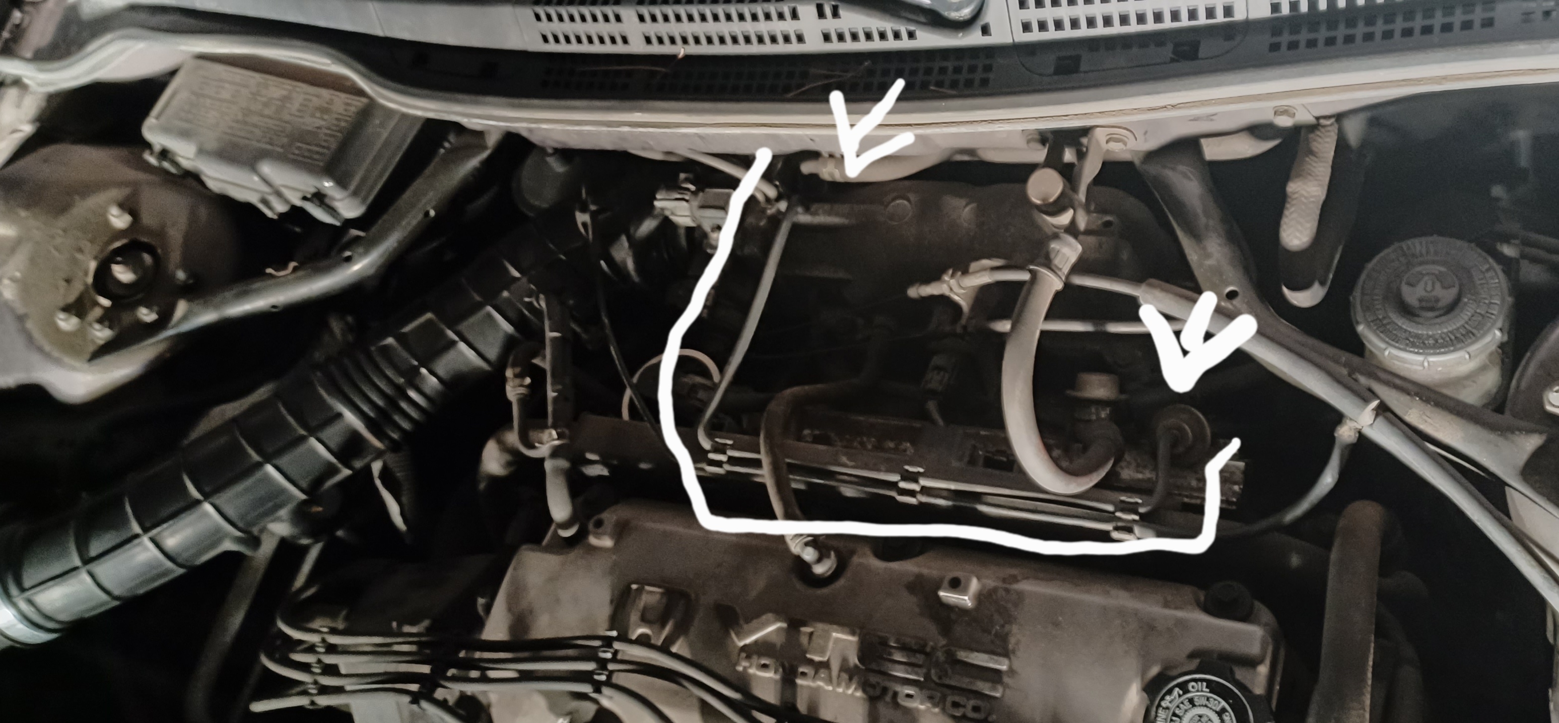

Do you have fuel in both the supply and return? If that is the case, there must be fuel at the fuel rail (Schrader valve) you check. If there isn't pressure and the lines have fuel, it makes no sense.
Is it possible for you to take a pic of where you are checking for fuel and upload it for me to see?

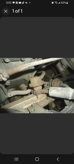

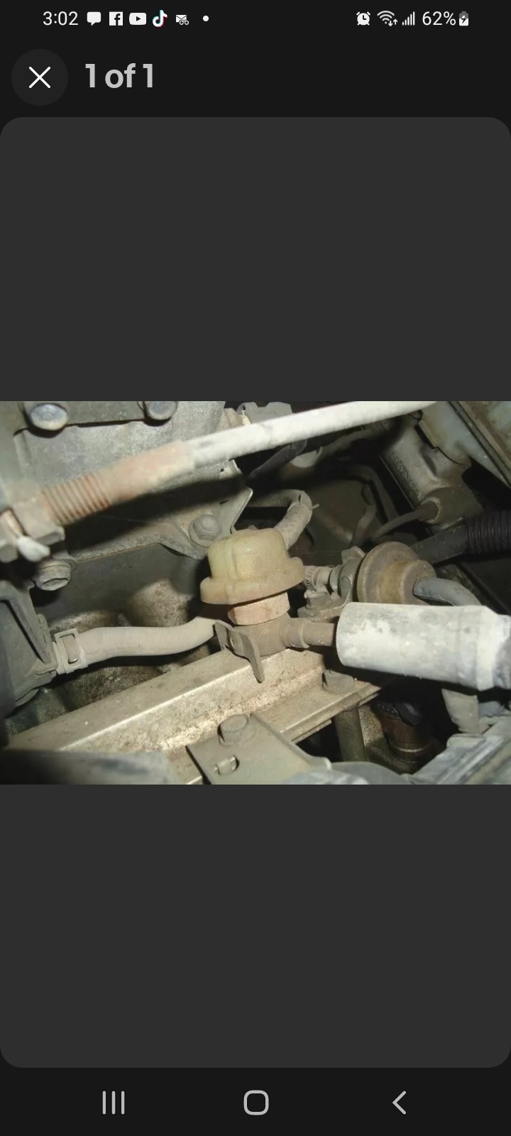

AMBI.SKYE
  • 21 POSTS
Yes, I think it is called the fuel pulsation damper. I'll attach a photo below.
May 17, 2022 at 9:02 AM
  • 110,248 POSTS
You're correct. That is the damper. This isn't making sense. How could the fuel travel through the supply line and then through the return at the pump and not go through the damper?
I'm a bit perplexed. I would like to try something, but it requires you to be very careful. If you loosen the damper to release pressure and cover it with a dry rag, cycle the key on and then off quickly to see if the rag gets wet with fuel. Also, disconnect the regulator when you do this.
Note that fuel should shoot from the component, so make sure it is securely covered with a rag and only cycle the key very quickly.
Let me know if you get fuel.

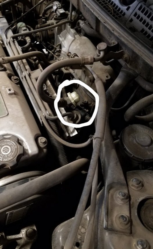

AMBI.SKYE
  • 21 POSTS
No, nothing came out of it at all when it was torn.
I cut the hose evenly and placed it back on after checking for cracks. I'm attaching a photo of the line I am talking about. Please let me know if this is the correct one!
May 22, 2022 at 2:43 PM
  • 110,248 POSTS
Yes, that does appear correct. Do me a favor. Allow the engine to idle and remove that hose and confirm there is a vacuum present.

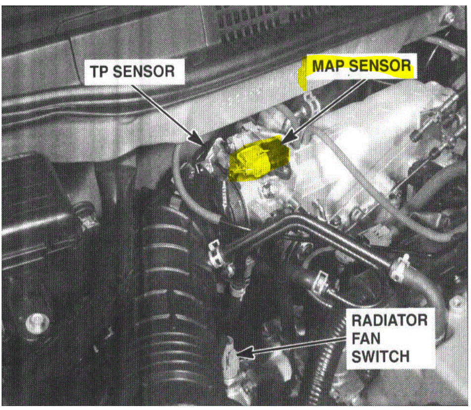

Can't locate the mass airflow sensor.

This vehicle doesn't have a MAF sensor. In its place is a MAP sensor, (manifold absolute pressure sensor). I attached a pic below showing its location.
Let me know if that helps.
See pic below.
