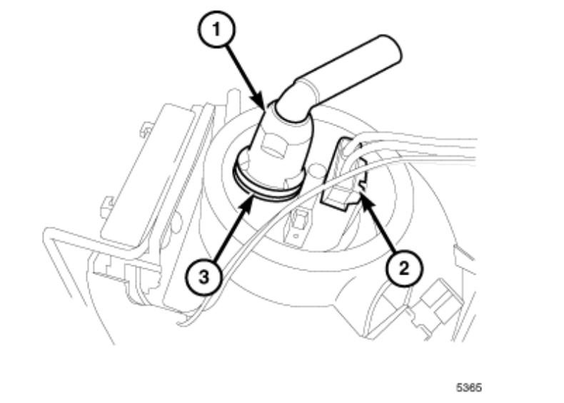

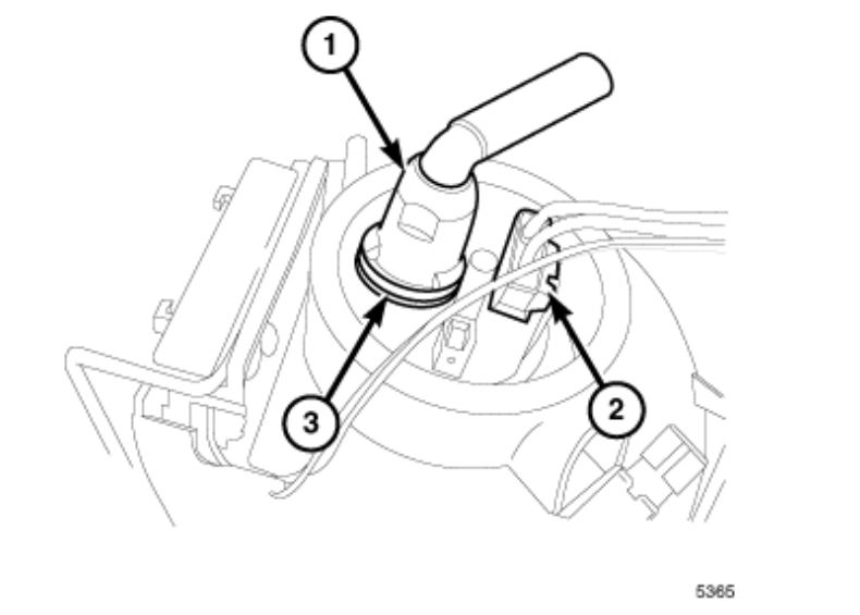

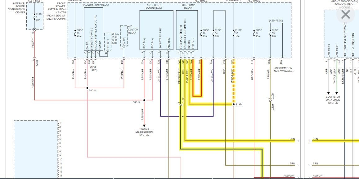

Car listed above is a 300C with a fuel leak on passenger side fuel pump/filter assembly we think from the top of the plastic part itself. We changed the o-ring first but it still leaks. I have the new part but now I can't pull the passenger side fuel line off because of constant fuel pressure on that line even with the driver side pump unplugged. When I changed the o-ring I had almost 3/4 of a tank of gas but now I let the tank level drop to 1/4 full. What could cause constant pressure on the passenger side fuel line when the pump is unplugged?

No, on a 2013 - 300C there is a pump assy under the back seat drivers side and the fuel line, filter and gas gauge sending unit on the passenger side. I can't delete the photo below with the other website on it.

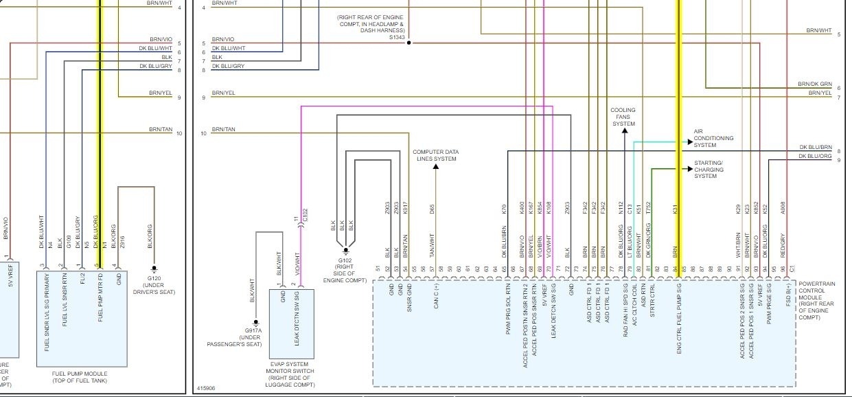

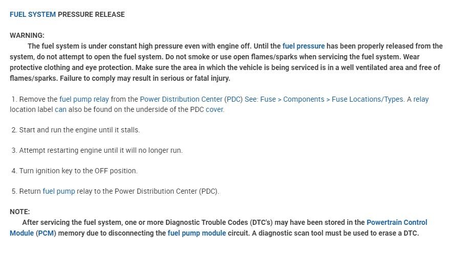

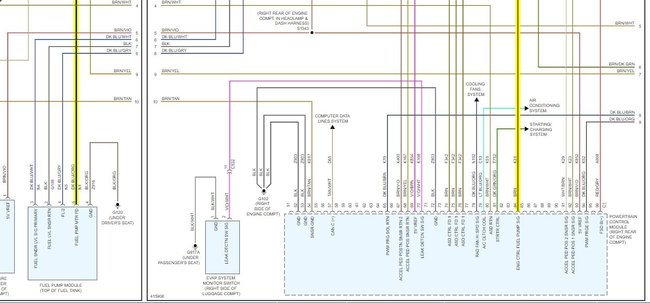

Okay, that line provides the fuel pressure to the rail, as you know.
Why are you changing the fuel pump?
There is residual pressure after the car is turned off. It is designed to operate like that.
Remove the electrical connector and start the engine. It will bleed down the system to allow the removal of the line.

That is exactly what I did, pull the wires off of the driver side pump, start the car until it stalls, go to the passenger side to remove the gas line off the plastic part shown above (that goes to fuel rails) but there is still pressure in that line. it doesn't make sense.

Remove the relay and see if still has pressure.
Do you have a test fitting on the fuel rail in the front?

You should check there.
Did you follow the procedure I posted for the bleed down?

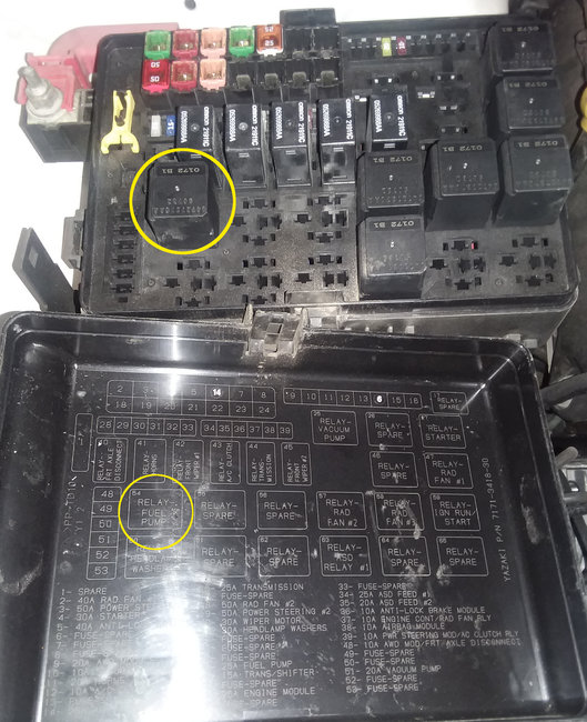

Let me try the relay instead of just unplugging the pump and see if that helps the pressure.
Jan 2, 2020 at 2:04 PM
RADCRO
  • 14 POSTS
So I pulled the fuel pump relay (#54) from under the hood, started the car and it keeps running, sluggish and sputtering but the engine never shut off. Stepping on the gas didn't rev the engine, just caused stuttering.
Jan 2, 2020 at 2:37 PM
Either that is not the relay or you did not leave it run long enough to run out of fuel.

You are correct, but the residual pressure should drop to zero with the pump not working.

Correct. Did you check for a valve on the fuel rail in the front?

The fuel rail Schrader valve? I haven't check to see if there is one, that would be a great place to relieve fuel line pressure.
Jan 3, 2020 at 10:39 AM
That is correct check on the fuel rail for the valve.

First off let me say thank you Roy. what a great website this is! To answer questions from total strangers and include wire diagrams, proper procedures, and expert insight is absolutely amazing.
I completed the project today and the issue I was having was excess fuel in the rails and fuel line even after getting the car to stall without a fuel pump plugged into power.
I changed a gasket 2 weeks ago in an attempt to stop the gas smell and leak on top of the passenger side fuel pump unit and didn't have the issue of excess fuel spurting out the fuel line when disconnected from the top of the passenger side fuel pump unit.
The only difference was that the engine was completely cold when I attempted this 2 weeks ago and was hot/warm when attempting it today and yesterday.
Be warned when removing that fuel line on a hot engine the fuel pressure is much greater and the temp of the gas is much hotter and be ready for 3 to 4 cups of spurting gasoline. Luckily I waited about an hour to an hour and a half to attempt this again today which made the pressure high and the gas temp only warm.
Started the car and all seems well next is freeway driving to make sure everything is good and hopefully, the new unit won't leak with the second new gasket and plastic pump part in place.
