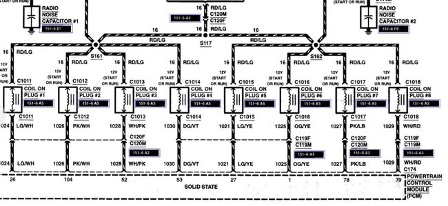

When I crank up the truck, it idles and runs badly. About two miles down the road, I can stop, put it in park then back in drive and all of a sudden it drives great. When I reach a destination, I cut the truck off and when it is started again, it does the same thing all over again. The truck does not have to be cut off long. As for the codes, all of the codes for coil packs show up. Primary circuits high low or whatever. I think it is P0351 and so on. Also have a P1132. P1132 is usually always there. P1151 shows up often too. Gutted catalytic converters play a role in one of those codes. They were stopped up so gutting them was the route I took. The coil pack codes from the scanner describe the packs as B-H. The plugs and packs was replaced and the truck ran normal for a day or two then back to the same routine.
Work I have done to the truck that may be noteworthy is as followed : gutted catalytic converters, new water pump, new plugs and packs and a couple of downstream o2 sensors.
Also, fuse 23 keeps blowing. It powers my blinkers, four wheel drive solenoid, ABS and overhead console. I cannot seem to track it down.
Anyway, what is going on with my coil packs?

So going back to the coil packs. There is something causing this. It is not the packs or plugs. I am getting six of eight COP codes after they were replaced. Same as before. I do not get any other codes on my scanner. What can cause this, other than the obvious? If there is grounds that are responsible, where are they exactly and is there any parts that could cause this that does not throw a code?
Apr 23, 2018 at 8:26 AM
The PCM controls the grounds. It uses that as a signal to fire the coil. check the connections at the PCM for any damaged or loose pins.
I attached a diagram for you to show you the wires go back to the PCM.
You need to check the wires. if the wires are okay, you may have a bad PCM.

What part does the radio play in this?
Apr 23, 2018 at 9:32 AM
It is just a capacitor for noise suppression.

Okay, so after all of this time, I decided to spend some money on this truck. They replaced all plugs, including two heli-coils, all coil packs, and had to fix a burnt wire on the back of block that went to a fuel injector. The truck is running great now. Thanks guys for all of your help,
