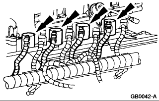

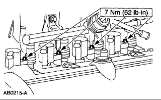

How do you remove and replace the 8 ignition coils for this truck

REMOVAL:
1.Disconnect the Coil On Plug (COP) electrical connectors.
2.Disconnect the eight fuel injector electrical connectors.
3.Remove the bolts and ignition coils.
INSTALLATION:
1.To install, reverse the removal procedure. NOTE: Apply brake caliper grease to the inside of the coil boots.
