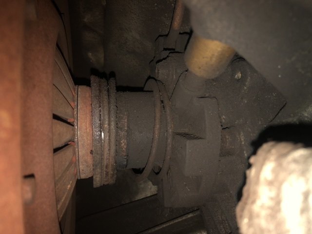

CGCOURSON
  • 5 POSTS
Here is a photo of the hydraulic line going into the transmission housing. I guess it’s internal. Any idea on how much roughly this might cost for a mechanic to repair? Thank you so much for your time and efforts it is greatly appreciated.

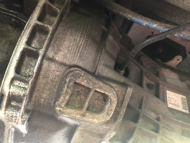

CGCOURSON
  • 5 POSTS
Here it is:
Mar 24, 2021 at 4:22 AM
CGCOURSON
  • 5 POSTS
With boot off:
  • 110,244 POSTS
It's internal. If you have a helper press hard on the clutch, do you see any movement at the slave? I see a lot of rust on things in the pic. I'm wondering if it is frozen.

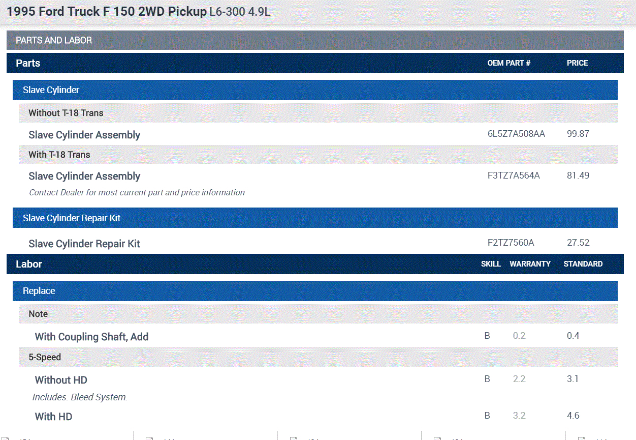

As far as repairs, if the slave needs replaced, it shouldn't be too bad. I have attached a pic. It indicates dealer price on parts and labor hours to perform the repair. You would have to multiply the hours by the hourly labor rate.
