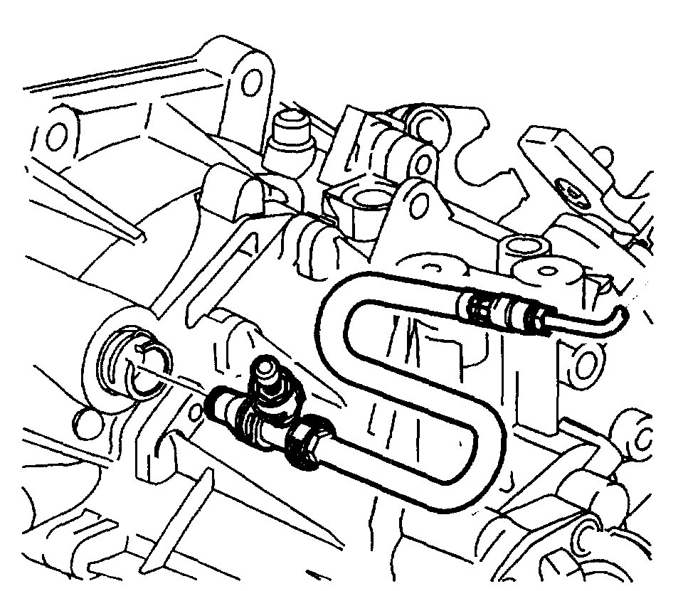

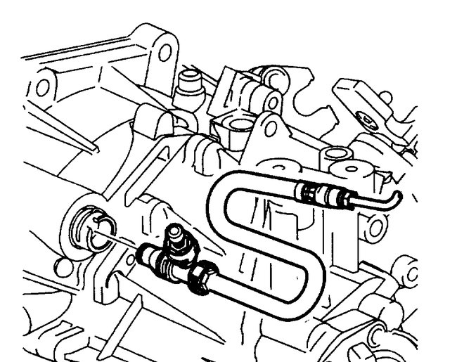

Clutch Actuator Cylinder Replacement
Removal Procedure
picture 1

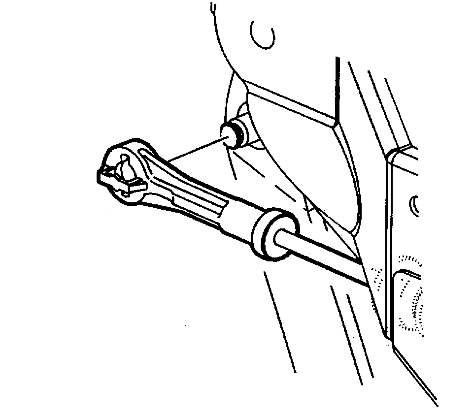

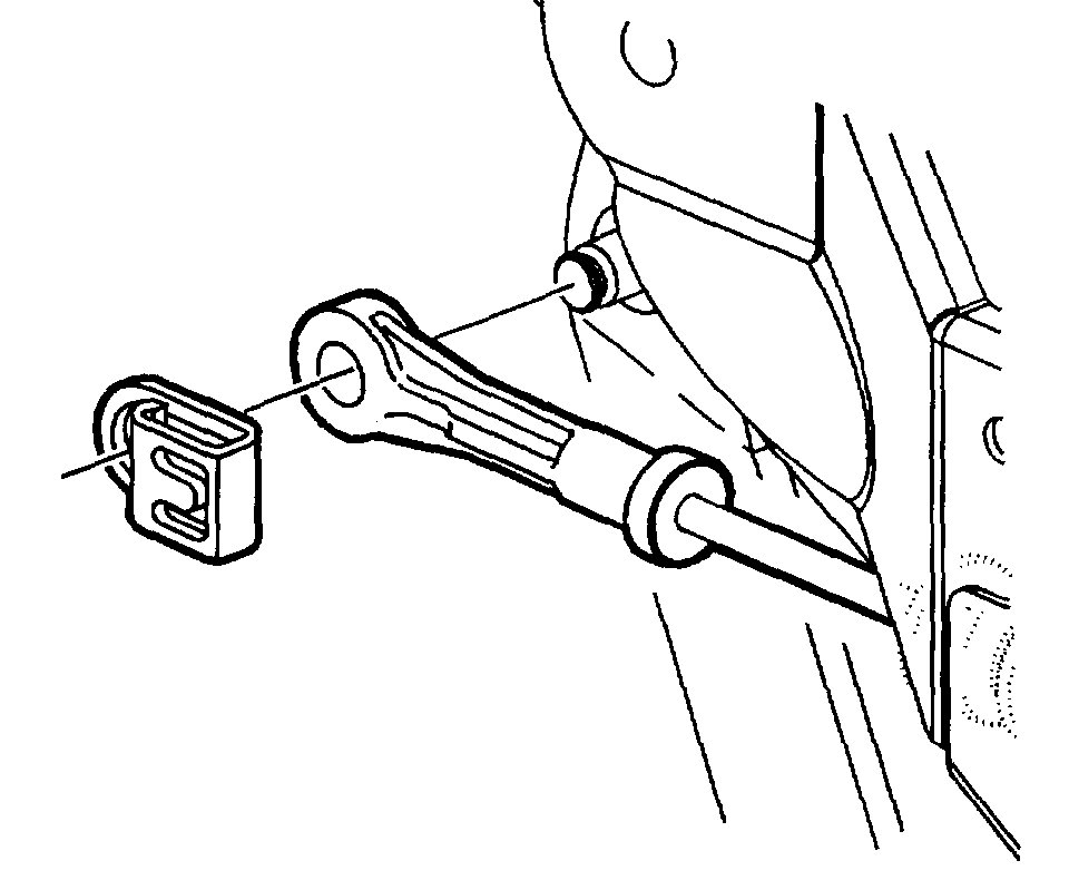

1. Disconnect the clutch master cylinder line from the transaxle by removing the C-clip.
2. Remove the transaxle.
3. Remove the clutch actuator cylinder bolts from the transaxle.
4. Remove the clutch actuator cylinder.

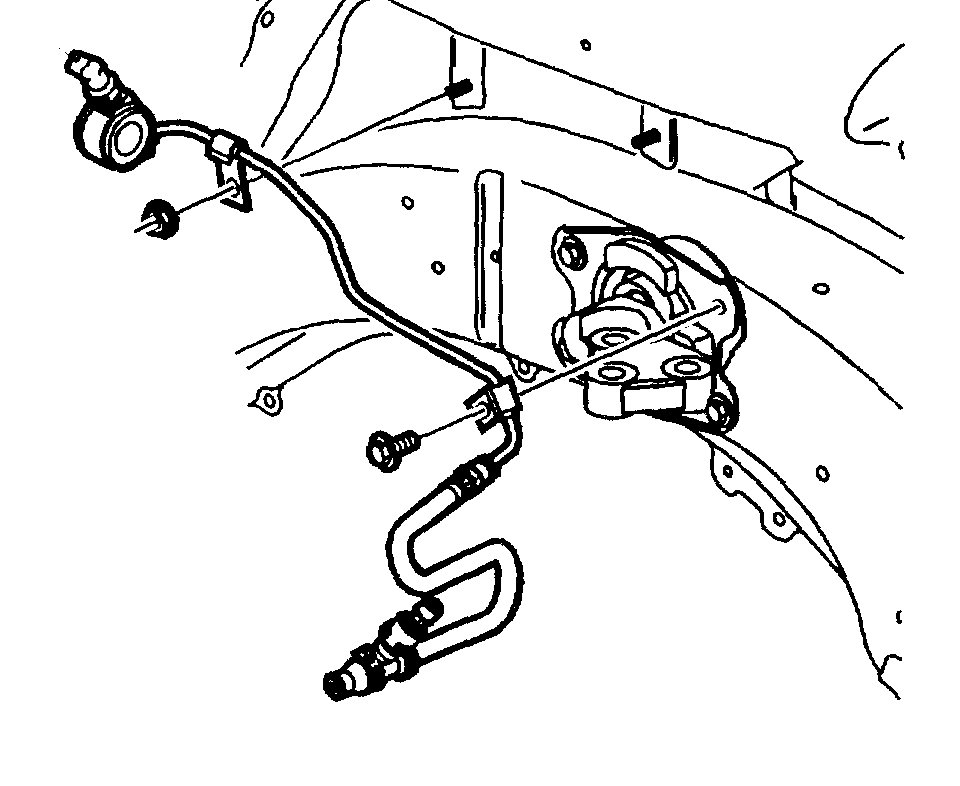

Installation Procedure
pic 2
Important: Excessive amounts of lubricant on the input shaft splines can contaminate the clutch disc and cause clutch shudder.
1. Lightly lubricate the inside diameter of the bearing with input shaft lubricant P/N 21005995 or equivalent.
2. Install the clutch actuator cylinder (1) to the transaxle.
Notice: Refer to Fastener Notice in Cautions and Notices.
3. Install the clutch actuator cylinder bolts.
- Tighten the bolts to 10 Nm (89 inch lbs.).
4. Install the transaxle.
pic 3
5. Connect the clutch master cylinder line to the transaxle by pushing it in until it seats.
6. Bleed the clutch hydraulic system.

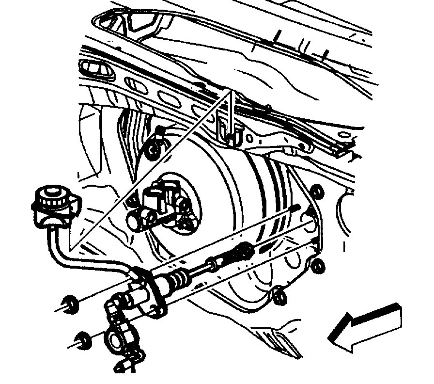

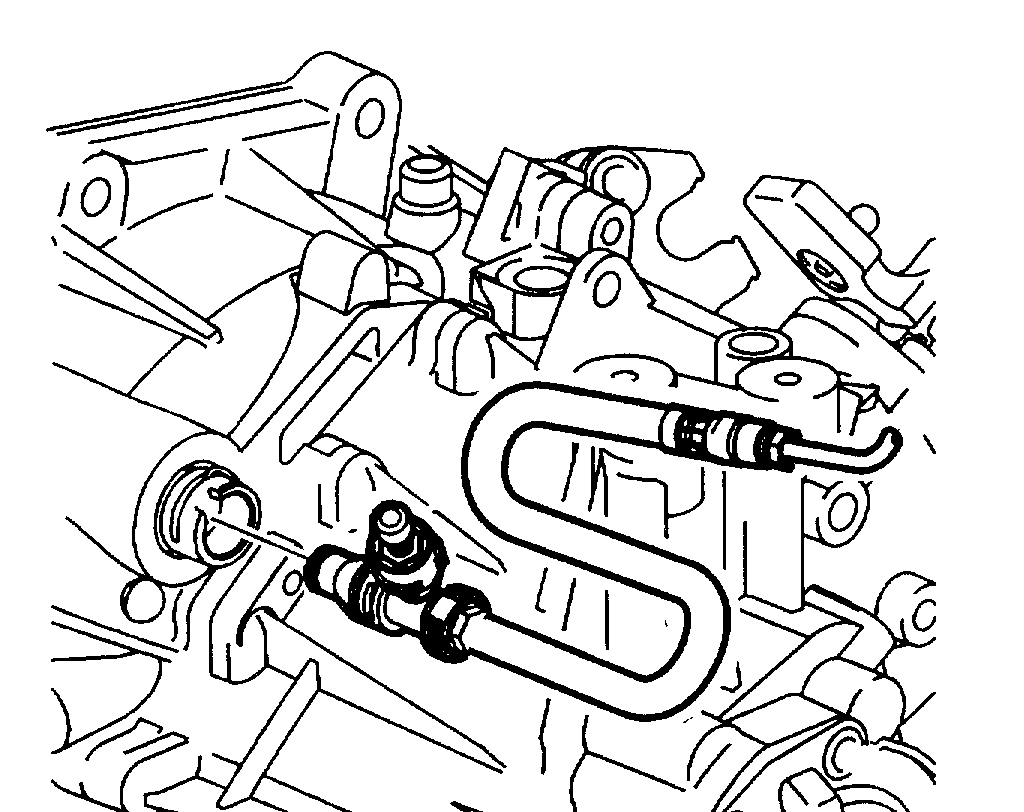

PROCEDURES

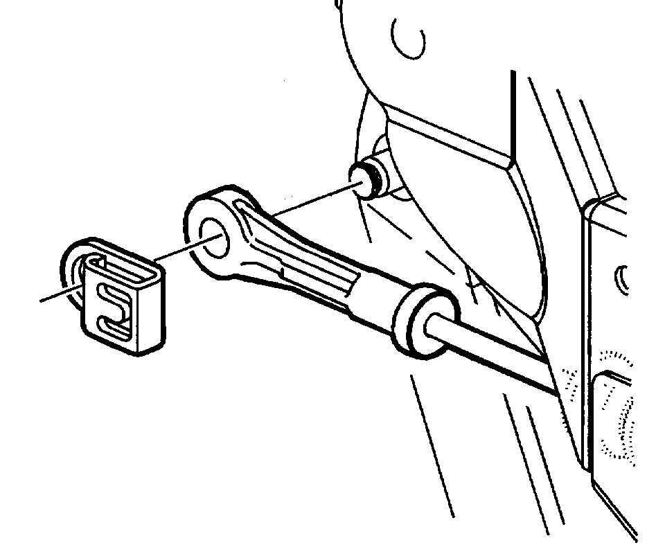

Clutch Master Cylinder Replacement
Removal Procedure
pic 4

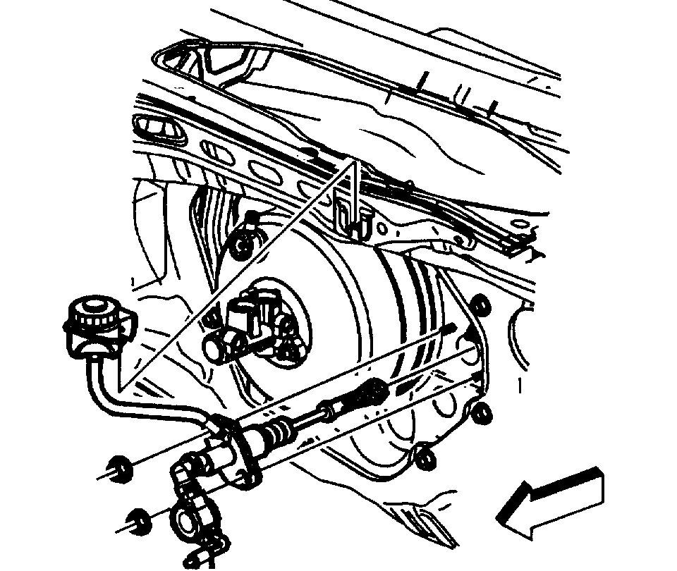

1. Clean the clutch fluid reservoir cap and area around the cap.
2. Remove the clutch fluid reservoir cap and remove enough brake fluid to clear a passage to the clutch master cylinder.
3. Remove the clutch pedal retainer.
4. Remove the clutch master cylinder pushrod from the clutch pedal assembly, 1st design.

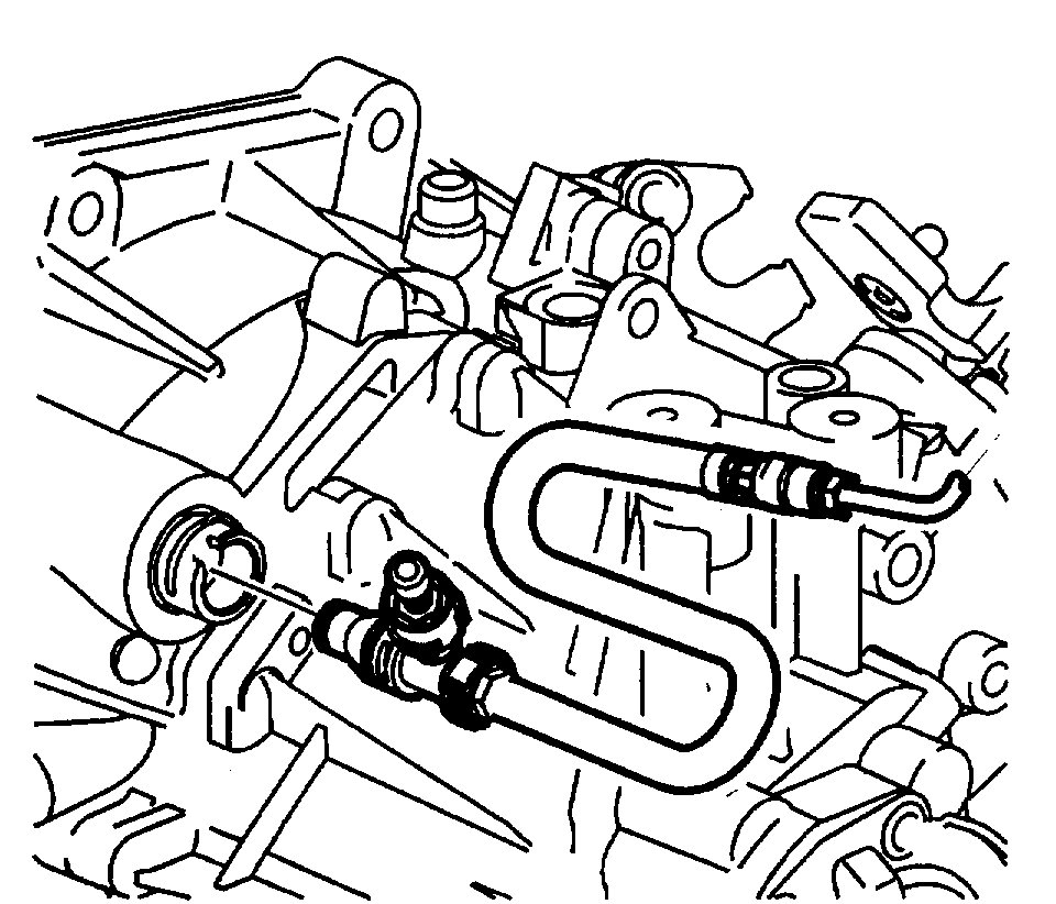

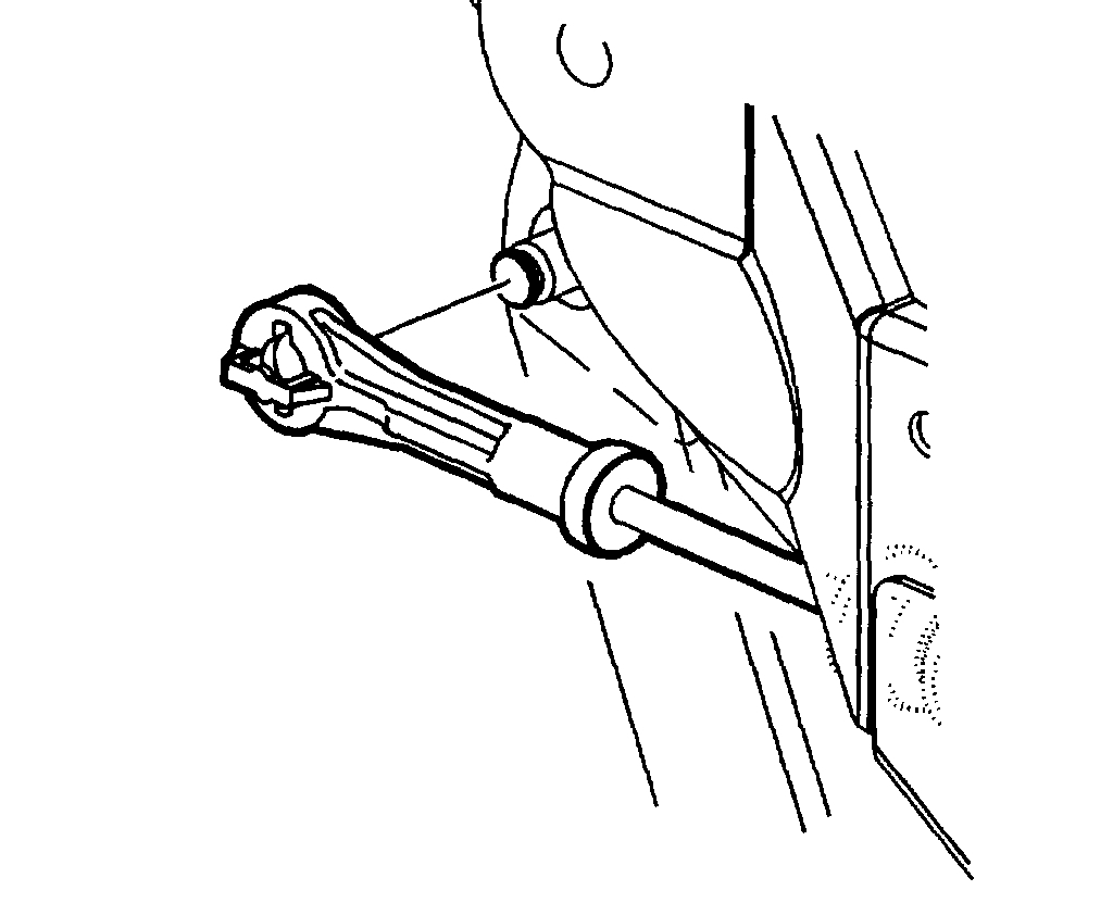

pic 5
5. Remove the clutch master cylinder pushrod from the clutch pedal assembly, 2nd design.

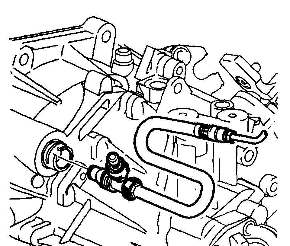

pic 6
Notice: Refer to Brake Fluid Effects on Paint and Electrical Components Notice in Cautions and Notices.
6. Place a shop towel under the clutch master cylinder in order to catch any fluid loss.
7. Using a pick tool on the strut tower side, disconnect the clutch line from clutch master cylinder.
8. Cap the reservoir and hydraulic lines in order to prevent fluid loss and contamination.
pic 7
Important: Do not damage the pushrod boot when sliding it through the front of the dash.
9. Remove the clutch master cylinder mounting nuts and slide the clutch fluid reservoir up and out.
pic 8
1. Uncap the fluid reservoir and hydraulic lines.
2. Slide the clutch fluid reservoir into the mounting slot and install the clutch master cylinder mounting nuts.
- Tighten the nuts to 23 Nm (17 ft. lbs.).
pic 9
3. Install the clutch master cylinder pushrod to the clutch pedal assembly, 1st design.
4. Install the clutch pedal retainer.
pic 10
5. Install the clutch master cylinder pushrod to the clutch pedal assembly, 2nd design.
pic 11
6. Remove the shop towel and discard into a suitable container.
7. Connect the clutch line to the clutch master cylinder.
pic 12
8. Connect the clutch master cylinder pushrod to the clutch pedal.
9. Install the clutch pedal retainer, nuts and bolts.
10. Bleed the clutch hydraulic system.

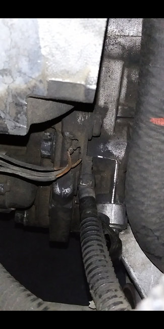

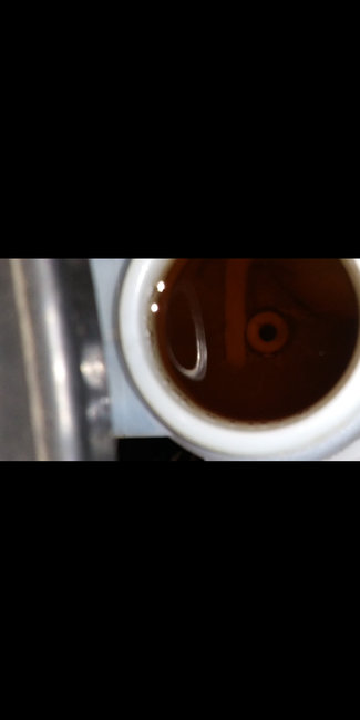

Joe I need your advice. I took my car in. Manju the reservoir is full it has been full before this issue started and after we bled it improperly or otherwise it has always been full. In addition there was no visible leakage. My question to you is, is it possible for the reservoir to keep its consistent level and there be leakage within the slave cylinder? Where is that fluid stored if there is leakage and it's not coming from the reservoir?
just to let you know I'm not too sure about these questions but that's what I was told. please answer me back as soon as possible like today. joking LOL, Gabrielle
May 24, 2019 at 11:10 AM
  • 110,244 POSTS
Welcome back,
If the slave is leaking, the level will go down in the reservoir. There is nowhere for the slave to store fluid. Also, I feel strongly that if that was the case, you would see the leak.
May 24, 2019 at 1:21 PM
GABBYGILBO
  • 55 POSTS
Where would I see the leak?
Can it leak inside?
These question I do not know. They are telling me that slave is leaking.

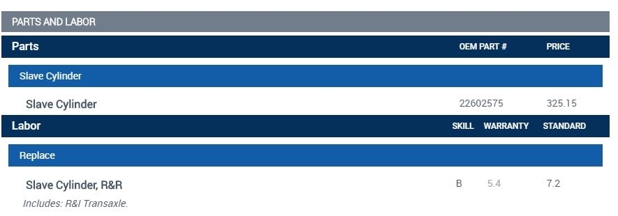

All I can say is, I wish. I have never been to CA but plan to visit one day. Now for the problem at hand. Anything is possible. However, it is interesting that the master cylinder is now nearly empty. Ugh!!! Honestly, and I hate to say this because I'm not there to see what is happening, but you may want a second opinion from a different shop. They can't hold your vehicle.

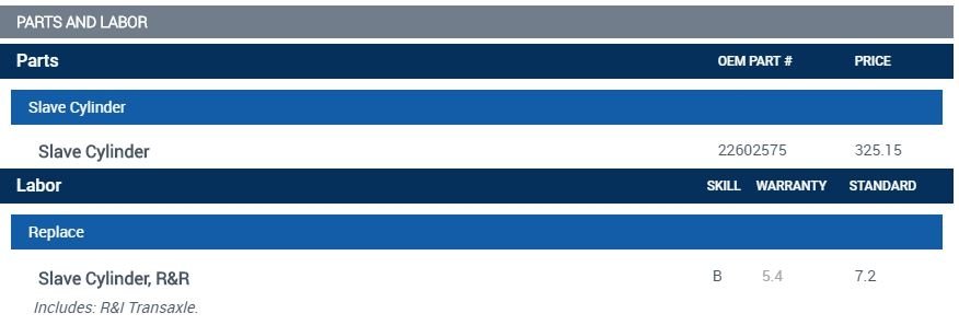

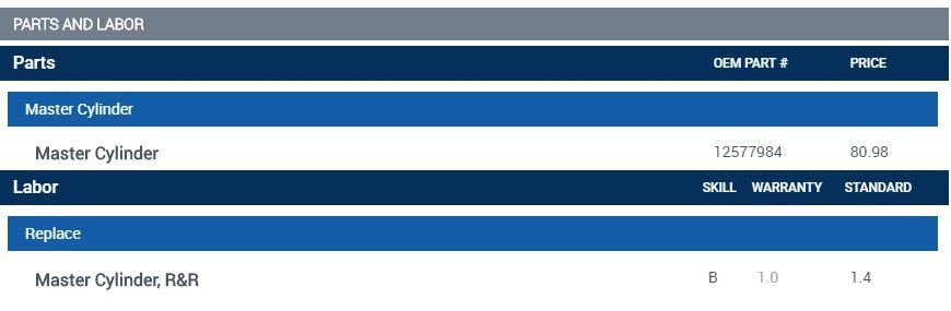

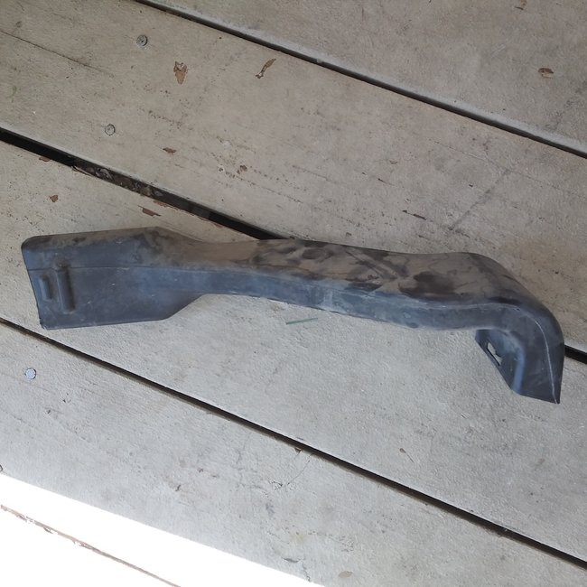

I'm sitting here thinking and it hit me, $1.800.00? Do they charge $200.00 an hour for labor? I have no idea what the labor rates are there, but wow!
Take a look at the picture. It shows the cost of an original equipment part and how many hours labor is given to install it. The part is over $300.00 and it calls for 7.2 hours labor. That means they are charging around $200.00 an hour. Is that correct? If it is, maybe I should move. LOL And yes, I am sure an aftermarket slave can be purchased for cheaper.
Don't allow yourself to get upset. There are always options, and at this point I think you should get a second opinion. I have no idea how they are testing the car, and now I have no idea if the master cylinder has or hasn't dropped. If it has, then I would suspect a leak at some point or a bad slave. If the master cylinder leaked, you would be able to see it.
I wish I had a better answer for you and wish I could help more. However, please feel free to let me know if you need anything.

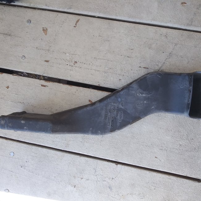

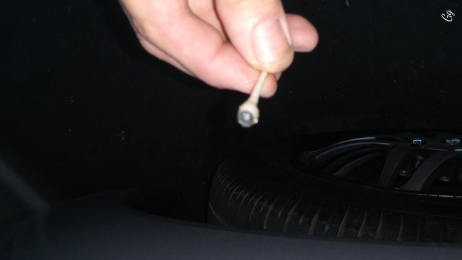

Ken, it is Gabrielle we are doing the oil change the guy found this part he said "floating" in the engine area, not attached. I took a picture of it. I have no idea what it belongs to, do you? Intake duct for?

Now, for the picture you attached. It was found in the engine compartment? Is it plastic and hollow? It's hard to tell for sure, but it appears to the the fresh air inlet tube that would attach to the air filter box under the hood.
Check the air filter box to see if something is missing where fresh air enters the box and let me know.

Hi there again. I took my car back to them this morning in the mechanic on duty there couldn't figure out how to attach that piece. l was asked to come back tomorrow so the mechanic that worked on my car can attach it.
The piece (air duct) attaches to the battery compartment and extends somewhere between the radiator and the headlight assembly. I do not know. Do you?

I'm going to send you a video. Tell me what you think?
Corporate office and I agreed that the best route to take would be to file complaint and the district manager will handle it so that you can find someone within his their corporation that is able to fix my car because apparently no one in my surrounding area can.
Thank you. God bless.
Jul 16, 2019 at 2:01 PM
  • 110,244 POSTS
Welcome back,
I will watch for your video. However, am I looking at wiring with about 2 inches of insulation missing?
Jul 16, 2019 at 2:42 PM
GABBYGILBO
  • 55 POSTS
Yes you are correct. That was not like that before I have shop my car.

Joe in addition I attached pic of my clutch reservoir. The white line in dirt is where I took Q-tip across bottom.
