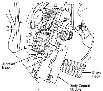

What is and where is the body control module on 99 Plymouth Voyager? Tks!
Aug 31, 2020 at 7:07 AM
SERVICE WRITER
  • 9,123 POSTS
The BCM provides power and ground to a variety of systems as well as stores odometer information for the cluster.

DANAG1
  • 91 POSTS
Ok, Thanks! I see what i can do and if i will be able to make the car start again. Just amazing how easy can broke down and how hard is to find the problem! I will update with everything.
DANAG1
  • 91 POSTS
Well..thanks to the people on this forum, i was able to fix my car. Here is what i did: took off the auto shut down relay ( in the box next to the battery) and after a while, i put it back...the noise disapeared, but the car still didn't start..then, someone here( service writer) send me a picture to show me where to look for that BCM, so..i went to the car and inside, on the left side of brake pedal, i saw...sort of box with ..fuses and relay i guessJunction box? I don't know, if someone knows, please tell me the name of that)...i took all of them out, (one by one), wait few seconds and put it back. After all was done, i turn the ignition on..dind't start at first but looked like wanted to start, so, turned off and on again and..the car started! Again, thank you very very much...if it wasn't for you, i wouldn't be able to do it! You are the best guys!
