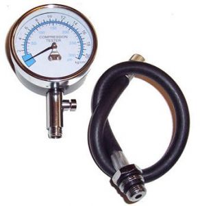

How can I check the compression?
Mar 24, 2009 at 11:06 AM
OBXAUTOMEDIC
  • 3,717 POSTS
How to Test Engine Compression An engine depends on an equal compression in each cylinder to run smoothly. If poor compression exits in one or more cylinders it can cause a rough idle condition and low power. A compression test can be performed to check wear or internal damage. A compression gauge is needed to test the engine cylinders. There are two types of gauge styles, one threads into the spark plug hole which is more accurate. The other style of gauge is constructed with a rubber plug that is meant to be pressed against the spark plug hole, this style of gauge is difficult to use. To perform a engine cylinder compression test follow the steps below. Remove ignition coil connector or ignition system or fuel pump fuse to disable power to the ignition or fuel system Test ignition system to ensure that the power to the system has been disabled Remove #1 cylinder spark plug and insert compression gauge, most gauges have a hose attachment that is installed into the spark plug hole with the gauge connecting to the gauge hose.
https://images.2carpros.com/forum/automotive_pictures/188069_compression_gauge_1.jpg
Engine Cylinder Compression Gauge After the compression gauge has been inserted, use the starter to crank the engine over for about five seconds. Use about the same five seconds to test the remaining cylinders. Record the compression reading as each cylinder is tested Remove the compression gauge and reinsert the spark plug Follow this procedure until all cylinders have been tested Compare cylinders compression reading, typical compression readings are between 125 p.s.i. and 160 p.s.i. all cylinder readings should be within about 5% of each other. If low compression exists a cylinder malfunction exits and further inspection is required. Possible causes for a low compression condition are: burned intake or exhaust valve, broken piston or piston ring, broken valve spring or a blown head gasket. .

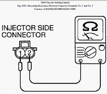

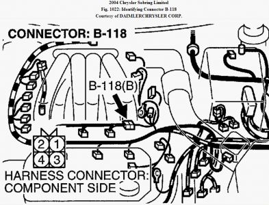

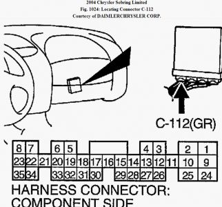

MERLIN2021
  • 17,250 POSTS

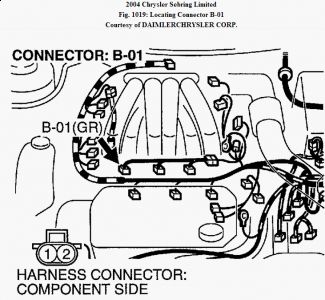

TROUBLESHOOTING HINTS (THE MOST LIKELY CAUSES FOR THIS CODE TO BE SET ARE:)  Ignition system related part (s) failed.  Low compression pressure.  Injector failed.  ECM failed. < M/T >  PCM failed. < A/T >  No. 1 cylinder spark plugs failed.  Harness damage in No. 1 cylinder injector circuit, or connector damage.DIAGNOSIS Required Special Tool:  MB991502: Scan Tool (MUT-II). STEP 1. Check the No.1 cylinder spark plug. 1. Remove the intake manifold. 2. Check the plug gap and replace if the limit is exceeded. Standard value: 1.0 - 1.1 mm (0.039 - 0.043 inch) Limit: 1.3 mm (0.051 inch) Q: Is the plug gap at the standard value? YES: Go to Step 2. NO: Replace the No.1 cylinder spark plug. Then go to Step 9 . Fig. 1017: Identifying Spark Plug Gap Courtesy of DAIMLERCHRYSLER CORP. STEP 2. Check the No.1 cylinder spark plug cable. 1. Check the cap and coating for cracks. 2. Measure the resistance. Limit: maximum 22 kohm Q: Is the measured resistance less than 22 kohm? YES: Go to Step 3. NO: Replace the No.1 cylinder spark plug cable. Then go to Step 9 . Fig. 1018: Measuring Spark Plug Cable Resistance Courtesy of DAIMLERCHRYSLER CORP. STEP 3. Check the No.1 cylinder injector. 1. Disconnect the No.1 cylinder injector connector B-01. NOTE: For Special Tool identification, see SPECIAL TOOLS . CAUTION: Do not attempt to adjust the gap of the platinum plug. Cleaning of the platinum plug may result in damage to the platinum tips. Therefore, if carbon deposits must be removed, use a plug cleaner and complete cleaning within 20 seconds to protect the electrode. Do not use a wire brush.Fig. 1019: Locating Connector B-01 Courtesy of DAIMLERCHRYSLER CORP. 2. Measure the resistance between injector side connector terminals No. 1 and No. 2. Standard value: 13 - 16 ohms [at 20 °C (68 °F)] Q: Is the resistance between 13 and 16 ohms? YES: Go to Step 4. NO: Replace the No.1 cylinder injector. Then go to Step 9 . Fig. 1020: Measuring Resistance Between Connector Terminals No. 1 And No. 2 Courtesy of DAIMLERCHRYSLER CORP. STEP 4. Check connector B-01 at No.1 cylinder injector and connector B-118 at injector intermediate connector for damage. Q: Is the connector in good condition? YES: Go to Step 5. NO: Repair or replace it. Refer to HARNESS CONNECTOR INSPECTION . Then go to Step 9 . Fig. 1021: Locating Connector B-01 Courtesy of DAIMLERCHRYSLER CORP. Fig. 1022: Identifying Connector B-118 Courtesy of DAIMLERCHRYSLER CORP. STEP 5. Check connector C-111 at ECM < M/T > or connector C-112 at PCM < A/T > for damage. Q: Is the connector in good condition? YES: Go to Step 6. NO: Repair or replace it. Refer to HARNESS CONNECTOR INSPECTION . Then go to Step 9 . Fig. 1023: Identifying Connector C-111 Courtesy of DAIMLERCHRYSLER CORP. Fig. 1024: Locating Connector C-112 Courtesy of DAIMLERCHRYSLER CORP. STEP 6. Check for harness damage between No. 1 cylinder injector connector B-01 (terminal No.2) and ECM connector C-111 (terminal No.1) < M/T > or PCM connector C- 112 (terminal No.1) < A/T >.Q: Is the harness wire in good condition? YES: Go to Step 7. NO: Repair it. Then go to Step 9 .STEP 7. Check the compression. Refer to COMPRESSION PRESSURE CHECK . Q: Are there any abnormalities? YES: Go to Step 8. NO: Repair or replace it. Then go to Step 9 . STEP 8. Replace the No.1 cylinder injector. 1. Replace the No.1 cylinder injector. 2. Carry out a test drive with the drive cycle pattern. Refer to PROCEDURE 6 . 3. Check the diagnostic trouble code (DTC). Q: Is DTC P0301 set? YES: Replace the ECM or PCM. Then go to Step 9. NO: The inspection is complete. Fig. 1028: Identifying B-01 Connector Location Courtesy of DAIMLERCHRYSLER CORP. STEP 9. Test the OBD-II drive cycle. 1. Carry out a test drive with the drive cycle pattern. Refer to PROCEDURE 6 . 2. Check the diagnostic trouble code (DTC). Q: Is DTC P0301 set? YES: Retry the troubleshooting. NO: The inspection is complete.
https://images.2carpros.com/forum/automotive_pictures/62217_1_5.jpg
https://images.2carpros.com/forum/automotive_pictures/62217_2_5.jpg
https://images.2carpros.com/forum/automotive_pictures/62217_3_6.jpg
https://images.2carpros.com/forum/automotive_pictures/62217_4_4.jpg

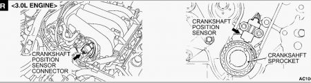

I wonder if your crank sensor or gear isnt defective...
Apr 26, 2009 at 1:34 AM
LYDIAA
  • 40 POSTS
[quote:bdbb44d21d="merlin2021"]I wonder if your crank sensor or gear isnt defective...[/quote:bdbb44d21d]
You know the guy from Chrysler had mentioned that but said its highly unlikely.. But I'm starting to wonder?? He said something about the crank sensor and the cam (?) sensor that one of them could be going out...
Whats making this harder to figure out is my car is not having any symptoms at all.. Also the Chrysler guy never did come back to change the fuel injector (which I really don't think is the problem, we've already changed it and switched it around to different cylinders and the misfire always stayed in cylinder #1)..

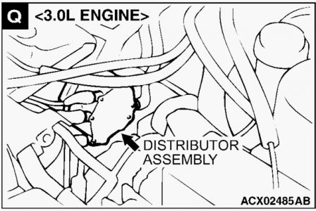

Only three possibilties left, Crank sensor or tooth, distributor section, or an as yet unknown PCM problem, just waiting for a new flash update!
https://images.2carpros.com/forum/automotive_pictures/62217_Sebring30_1.jpg
https://images.2carpros.com/forum/automotive_pictures/62217_Sebring301_1.jpg
Apr 26, 2009 at 4:08 AM
