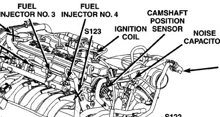

my car recently started surging once the car reaches 2400 rpms regardless of what gear i am in. I have changed the ignition coil and i have had new plugs and wires put in. i also noticed that when the ignition is in the on position my cruise control lights up like it should, but when i actually have the car running ...there is no cruise light on the dash and it doesn't work. any ideas would be helpfull

you need to check and replace cam sensor

and still have code p0344
you need to check the wiring harness

ok thanks but would you know exactly where i should start, or could it be anywhere in the wiring harness

Unplug cam sensor and check plug and wiring
using volt meter check for volts supply
check for a ground
Brown is ground (behind center of dash
blue/yellow is terminal #56 at the PCM
red is power and connect to injector wiring harness
