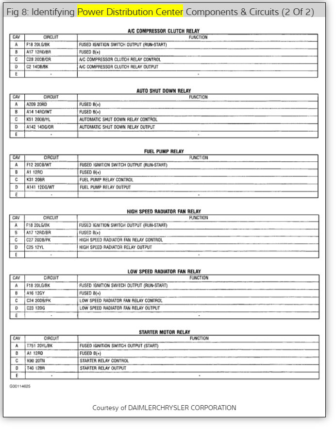

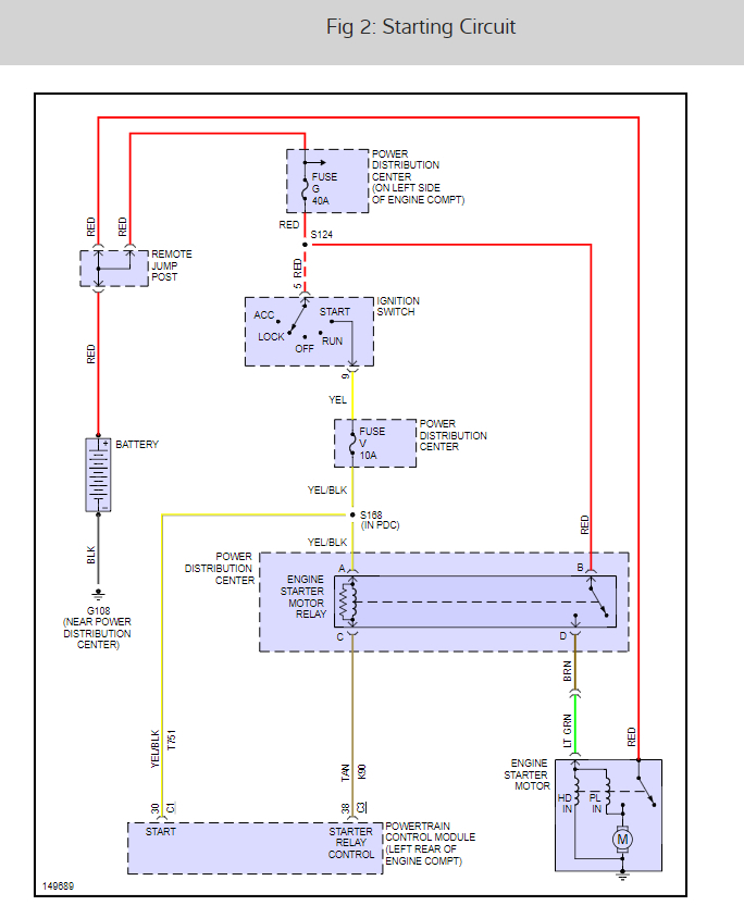

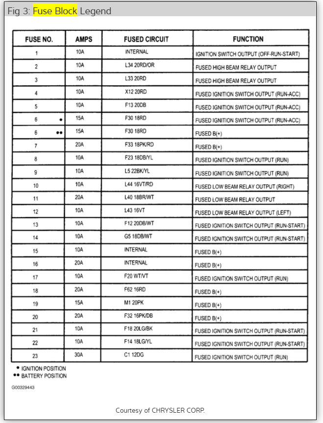

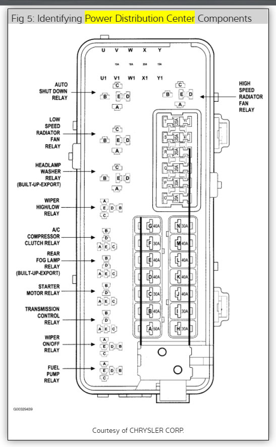

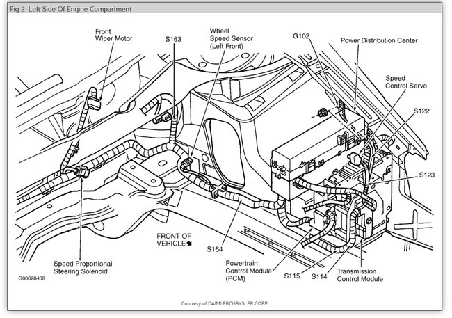

KRISSY BAKER
My 2002 chrysler concorde (2.7L) won't start. We put in a new battery, starter, shift solenoid (it would have a seizure and cause the rpms to jump up way high when decelerating), spark plugs, and starter relay fuse. It still does not want to even try to crank now (and it was trying to last week and then it would die before fully starting). When the key is turned, it makes a clicking noise in the fuse and relay center and a high pitched but low sounding wine of some sort near the spark plug area. What could I do to get it to start? There seemed to be an effect on ignition when a wire was slightly jiggled under the drivers side in front practically behind the head lights area, could it maybe be loose? I accidentally curb checked after mistiming a turn and it started having issues after that. Oh, and I have less than 120,000 miles on this car
Wednesday, December 6th, 2017 AT 4:57 PM
KEN L
  • MASTER CERTIFIED MECHANIC
  • 48,363 POSTS

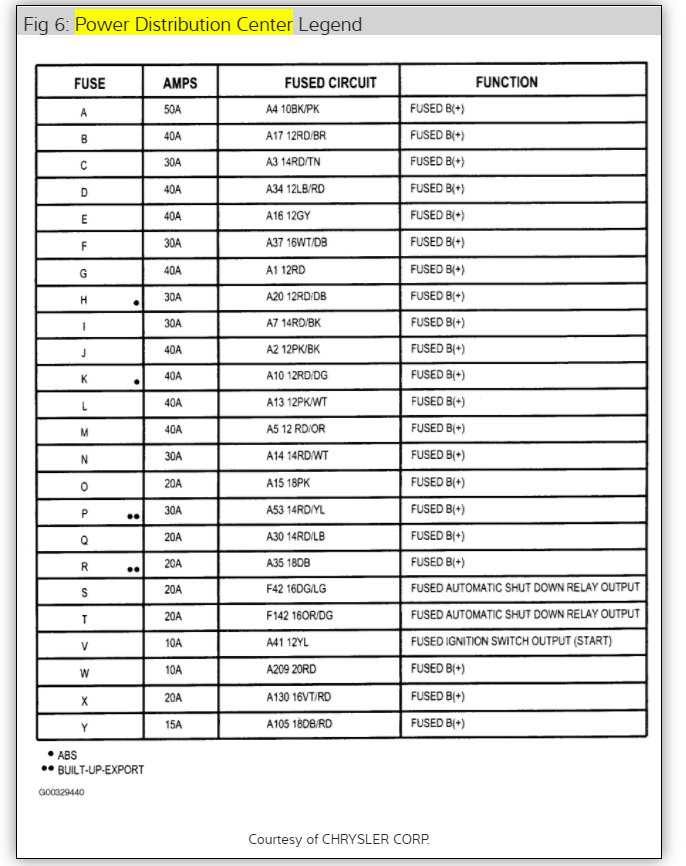

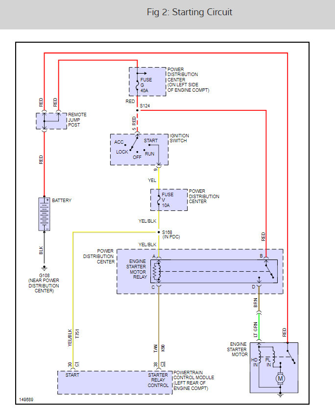

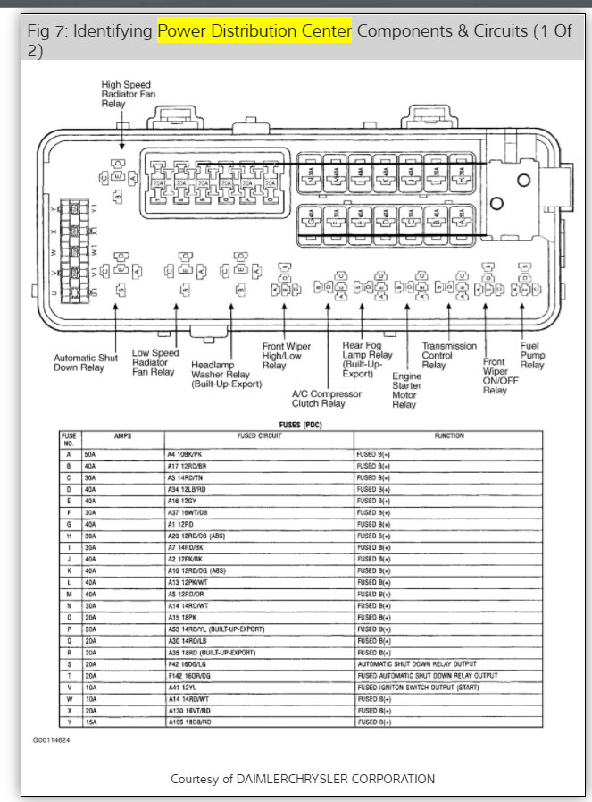

When you are trying to crank it over does the security light flash? If not we need to do a little testing to see where you are locing the power signal at.
Here is a guide that will help you see how to test for power (easy)
This is to test a relay (little tougher)
and
Here is a starter wiring diagram
