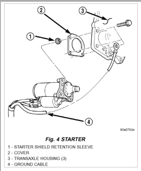

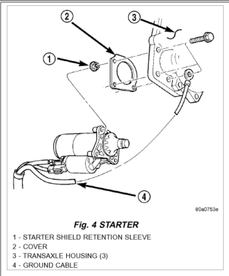

It sounds like you have a starter motor that is out and needs to be checked to confirm the failure which can be done with the test light.
Here is the test you must toward the bottom of the guide
If you do confirm the starter failure the gisue will give you an idea of what you are in for when doing the job.
Here is what it will be like on your car (below)
Cheers

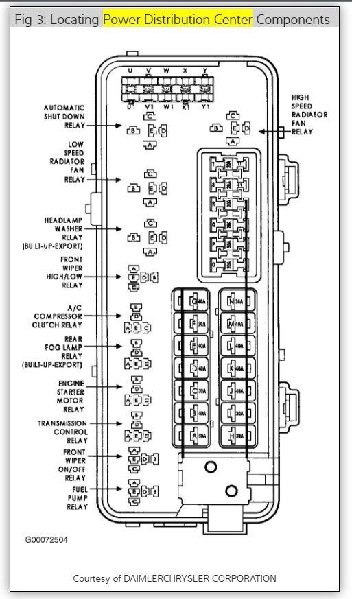

I have a 2.7L 2000 Concorde that already had the timing fixed.
I have an intermittent starting problem. The engine won't turn over after it has been driven for some length of time. But if I leave it alone for to cool off, it turns over and starts. I have replaced the starter, thinking it is getting hot, because it has a heat shield on it indicating to me it might be an issue but that's not it. I am going to check the battery, but the lights don't dim when I try to start it, so I would believe it is OK. I am going to check the connections from the battery to the starter also, but I am not too confident either is my problem.
I don't hear any clicking underneath when this happens. My guess is that it might be a relay someplace near its end, and is getting affected by the engine heat.
Any help or experience with this is greatly appreciated.
Thanks ahead of time.
Nov 22, 2017 at 10:02 AM (Merged)
2CARPRO JACK
  • 11,533 POSTS

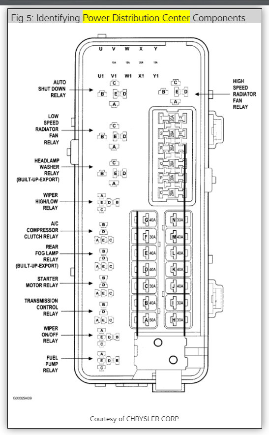

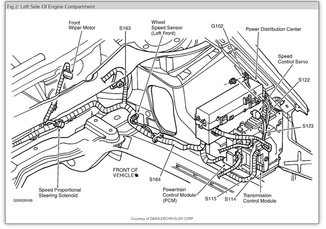

That car has a starter relay located in the under hood power center. it could be the problem. Does it have 12 volts at the small wire on the starter when it wont start? if not I would suspect the relay may be bad. You can also check the yellow wire out of the ignition switch to be sure it is triggering the relay to start with key in crank position

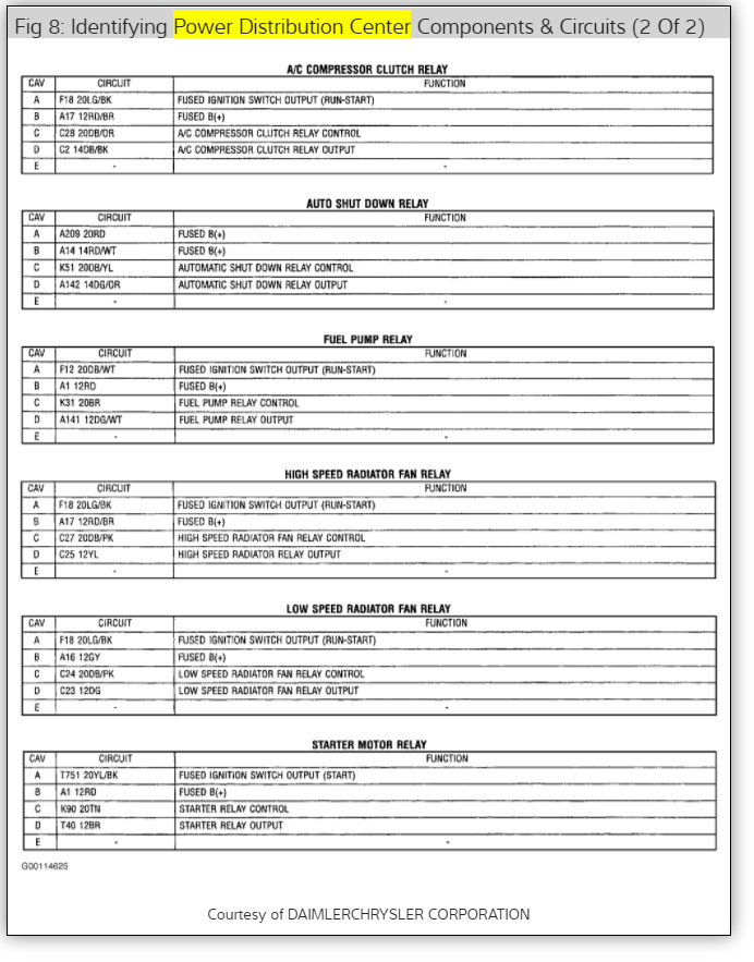

I'll try to help. If you can jump the relay, that tells me there is power there. Have you tried a new relay?

CARADIODOC
  • 34,382 POSTS
You're right, there is no ground wire. The injectors and coils are fed 12 volts from the Automatic Shutdown relay. The grounds are switched on and off by the engine computer to fire them.
The 12 volts to the coils and injectors comes from the ASD relay for 2 seconds after turning on the ignition switch, then it turns off. It turns on again when the engine computer sees engine rotation, cranking or running. It knows this from the pulses from the crankshaft and camshaft position sensors.
Camshaft position sensors fail quite often. If you got one with the new engine, try using your old one. Crankshaft sensor air gap is critical. The dealer can supply a paper spacer to stick on the end of it, then you shove it in as far as it will go and tighten the bolt. The spacer will slide off when you crank the engine.
Measure for 12 volts on the coil or injector power wire while cranking. If it's missing, the ASD relay isn't turning on. Check the cam and crank sensors. If it is turning on, and you have spark, try giving it a little gas, (pressing the pedal). If it starts, but won't stay running without your foot on the pedal, it just needs to relearn minimum throttle so the computer knows when to be in control of idle speed. You do that by driving at highway speed, then coasting for at least seven seconds without touching the gas or brake pedals.

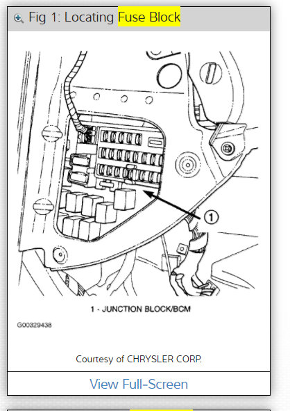

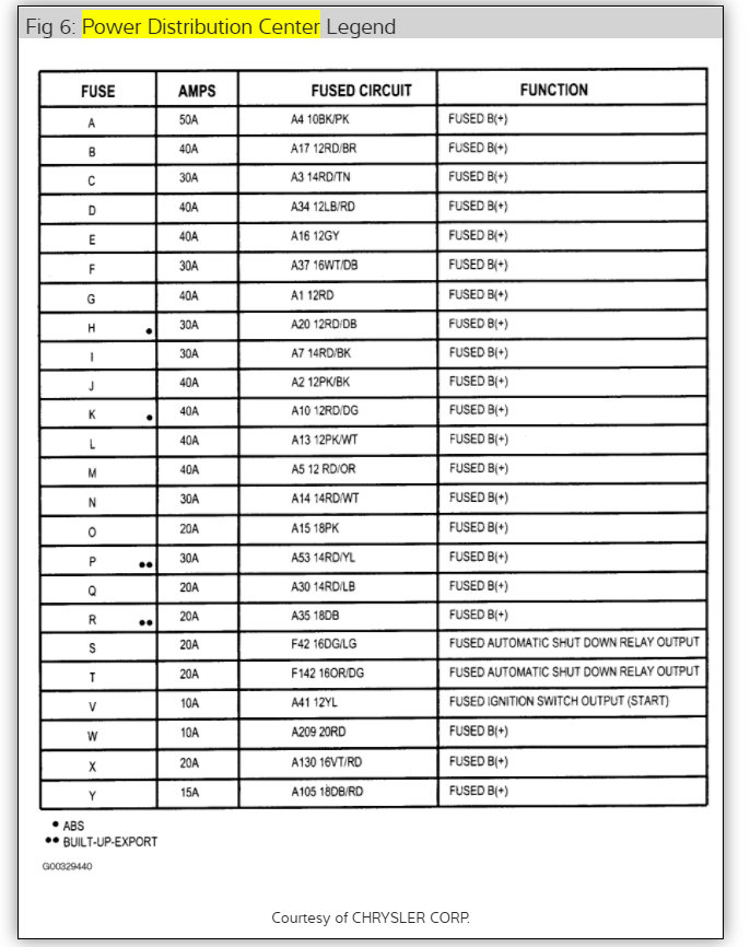

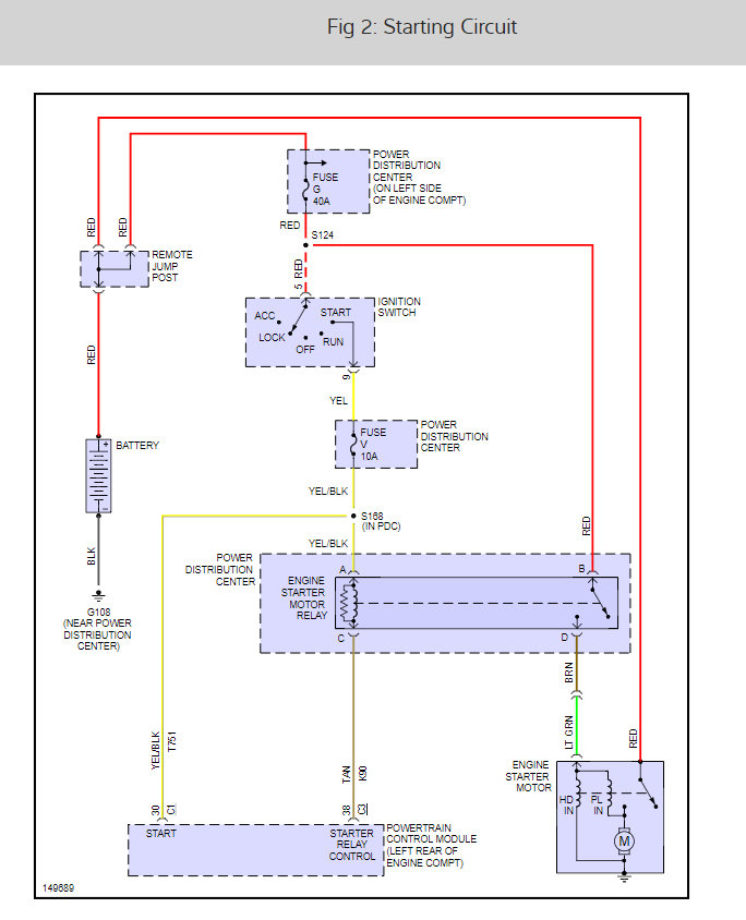

My 2002 chrysler concorde (2.7L) won't start. We put in a new battery, starter, shift solenoid (it would have a seizure and cause the rpms to jump up way high when decelerating), spark plugs, and starter relay fuse. It still does not want to even try to crank now (and it was trying to last week and then it would die before fully starting). When the key is turned, it makes a clicking noise in the fuse and relay center and a high pitched but low sounding wine of some sort near the spark plug area. What could i do to get it to start? There seemed to be an effect on ignition when a wire was slightly jiggled under the drivers side in front practically behind the head lights area, could it maybe be loose? I accidentally curb checked after mistiming a turn and it started having issues after that. Oh, and I have less than 120,000 miles on this car
Dec 6, 2017 at 8:57 AM
  • 55,433 POSTS
When you are trying to crank it over does the security light flash? If not we need to do a little testing to see where you are locing the power signal at.
Here is a guide that will help you see how to test for power (easy)
This is to test a relay (little tougher)
and
Here is a starter wiring diagram
Dec 8, 2017 at 9:59 AM
