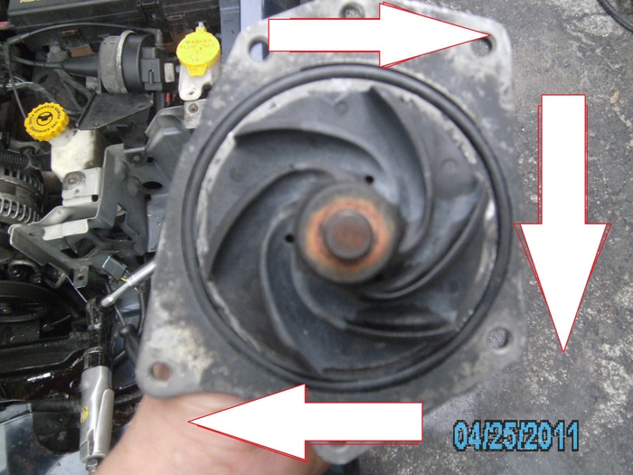

I attached a picture of my water pump and the way it is rotating... Isnt it going the wrong way? What can I do about this?

Nope. It's going the right way. The vanes throw the coolant outward and centrifugal force is what creates the force that makes it flow.
