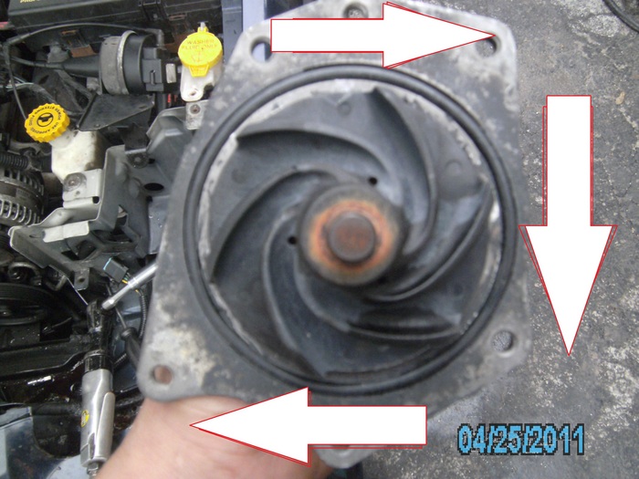

The radiator is a new one.
I attached a picture of my water pump and the way it is rotating. Isnt it going the wrong way? What can I do about this?

Nope. It's going the right way. The vanes throw the coolant outward and centrifugal force is what creates the force that makes it flow.
