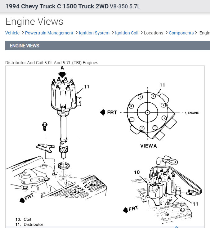

There is no spark coming out of the coil. So the plugs are not getting spark. And the truck wiil not start. Any answers?
Monday, January 18th, 2010 AT 1:52 PM
SQM
  • 6,383 POSTS

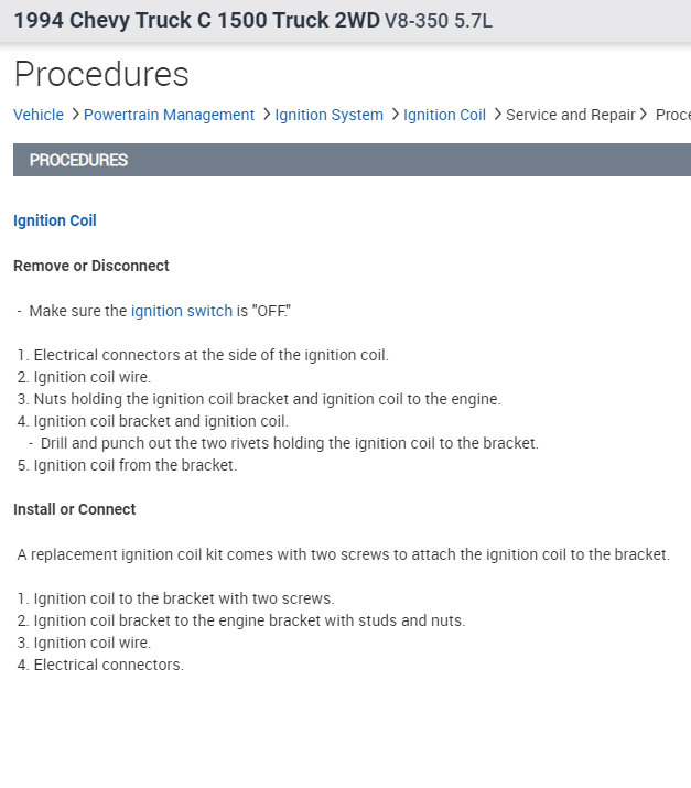

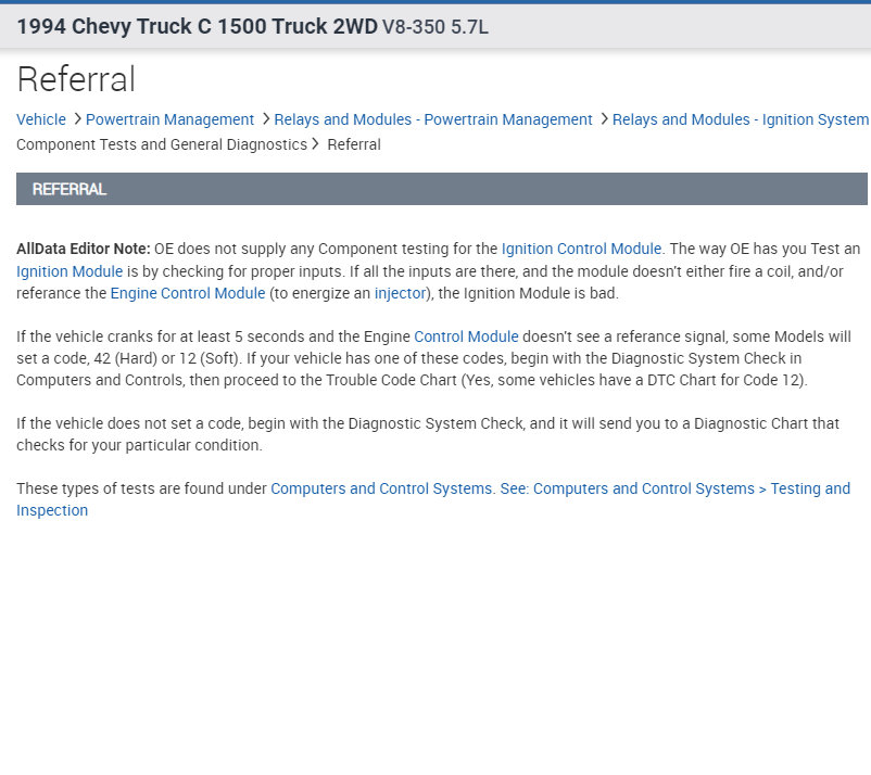

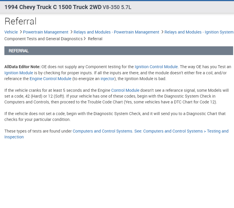

First check to see if you have power to the coil. The coil is not getting power it will not produce spark.
You can check for power using a voltmeter.

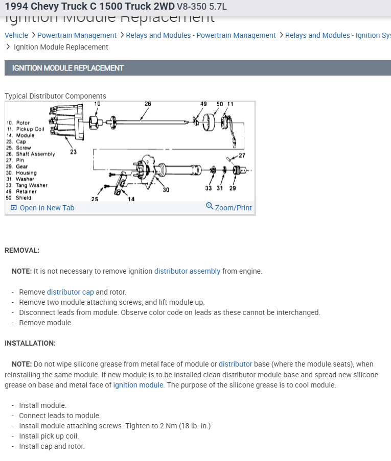

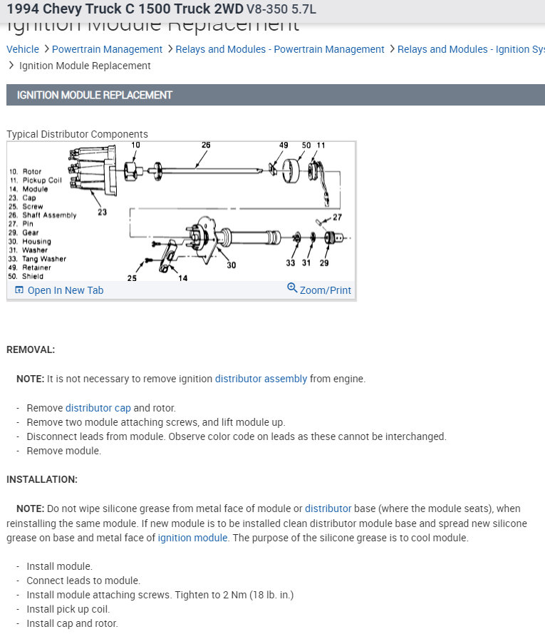

This could be also due to a faulty ignition control module.
And of course, you could have a faulty coil.
Take a look at this guide it covers on how to check the ignition system:
