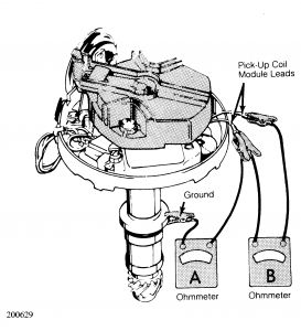

DOCFIXIT
  • 18,828 POSTS
OHM check pickup coil see diagram
https://images.2carpros.com/forum/automotive_pictures/198357_Graphic_543.jpg
A infinite resistence in B 500-1500 ohms

Check and test the distributor pick-up coil and air gap-also double check the cap and rotor contacts-if there's spark out of the coil-it should have spark at the plugs if cap and rotor good it has to make it out there to get to the plugs
