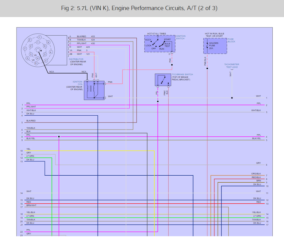

Truck was running fine one day and the next it wouldnt start. Lost fire. Check igntion module, Nothing. Check all fuses none blown. Have no blinkers either, But I still have all other lights and flashers. Dont know what to check now or where to start. No fire at the coil

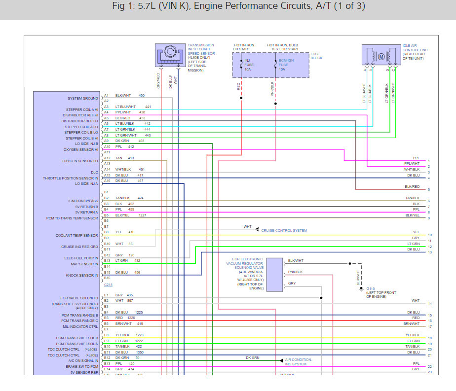

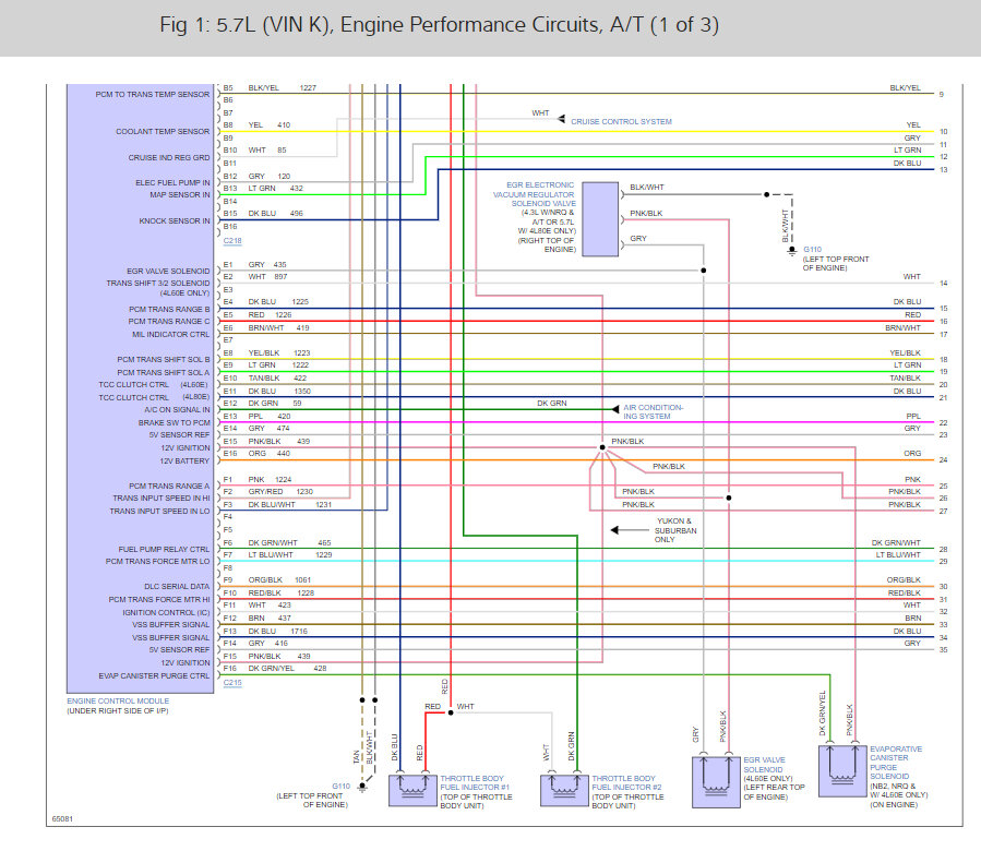

In engine compartment check Mini fuse ECM1 20 amp also test for voltage pink wire at injector.

At coil check voltage on Pink wire if good put test light on white/black wire crank does light flash?

I get nothing at the coil at all? Do I need to use my test light while tring to start it. Or just turn on the key?

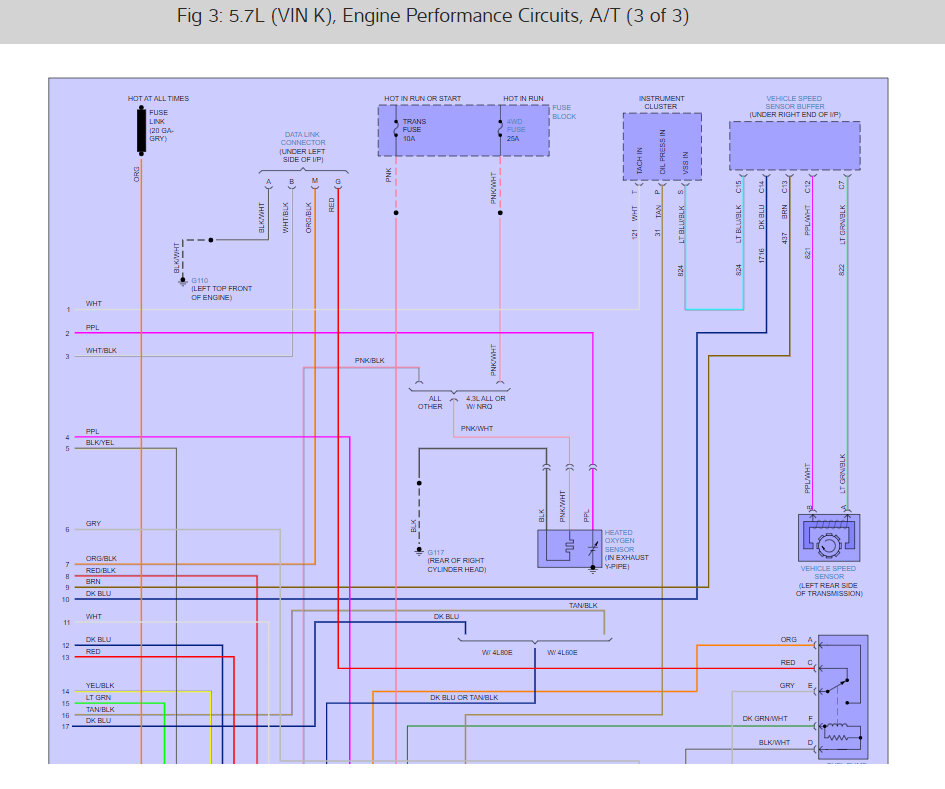

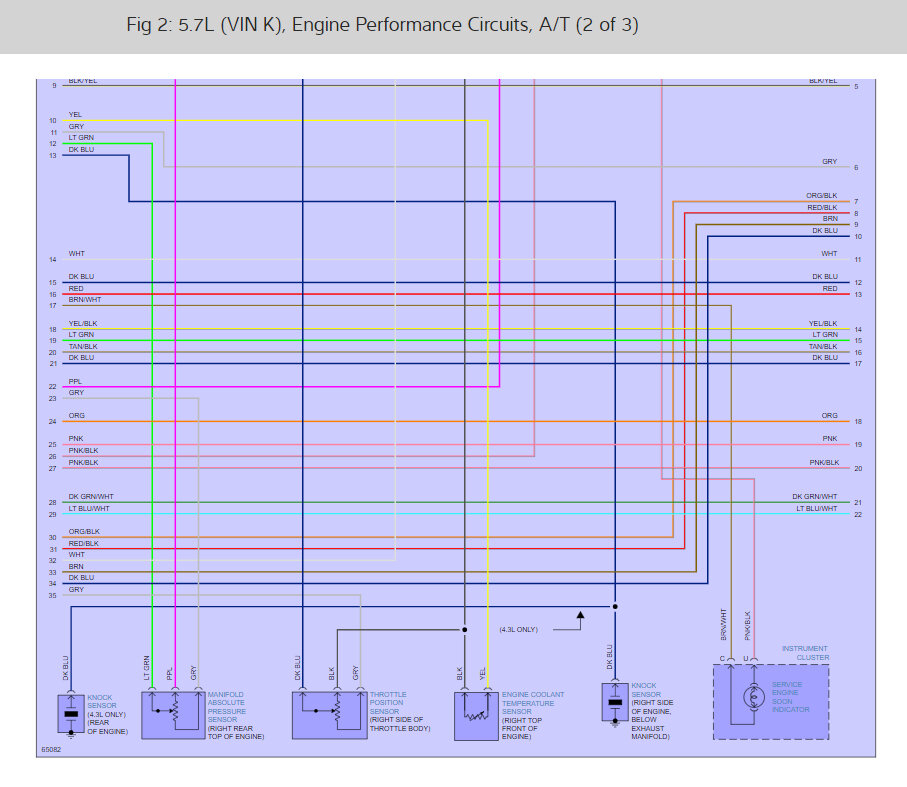

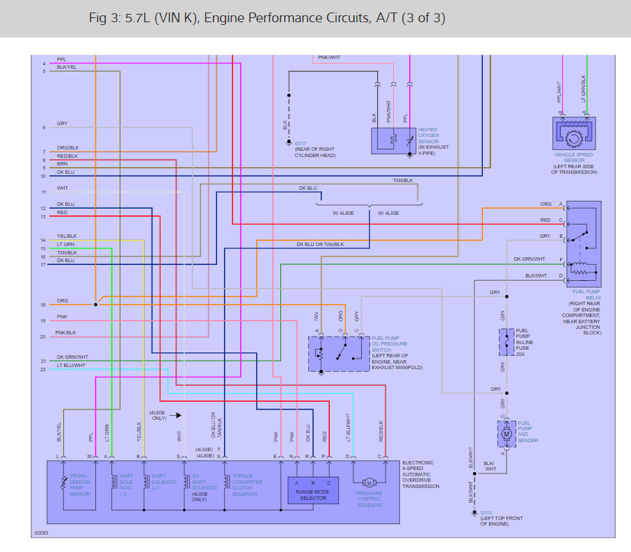

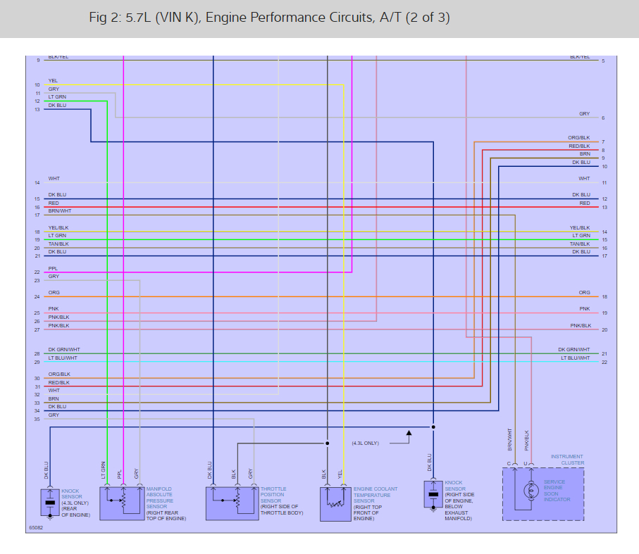

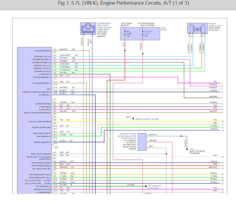

Key on check Pink wire that is same wire powered by ECM1 fuse as injectors. So if no voltage then something a miss in wiring. Here is a guide and the wiring diagrams so you can how how the system works.
