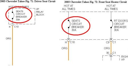

I have a 2005 chevy tahoe. Both heated front seats won't turn on. Possible fuse problem or something else?

Being an Auto Upholsterer,I have taken many seats,all kinds,apart.Upon removing the cover to perform a repair I have seen many heat grids with burnt wires[some with big burn holes in the foam rubber almost to the point of catching the seat on fire!].If it's not a fuse and theres power to the plug under seat I'd say thats your problem

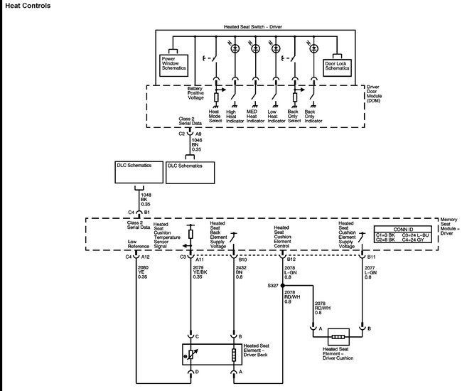

All of a sudden the driver's heated seat won't stay on - what do i need to do to fix that??

does the switch indicator still work? does the seat cushion's blower motor come on for at least a couple of seconds?
Jan 22, 2019 at 5:59 AM
(Merged)
when I push the button the light comes on and you can tell it is starting to heat up and then after about 1-2 minutes it shuts off. As far as a blower I guess I cannot hear anything when I try to turn the seat on - I guess I didn't know it had a blower. One time it actually stayed on altogether but every other time it turns itself off.
(Merged)
ok, seems like your DSM is faulty, the DSM is the driver seat module that controls the seat heater.

GM has a lot of problems with their heated seats. The most common problem is with the control module under the driver's seat. This module works on a "resistance timer" that controls the length of time the heat is turned on. You may want to have this module checked.
