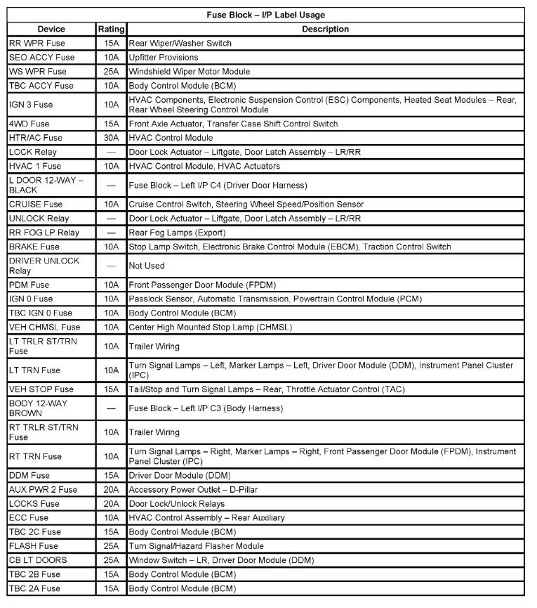

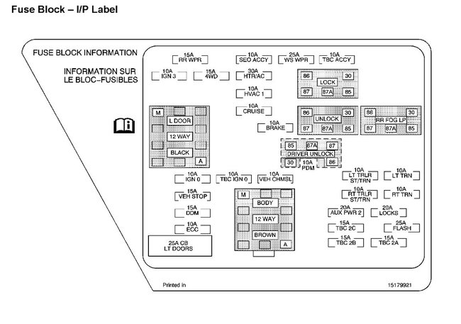

My driver electric seat stop working. I have checke the fuse box in the hood and the one by the door but all the fuse are Ok. is there any other fuse or what could be the solution to this problem?

Hello, did you check for voltage at the fuse circuit? Use a testlite. Let us know exactly which fuse you checked and the location. My info showed several fuses and a circuit breaker for the seat.

I have checked the one in the hood and the one by the door but i can not locate the breaker box

https://images.2carpros.com/forum/automotive_pictures/170934_07_chevy_tahoe_1.jpg
CB3 should be the circuit breaker for the driver seat. If you look at your owners manual, it should give you the fuse labels and locations. Again, did you use a testlight or something to check that the fuse circuit is hot???? Even if the fuse or circuit breaker is good, if there is no voltage to the circuit, it won't matter, the circuit is dead.

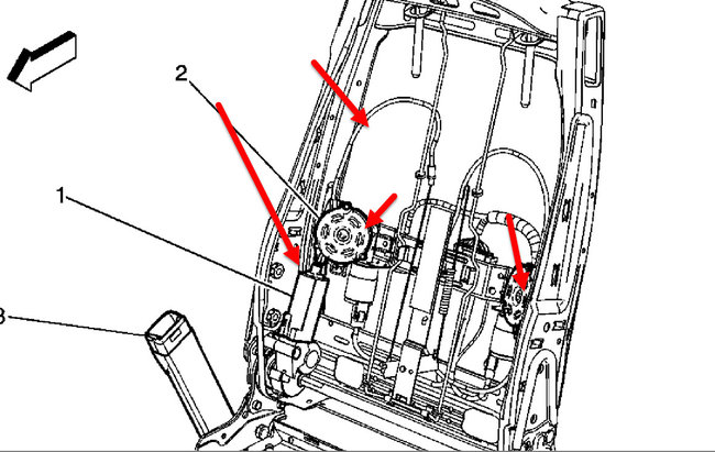

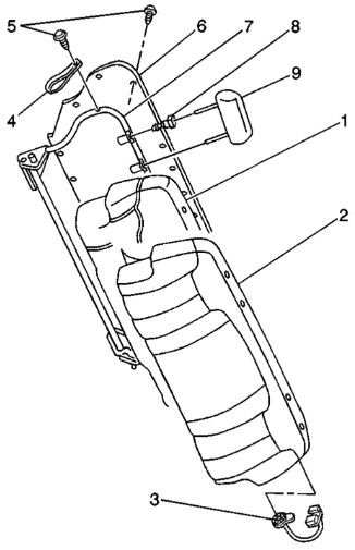

WRACHOR
When I press the circular button to adjust the lumbar, the lumbar position does not change. Although I hear a click each time I press down on a position (up, down, left, right).
Nov 27, 2020 at 10:51 AM (Merged)
HMAC300
  • 48,601 POSTS
if you can hear clicking it may be the gear is broken or cable or both. this has to have seat come apart and see what problem is. See picture.

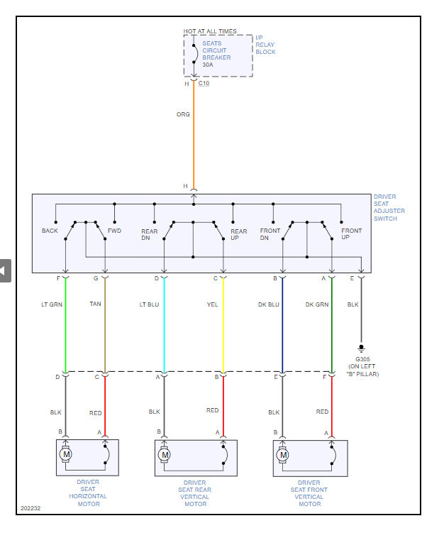

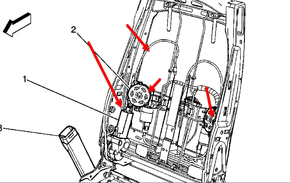

JSTAPP1220
The back lifter on my 07 Chevy Tahoe seems to be stuck or just not working. I can hear it click when I press the switch up and down, but it will not move. It would not be so bad if the seat was in a position that was tolerable, but it is cranked all the way in the up position and my head is almost touching the ceiling of the vehicle. I have also noticed that it seems to no slide back as far as I would think it should. All of the other functions work, the front of the seat lifts up and down fine. Thanks for any help in advance!
  • 75,992 POSTS
Inspect and test the driver's seat adjuster switch and ground circuit G303 at near base of left "B" Pillar
DJCL
  • 767 POSTS
If its making a clicking sound sounds like a worn gear or cable . I would remove the seat and do a good inspection under it.

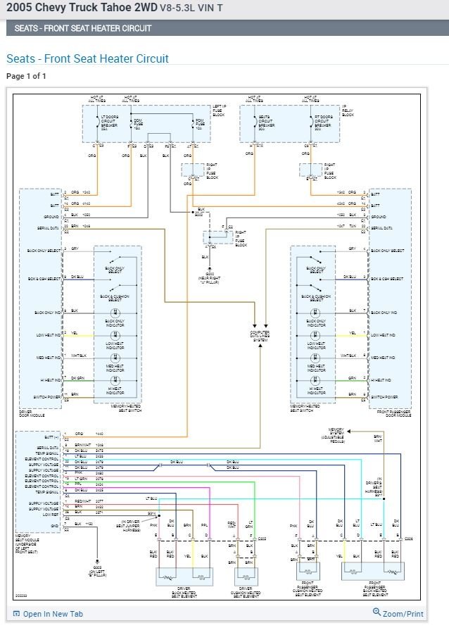

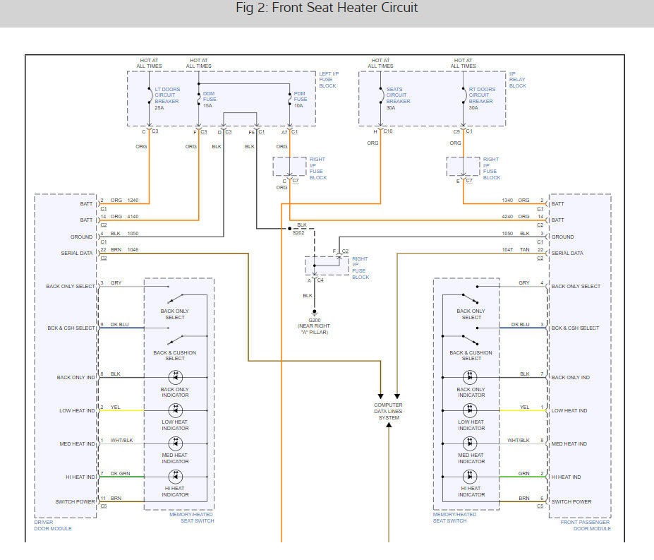

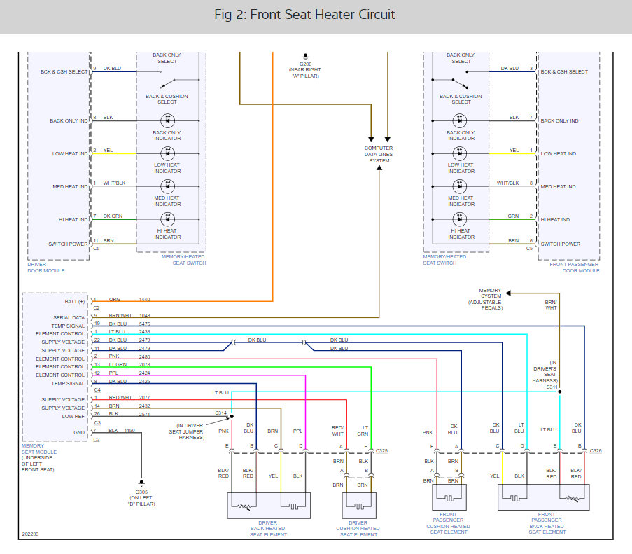

SAMANTHAJ
The heated/power seats are run off circuit breakers for the most part. There are two fuses in the interior fuse panel (DDM and PDM) that power the drivers side and passenger side door modules. Check the guide below on testing wiring and the diagrams for the seat wiring. Let us know what you find.
Check out the diagrams (Below). Please let us know what you find. We are interested to see what it is.

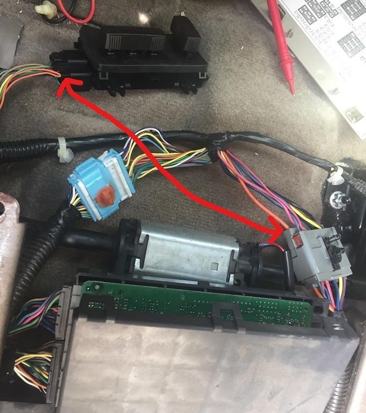

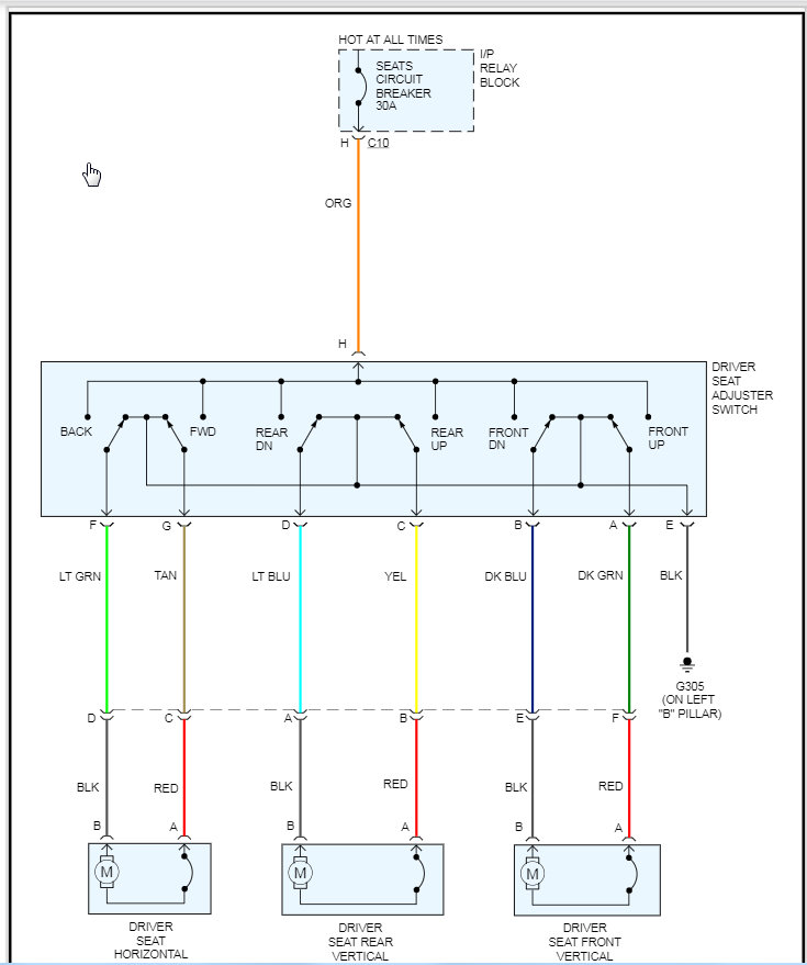

KEN LUDDEN
By not working I mean no movement for either the direction switch or the lumbar switch. However, the memory mode selection switch 1 - 2 does work and the seat changes position between the two. Also, the seat heater works. The passenger seat works fine. I've already replaced the switch, checked the fuses, and cleaned the contacts on the control module under the seat.
Update: I've made some progress. The image attached shows that if I run a jumper between these two points the seat works. The main harness orange wire carries 12.4 volts, but the orange wire voltage is only 11.5 at the switch. Any insight on what the problem may be?
Nov 27, 2020 at 10:52 AM (Merged)
KEN LUDDEN
Image:
You have resistance in that wiring from these two points. It appears that is from the main connector to the switch? If you are getting lower voltage at the switch then I would just cut the orange wire between those two points and make your jumper wire permanent. If you want to confirm this you can disconnect those two wires and measure resistance but you pretty much have already confirmed it.
Normally we are giving instruction to do what you have already done so you have already figured this out. So again, I would just make your jumper wire permanent by cutting the wires and splicing on the new wire. Let me know if you need help with that.
Good work!

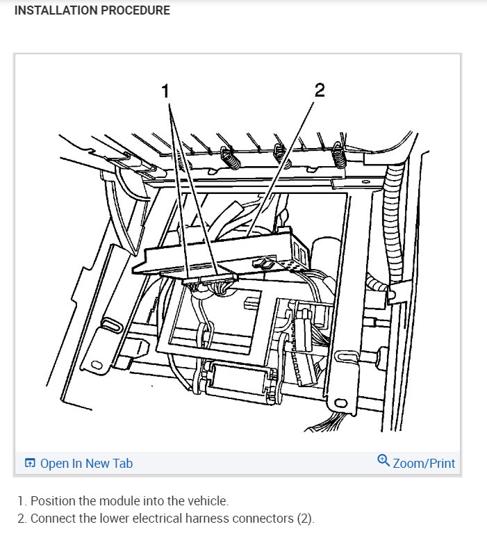

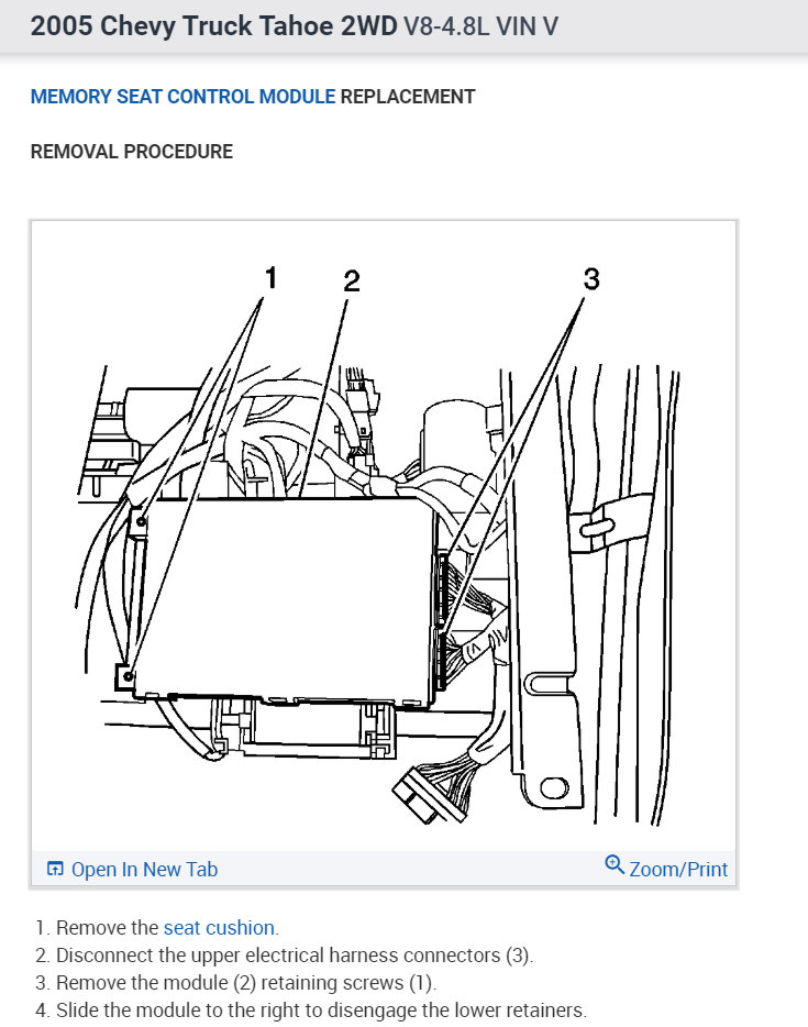

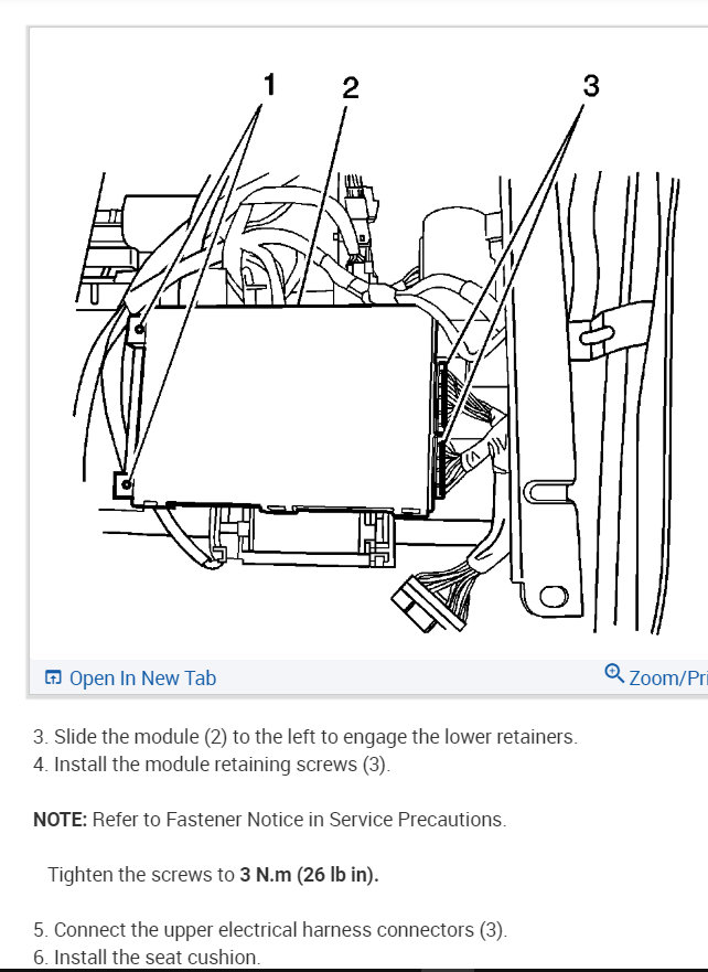

CLK5128
I have a 04 Tahoe Z71 and the passenger side windows stopped rolling down, the heater's for both of my seats stopped working and I can not adjust the driver and passenger side seats. I can roll down the driver side windows and the power door locks work fine. I looked at the fuses and everything looks ok. Anyone have an idea??
Nov 27, 2020 at 10:53 AM (Merged)

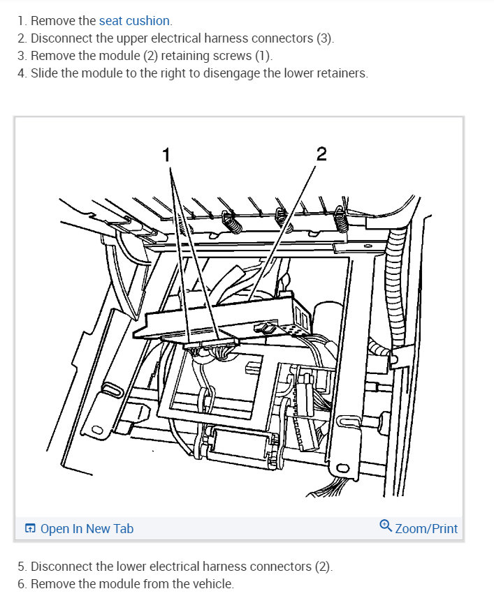

RACEFAN966
  • 5,029 POSTS
It sounds like you need to replace the seat control module which go out here are the instructions on how to so so in the diagrams below.
MEMORY SEAT CALIBRATION PROCEDURE
The memory seat module uses position sensor inputs to establish soft stop locations for the adjuster motors several millimeters ahead of the physical limits of the adjuster assembly. After replacing a memory seat module or adjuster components, it may be necessary to reset the adjuster motor soft stop locations. When the repair procedure has been completed, operate the seat adjuster switch in every direction until the seat adjuster reaches its mechanical hard stop by repeatedly pressing and releasing the switch as necessary.
Check out the diagrams (Below). This fixed my Tahoe.

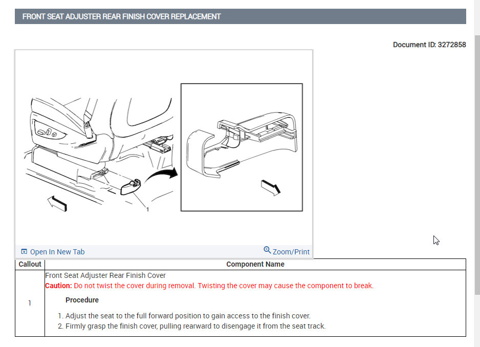

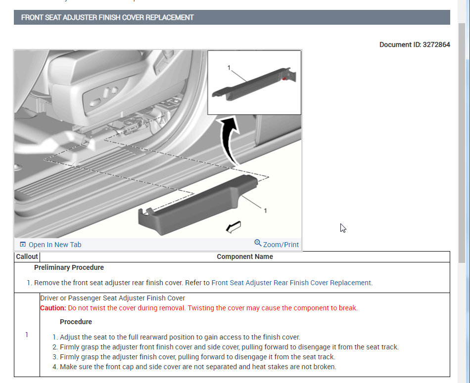

Hi! I went to put my the seat back on the drivers side of my 2019 Chevrolet suburban so my husband could fit in. When I put the seat back it stopped and sounded like it was hung up on something. I tried the forward and it would go forward just slightly. I tried backwards again and it seemed to be moving on one track side(near the outside) and the inside was stuck. Well lo and behold a little plastic child toy from my three year old had gotten wedged under the track on the inside. So I was able to pop as take it out/forward with a screwdriver. But now the seat will not go forward or backward. The seat does go up and down and the lumbar works. Is it possible a wire was popped out? I am not sure even what I am looking for. Please help!
Dec 2, 2020 at 10:35 AM
I think what happened is the motor is now bound up as one side moved and the other did not. These are meant to move in unison so when they don't they will bind.
I am hoping this is all it is and the motor is not damaged but we need to remove the seat track screws that hold the track to the floor and then try and move the seat. Be careful when you do this as the tracks are going to move and not the seat as they are no longer anchored but this is what we want to try and get them even again. So you want to move them all the way forward or backward so they are in the same position and then bolt the seat back down.
I attached the process for removing the access covers to get to the bolts.
Let me know what questions you have. Thanks
