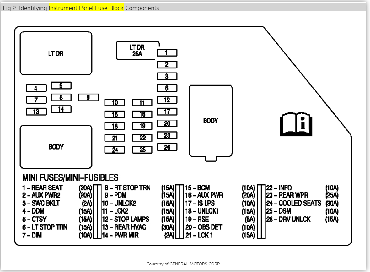

V8 four wheel drive automatic 55,000 miles.
I was traveling from Florida to New York when my driver side seat stop working. It was working find when I left Florida but when I tried adjusting it, nothing. I checked all the fuses and everything seems to be fine. Including the fuses above the brake pedal. I cannot even adjust the lumber. Luckily the seat is set for me but my wife is much shorter and cannot drive the truck until I fix this problem. Help! Thanks.

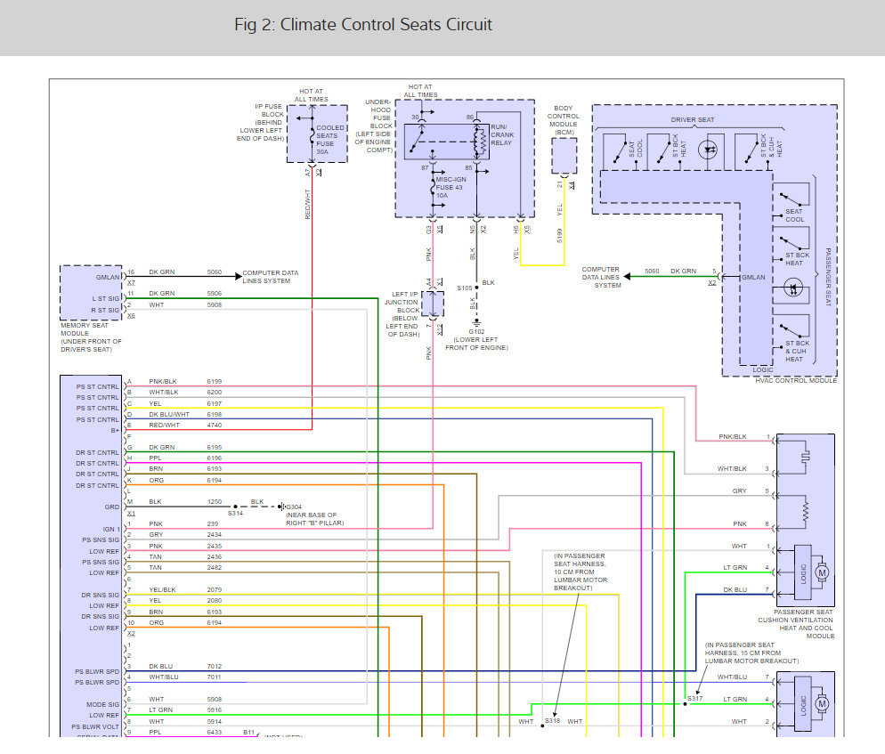

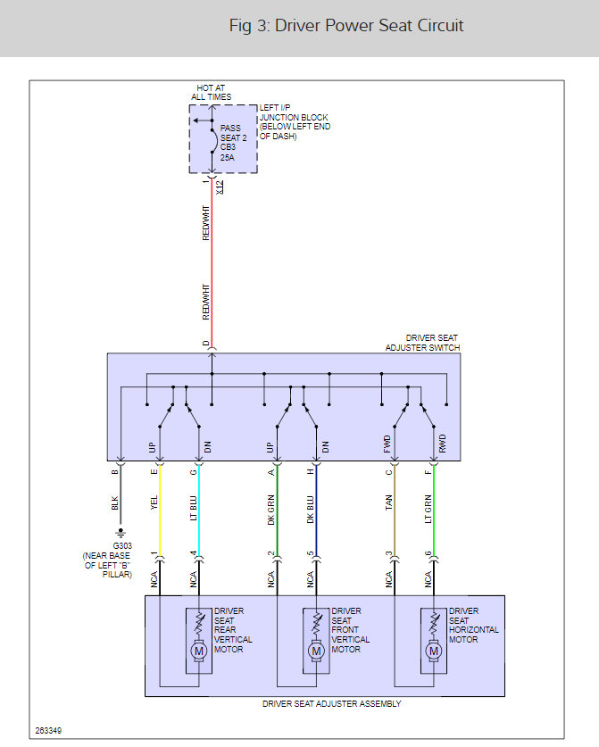

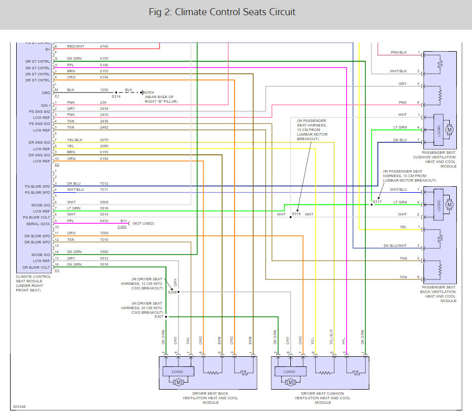

It sounds like the switch has gone out here is a guide to show you what you are in for when changing it out. Here is a guide to help us check the power wiring to confirm the problem.
https://www.2carpros.com/articles/seat-position-switch-replacement
and
The wiring diagrams are (BELOW)
Here is a bulletin that may relate, this assumes the seat is completely inoperative from seat adjuster switch, and memory switch. If you need procedure to remove seat cushion let me know.

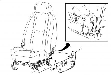

Please send me the instructions on removing the seat cushion. I will get working on this when I get home from work and let you know the outcome.

Here is what I have, hope it helps:
https://images.2carpros.com/forum/automotive_pictures/309872_1678374_1.jpg
Front Seat Cushion Outer Trim Panel Replacement (Power) Callout Component Name 1 Front Seat Adjuster Outer Finish Cover Screw Notice: Refer to Fastener Notice in the Preface section. 2 Front Seat Adjuster Outer Finish Cover Procedure Squeeze the tabs in the rear of the cover together to disengage the outer trim cover from the rear trim cover. Pull outward to release the retainers from the seat assembly. All your doing at this point is checking that the switch is connected fully. If it is still inoperative, reply back. Include also if this seat has the memory option.
Jul 8, 2019 at 12:13 PM

I took the seat cushion and noted that the seat switch is properly placed. Nothing still. I guess the next step is ordering a new switch. You asked if the truck had memory seats and the answer is yes. The truck is loaded with all the extras. I also should mention that the driver adjustable pedal is not working either. I checked the fuse and they seem to be okay. I do not know if this is also a factor but felt I should mention it.

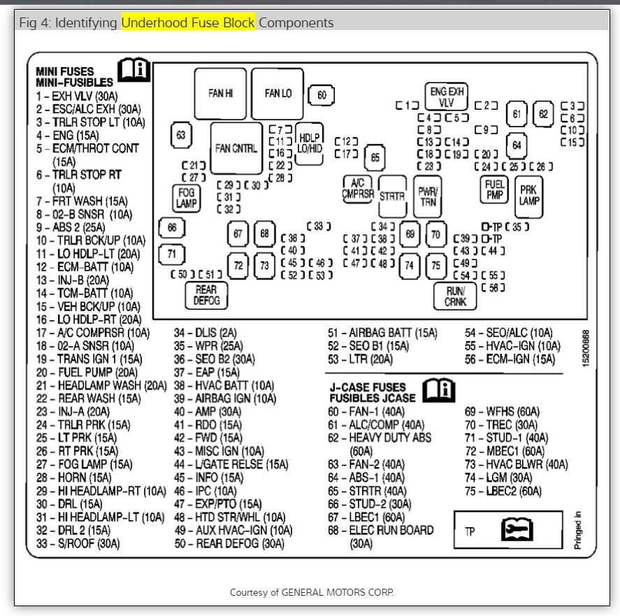

It is not the switch. If the power driver seat, and adjustable pedals are inoperative, these are all functions of the memory seat module. What I would try first, is to remove power to the memory seat module. You can do this one of two ways, disconnecting the module connector C3 a 6 pin brown connector, or pulling the DSM 10A fuse in the I/P fuse block. The module is under the drivers seat, the fuse panel is left side I/P. If you opt to pull the fuse, at least make a visual inspection of the seat module connections.
PRMAN1970
  • 10 POSTS
I have to travel out of the states today but I will make sure to take a look at it once I get back and will let you know. I think I pulled out the DSM fuse and it seemed okay, but I will check it again. I will also check the module as you requested. What should I look for while inspecting it? Thank you.
FACTORYJACK
  • CAR REPAIR CONTRIBUTOR
  • 4,159 POSTS
What we are trying to accomplish by removing the DSM fuse is just to pull power away from the module. If it is logic locked, this will potentially clear that and resume operation. When inspecting the module, check for partial, or otherwise poor connections. You can even disconnect and reconnect the connectors.

I still have not fixed mine. However, I have noticed that if I get in the car after it has been parked, it will almost always work until I start it. Once I start the car, the power seat stops working.
KSARBAU

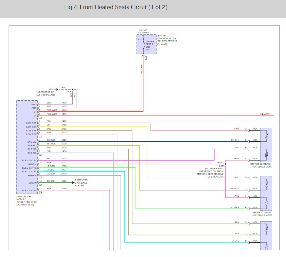

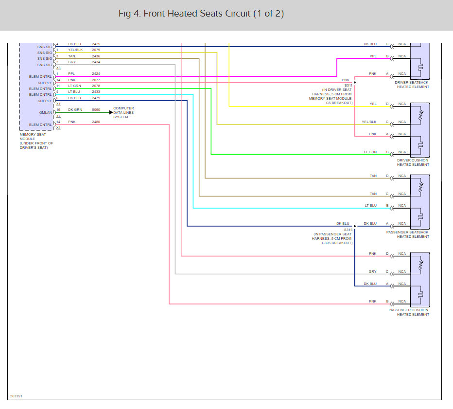

Update: I confirmed all connections are tight and voltage is as expected on various wires. I also confirmed that none are getting pinched or there is no flexing under the seat when I sit on it that is interfering with any connections.
I have now noticed that the power seat control works 100% when I am not sitting in the seat. When I sit in the seat, it cuts out immediately. When I lift my ass up off the seat, it works again within one or two seconds. When my wife (much lighter weight than I) sits in the seat, it works fine.
My new theory is that a short in the seat heating element on the cushion is interfering with the power seat controls. Could that somehow interfering with the memory seat module?
Is there a way that I can disconnect the seat heater element without removing or significantly dissassembling the seat? Does anybody know which wires under the seat would control that?
I am excited really hope I am on to something here. :-)
RIVERMIKERAT
  • 6,110 POSTS
There is a ground for the heated seat circuitry located at the base of the left "B" pillar. You can also pull the fuse for the heated seats. It appears to actually be a circuit breaker, 25 amp, labeled CB3, in the main instrument panel fuse box.
