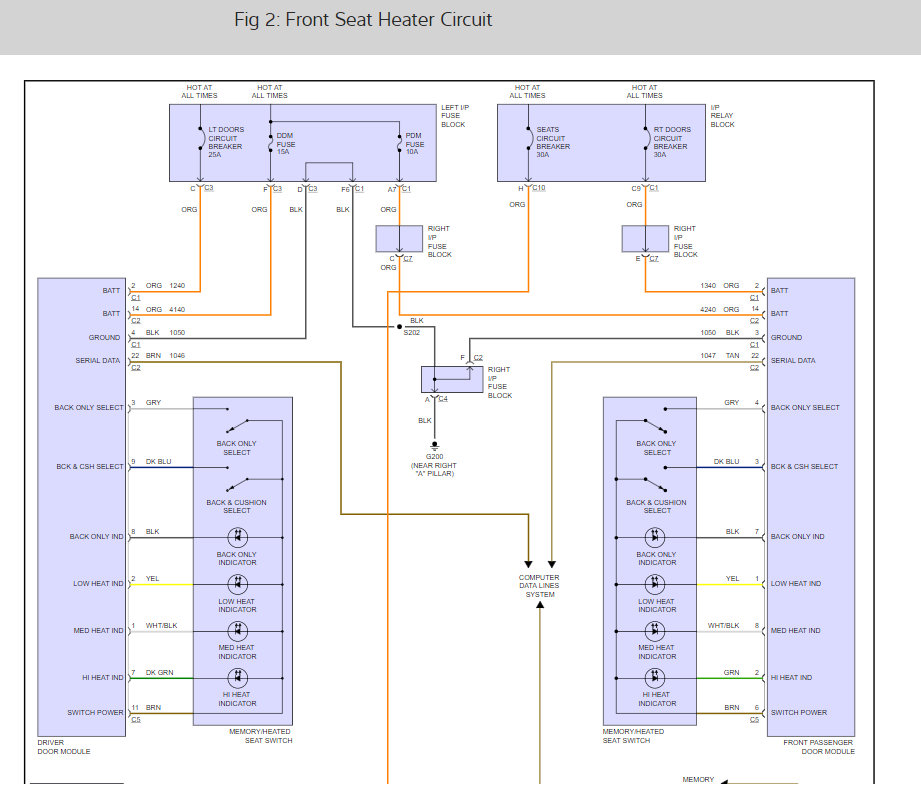

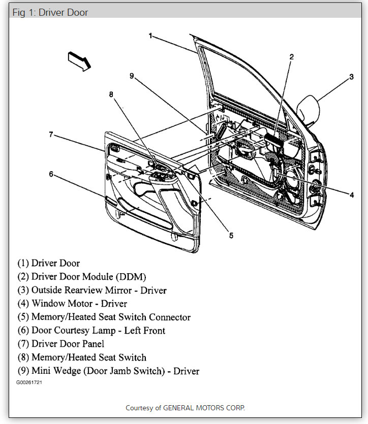

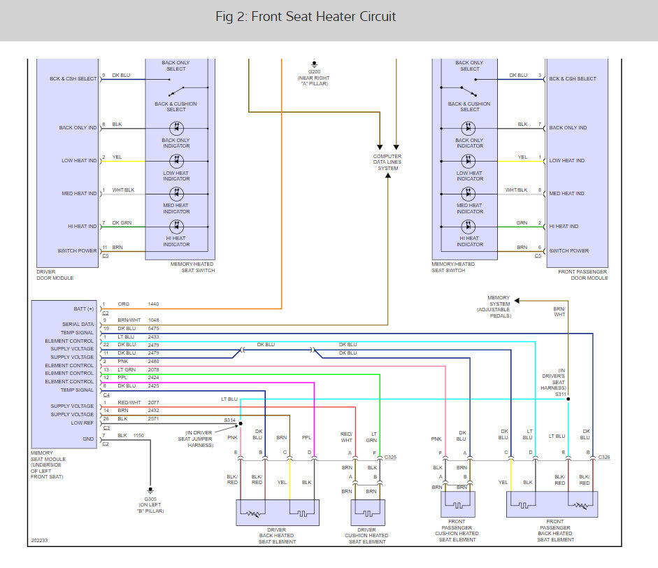

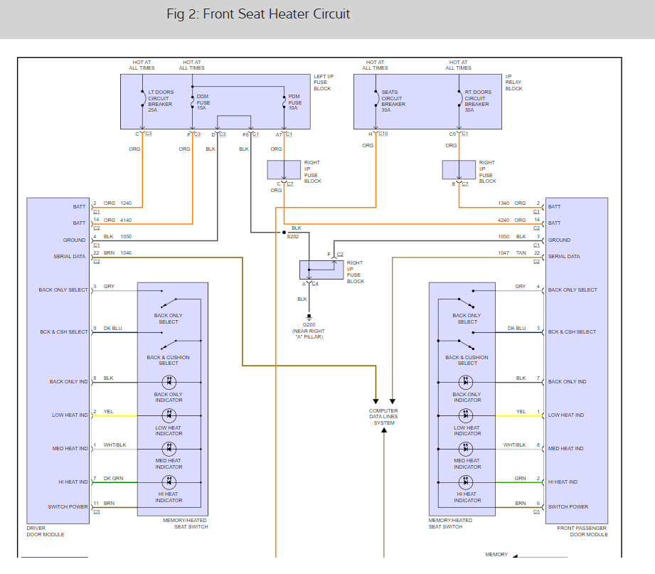

Both front seat heaters quit working & the drivers side power seat quit at the same time? The power adjustments work on the passenger side but the heat does not, on the drivers side both heat and power adjustments don't work. It all quite at the same time. I'm guessing it's a fuse but the owners manual isn't clear on which fuse supplies power to these applications and I don't understand why the power adjustments work on the passenger side only.
Feb 3, 2010 at 12:55 PM
BLUELIGHTNIN6
  • 16,542 POSTS

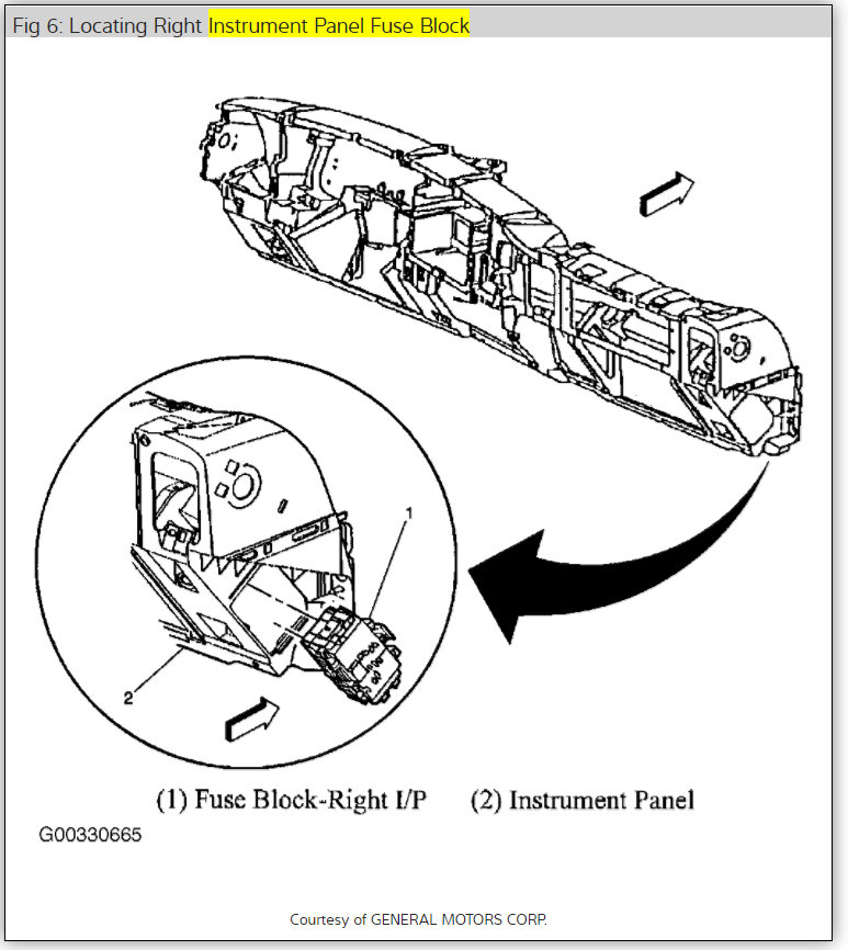

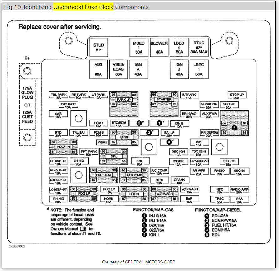

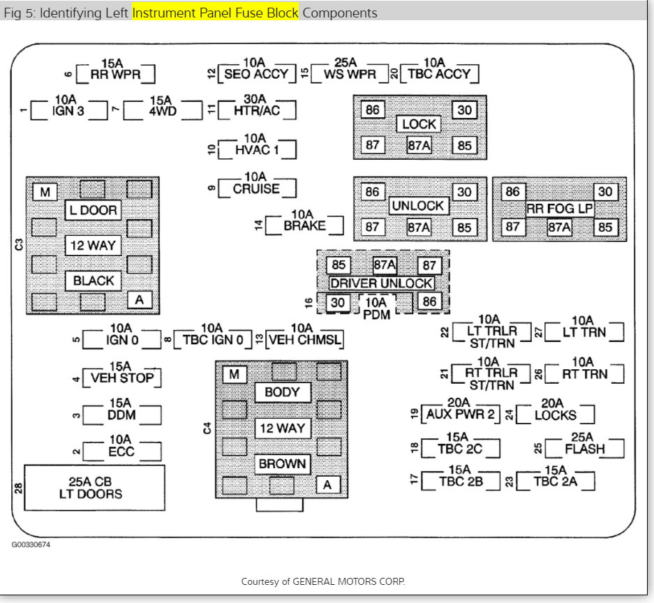

It sounds like the DDM has gone out which is common but we should check the fuses first here is a guide to help us get started with the locations of the DDM fuses and the drivers door module. Also I have included the wiring diagrams so you can see how the system works.
Check out the diagrams (Below). Please let us know what you find. We are interested to see what it is.
Feb 3, 2010 at 2:01 PM
MM5924
Tested ok and it does have the memory style seats. The indicator lights do not come on at all when the button is pushed.

Okay, seems this is a common problem with the newer Tahoes. There is actually a TSB (techincal service bulletin) about this issue. Most likely the driver door module will need reprogrammed, however, you need to have the driver door module scanned by Chevrolet dealer to see if it has to be completely replaced or if it just needs reprogrammed.

MM5924
I found the DDM was bad it cost me $340.00 to get it fixed FYI

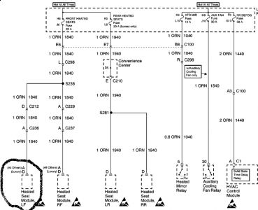

my driver side heated seat is not working i have power going to it
Jan 22, 2019 at 5:58 AM (Merged)
MATHIASO
  • 1,209 POSTS
Hello chevy1999tahoe If there is power to the module but it still not working , the module need to be replaced
https://images.2carpros.com/forum/automotive_pictures/46384_0996b43f8024b9d2_3.jpg
I'm sending the wiring diagram to your email.

CHEVY1999TAHOE
  • 8 POSTS
How I know if the module is working and what should the heated element read when I check them
MATHIASO
  • 1,209 POSTS
Lets start from the beginning.
My understanding of the first post was that the driver side heated seat is not working and you have power going to it.
What happens when you push on the button (switch) for the driver heated seat?
The driver and passenger side heated elements share the fuse 20A in the fuse box. If only the driver side is not working, then the fuse is o.k. you can try to unplug the connector to the heated element under the driver seat and while activating it (pushing on the button) check with test light if there is power at the connector.
If there is no power, the problem is with the switch or the wire from the switch to the connector is broken.
If there is power, the heated element is defective and will need to be replaced.

CHEVY1999TAHOE
  • 8 POSTS
i have power to the switch i have 0.9 ohms at the purple and black wire
FACTORYJACK
  • 4,159 POSTS
Disconnect the body harness to seat harness connectors at the rear of the front seats. Check for heat damage, or otherwise a poor connection. At this point a wiring repair will be needed, with new terminals and connector body. If you find nothing at the seat to body connectors, and it has drivers memory seat, check the connections at the memory seat module.
MATHIASO
  • 1,209 POSTS
Hello chevy1999tahoe _
good job
Remove the connector to the switch with engine off, check continuity on the switch(where the black and purple wire connect)
if you get infinite resistance, replace the switch.

i put the driver side switch in the pass side and it work on the pass side
FACTORYJACK
  • 4,159 POSTS
The fact that it is experiencing concern with both seats, I would suspect a connection issue at either the driver/passenger seat to body harness connector, or the seat module. There is no relay, nor an independent seat heater module. Both seats share a common power, and a common ground through the memory seat module. The way the system works, is the heated seat switches are wired to the respective door modules, and the door modules send bus messages to the seat module for operation. Open/high resistance elements, could cause this concern. but you would have to have at least one on each seat.

CHEVY1999TAHOE
  • 8 POSTS
i replace the switch from driver to pass and the switch the module and check for power and i have power check the resistance on the purple wire and black wire and i got 0.9 ohms i read online that if 1 element is out they both do not work

CHEVY1999TAHOE
  • 8 POSTS
i swap the switch amd module and the pass still works i check for power i have power i check the heater element on the back of the seat the purple and black wire resistance is 0.9 with it unplugged
MATHIASO
  • 1,209 POSTS
you need a new heater element on the driver side.if there is power to the element but it does not work.
Replacing the element will solve the problem.
CHEVY1999TAHOE
  • 8 POSTS
I have 2 heated element so I have to replace both of them
MATHIASO
  • 1,209 POSTS
Yes, replace them and that should take care of the problem

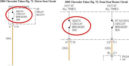

KWIN
heated and power seat on driver side, dont work.
ZACKMAN
  • 4,202 POSTS
https://images.2carpros.com/forum/automotive_pictures/55316_03tahoedrvseat_1.jpg
Check the circuit breaker...
