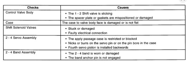

Changed transmission and it won’t shift, can only shift manually 1st to 2nd and speedometer doesn’t work. I have changed speed sensors and shift solenoids.

The speedometer not working is most likely the issue. Is there a code set for that?
I attached some issues if it was internal.
Please give me as much background information that you can.
