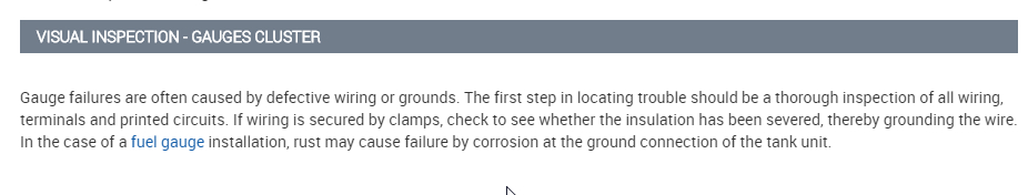

If each of these items are not working then we need to start with inspecting the cluster for wiring issues and if none are found then I suspect the cluster is the issue. Each of these items has a different input for the cluster to display them and if they are all incorrect then the common denominator is the cluster.

I'm pretty sure the sender on that is a single wire at the driver's side front of engine down by the exhaust manifold. It can get heat damaged and the connector can get an intermittent or, as in your case, a dead open condition. Make sure you replacced the correct sender/connector. To test it put the wire to ground and the gaufe should peg out.

Check all the fuses to make sure none are blown. Then check the electrical grounds make sure they're clean and connected to the vehicle's body.
