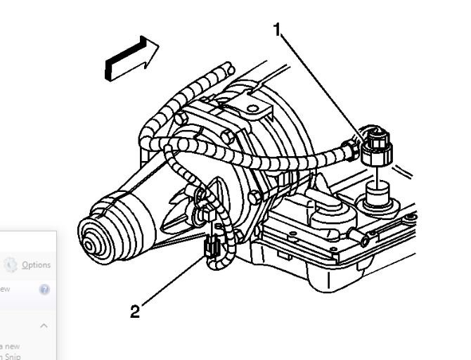

I looked down and the speedo was not working and the transmission started shifting funny what's wrong?
Dec 14, 2009 at 1:18 AM
  • 55,065 POSTS

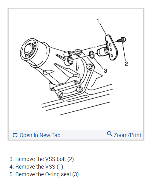

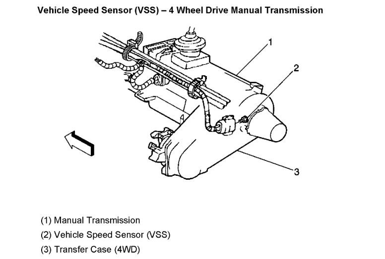

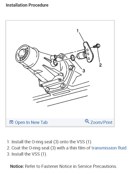

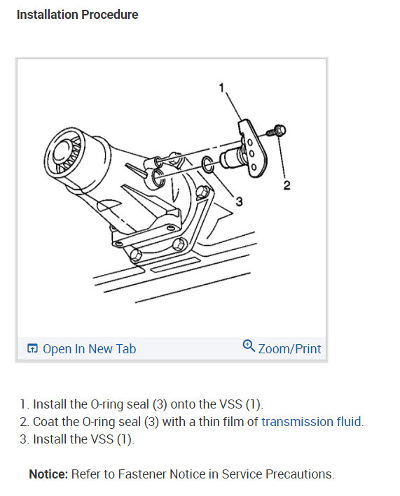

This is common when the vehicle speed sensor goes bad. here is the location in the diagrams below so you can fix it. Check out the diagrams (below). Let us know what happens and please upload pictures or videos of the problem.

I'm having issues with the speedometer, it jumps around the current speed. Usually is jumps from 5 MPH below or above the correct speed. I had the cluster rebuilt and have replaced the VSS on the tailhousing. I'm trying to figure out what else could be causing an issue with this truck speedometer. There are no shifting issues.. Is there any additional data the pcm looks at from other sensors or modules? Are there additional speed sensors or anything else I am missing?

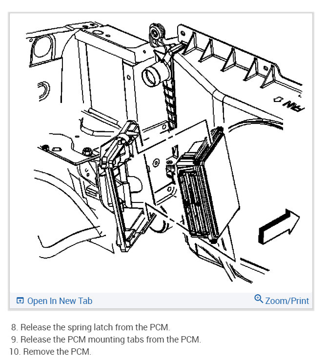

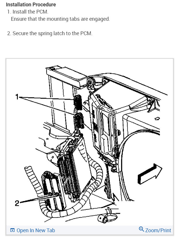

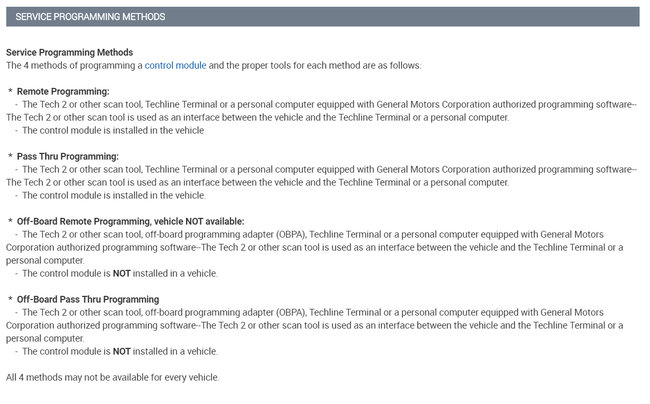

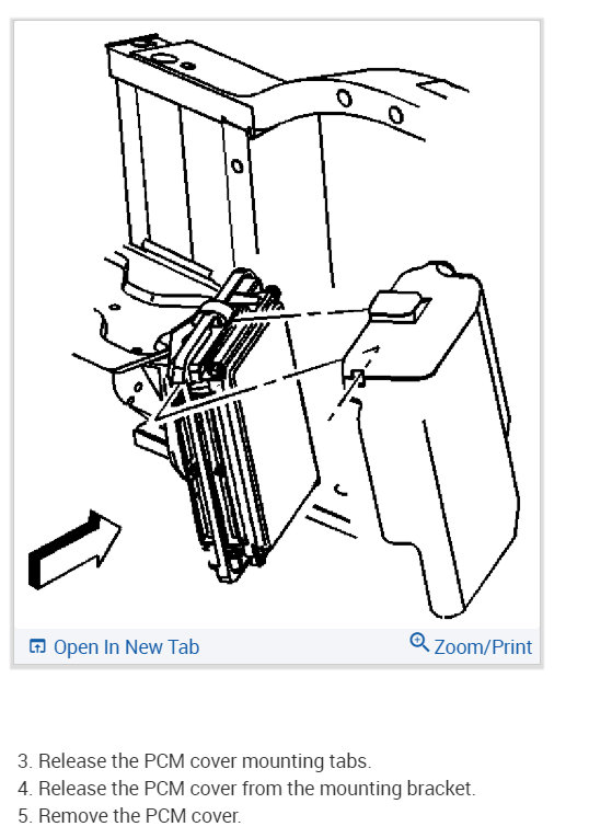

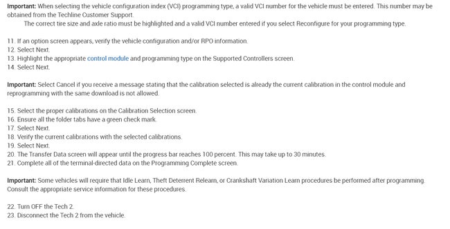

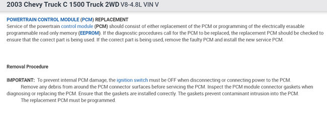

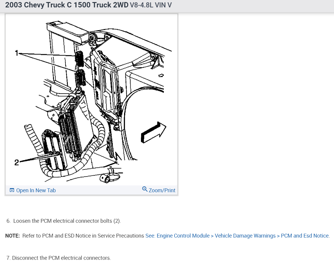

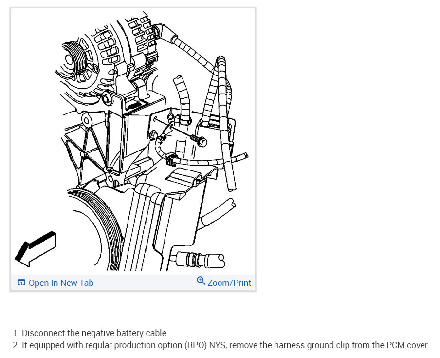

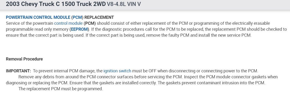

The PCM process the information from the VSS if the sensor is new and the cluster rebuild with no change chances are the PCM is bad. To be sure lets do a CAN scan which is the future of automotive repair you can get a CAN scanner from Amazon for about $50.00. here is a video to show you how:
https://youtu.be/u-4syLc-ifQ

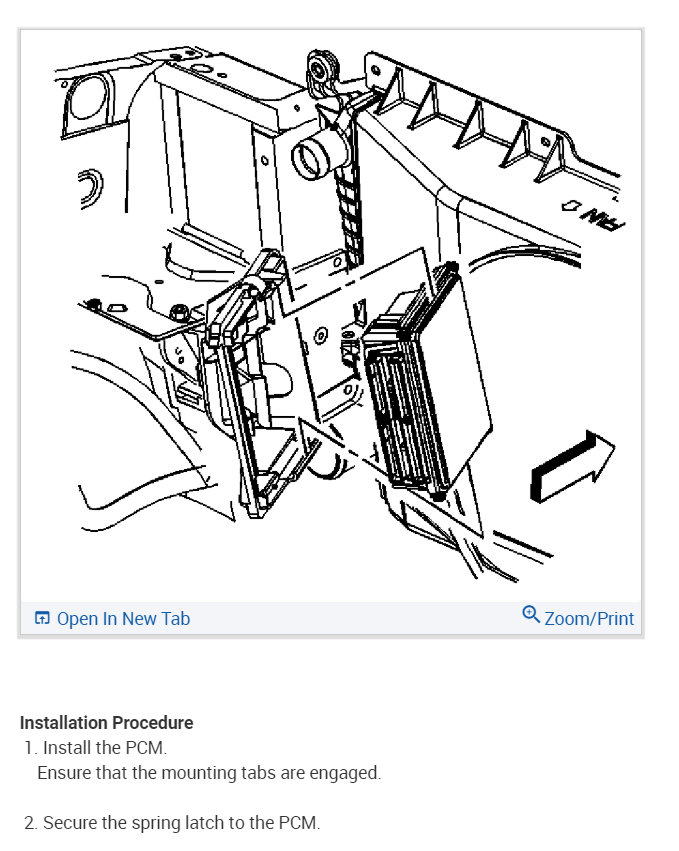

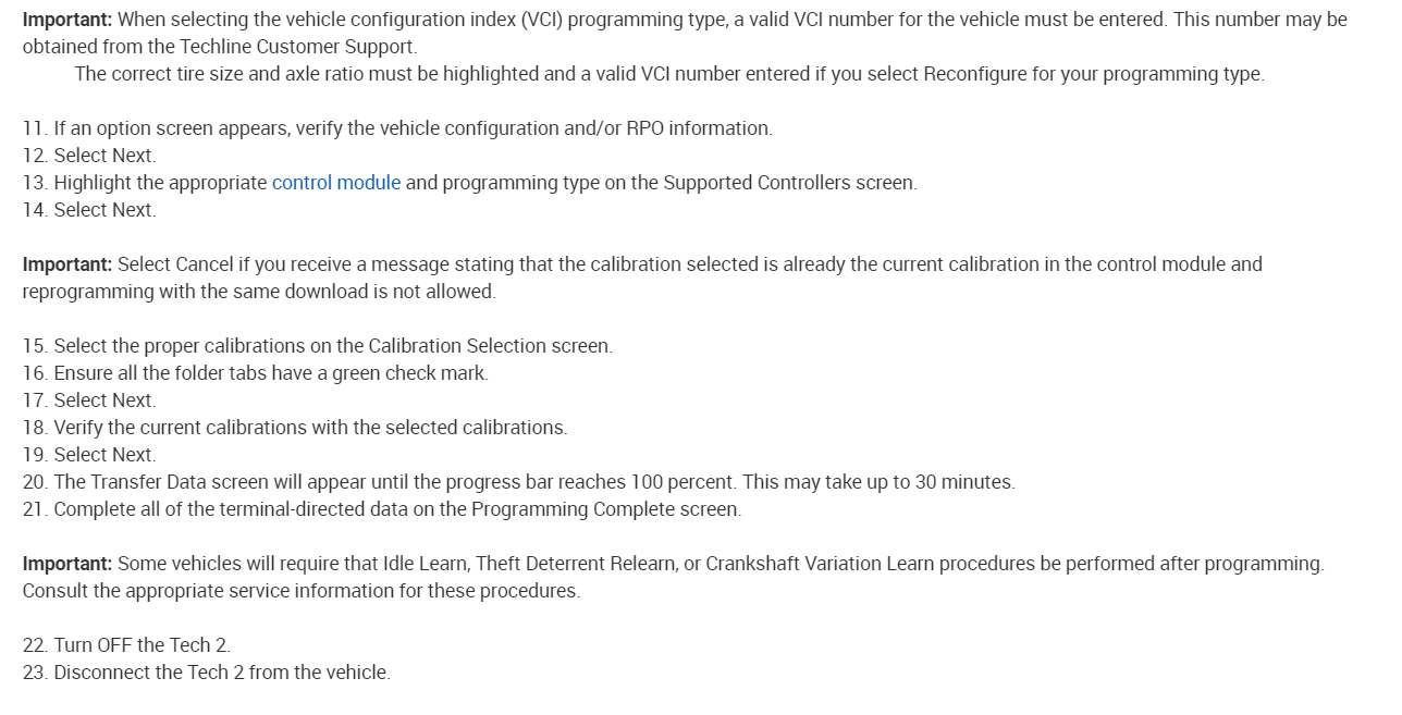

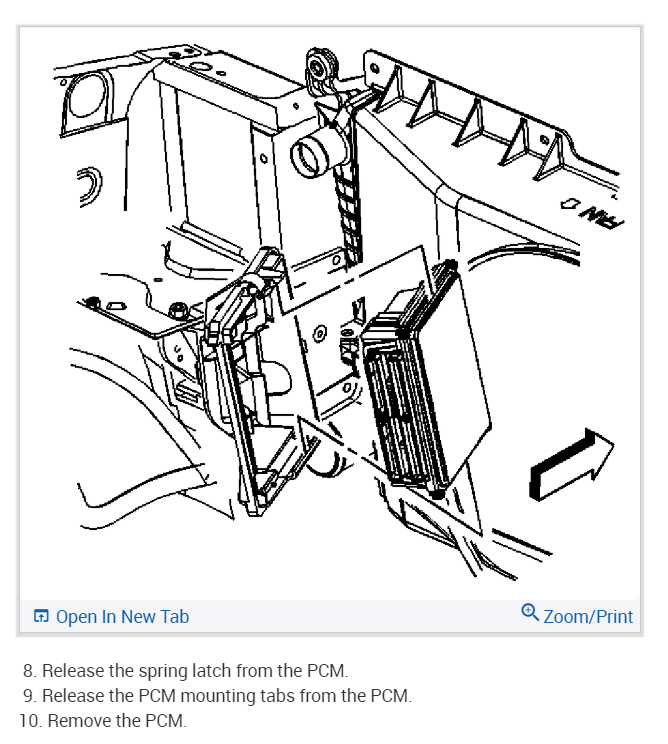

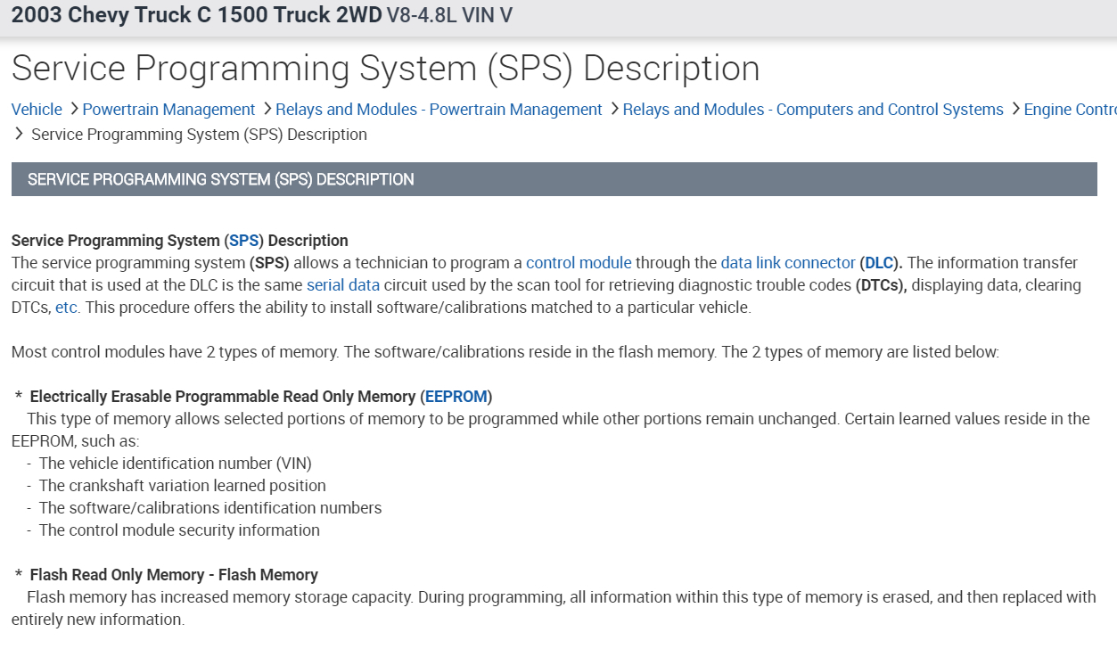

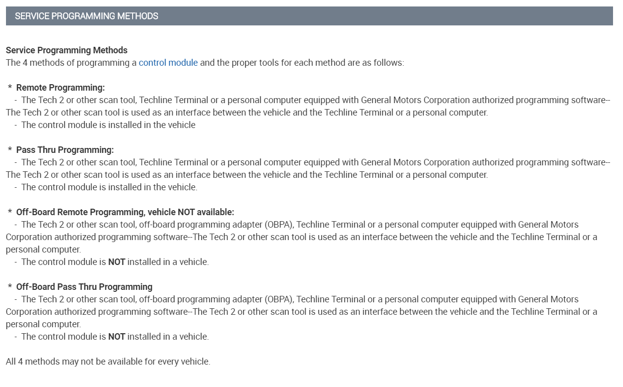

If nothing comes up here is how to change out the PCM in the diagrams below. Check out the diagrams (below). Please let us know what you find. We are interested to see what it is.
Jun 2, 2021 at 5:23 AM (Merged)
BILLY COONEY

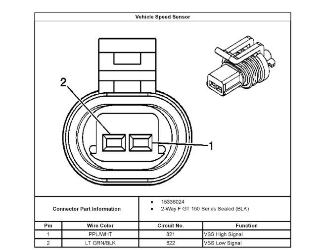

The PCM is a rebuild as well. I went through the wiring diagram and checked for voltage from the PCM to the sending unit and I didn't have the 5v from the PCM, so I ordered a rebuilt unit online. Once I have time I'm going to raise the bed and check for voltage at the sending unit connector.

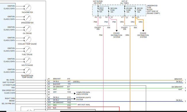

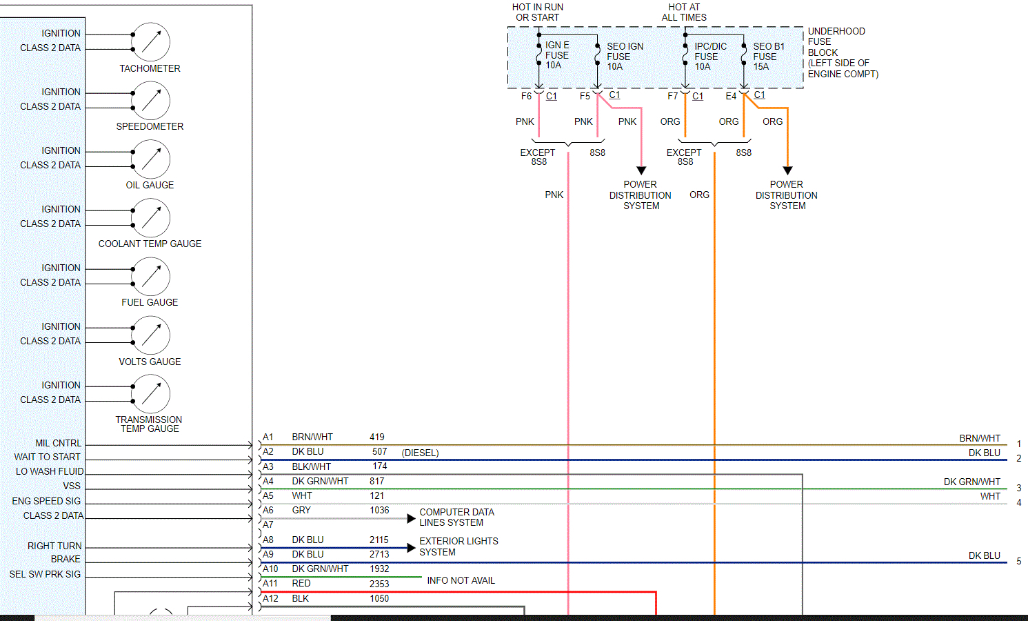

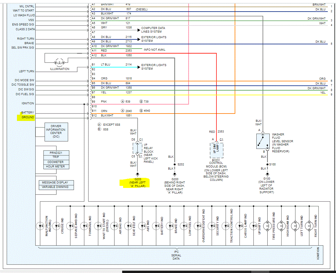

The speedometer needle is electrically operated by a stepper motor. You have already done a lot of work and it hasn't changed. What I would suggest is to check the ground for the instrument panel/speedo. Also, if you haven't already, check the connection on the rear of the IP to see if anything is corroded, loose, or damaged.
One last thought. When this happens, try to pay attention to the alternator gauge to see if it fluctuates when the speedo reacts.
I attached two wiring schematic pics for the speedometer/IP. I highlighted the ground I would check just to make sure it is tight, not damaged, and not corroded. The ground is on the left side near the kick panel/A pillar. I had to cut the pic in half to make it readable, but I did overlap them so you can easily follow them.
Check it and let me know what you find. Here is a link you may find helpful:
Let me know what you find.

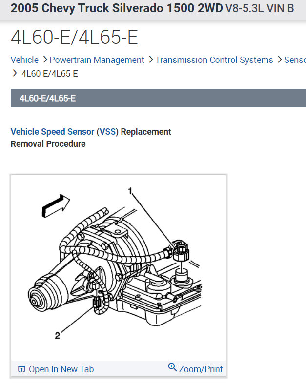

This is common when the vehicle speed sensor VSS goes out here is the location so you can check it out. Check out the diagrams (Below). Please let us know what happens.

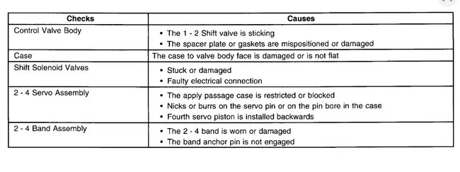

Changed transmission and it won’t shift,can only shift manually 1st to 2nd and speedometer doesn’t work. I have changed speed sensors and shift solenoids.

Good morning,
Did it not shift prior to the replacement?
Did the speedometer work prior to the replacement?
Are there any codes set?
The speedometer not working is most likely the issue. Is there a code set for that?
I attached some issues if it was internal.
Please give me as much background information that you can.
