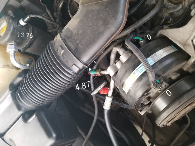

KBRAEGER
  • 11 POSTS

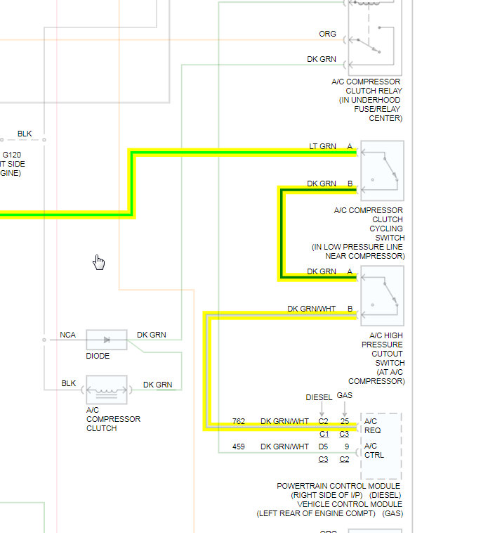

These are the voltage numbers to the four electrical terminals with the AC turned on (you can see them in white).
Apr 30, 2021 at 9:34 AM (Merged)

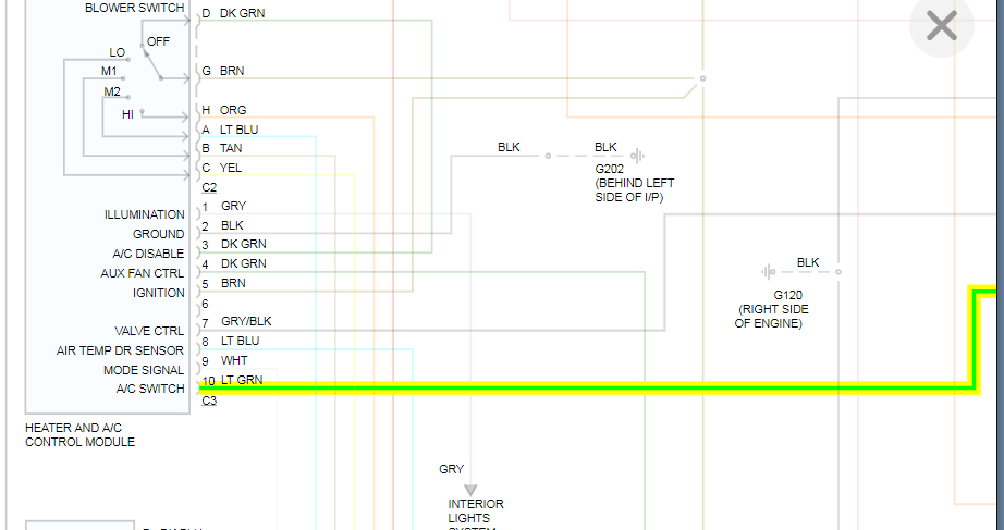

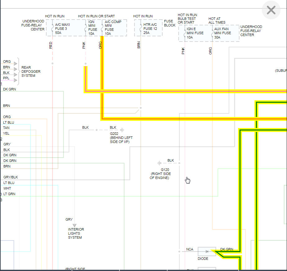

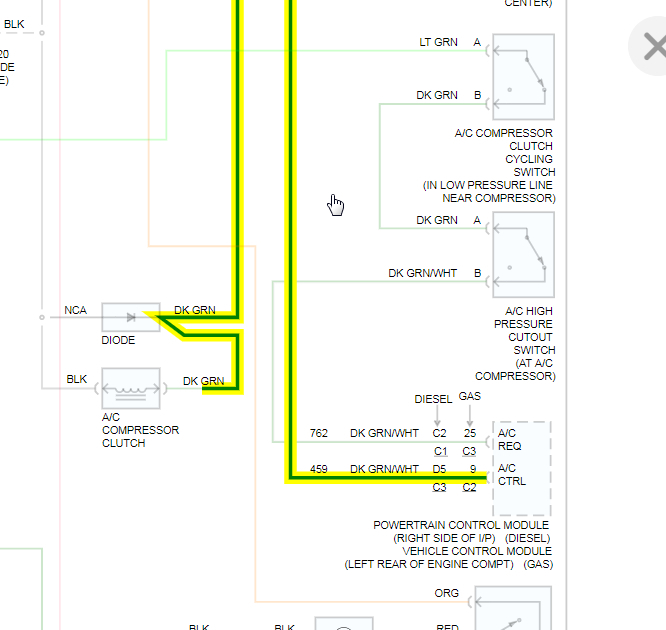

The high side switch with 0 volts is wrong. That is the sensor behind the compressor.
That voltage comes from the control head as you can see in the diagram I sent you on my first response.
KBRAEGER
  • 11 POSTS
That diagram is a little small for me to read. So how do we get the volts to the high side switch?
KBRAEGER
  • 11 POSTS
Can I jumper the wire directly from the low side switch to the high side switch? Or maybe the low switch is bad?
