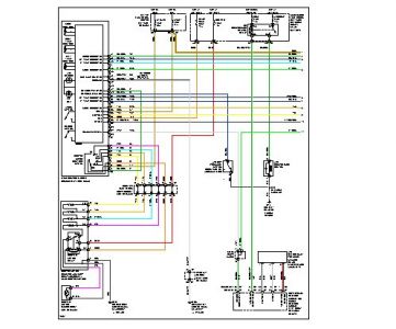

Have changed control head, compressor,
will come on after driving and coming to a stop
relay and fuse are both good
dont no what powers compressor on?

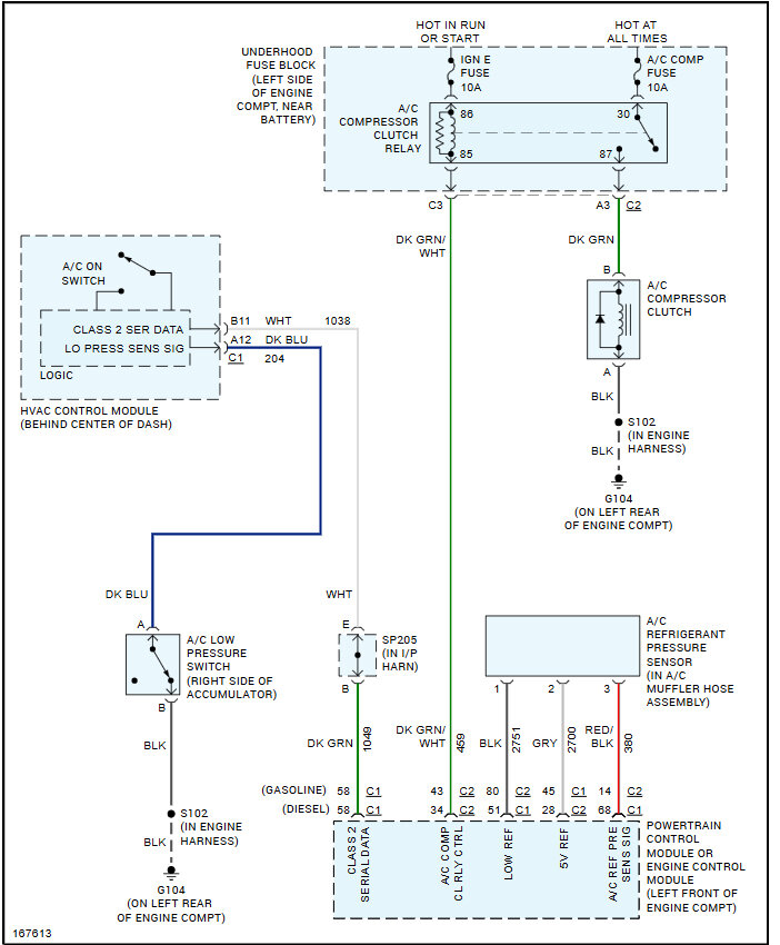

Thee is a pressure switch on the accumalator that powers the compressor. It could be bad or your system is low on freon.

Not getting any power to low pressure swich
What sends signal power to pressure switch?

Sorry i thought that you may have checked your fuse and relay first. YOu may have a bd relay. here is a diagram for you
