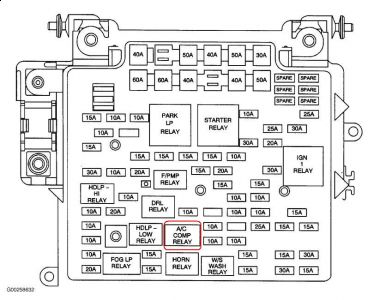

i have searched all over the truck cant find it?
Jul 16, 2009 at 11:54 AM
BLUELIGHTNIN6
  • 16,542 POSTS

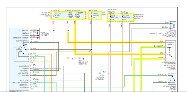

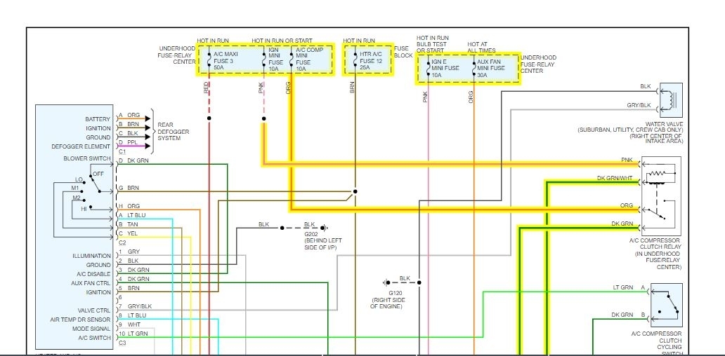

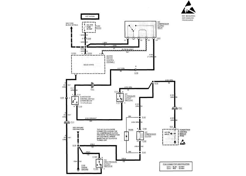

It is in the underhood fuse block..Check out the diagrams (Below). Please let us know if you need anything else to get the problem fixed.
https://images.2carpros.com/forum/automotive_pictures/261618_Noname_688.jpg
Jul 16, 2009 at 12:14 PM
11JIMBO
  • 10 POSTS

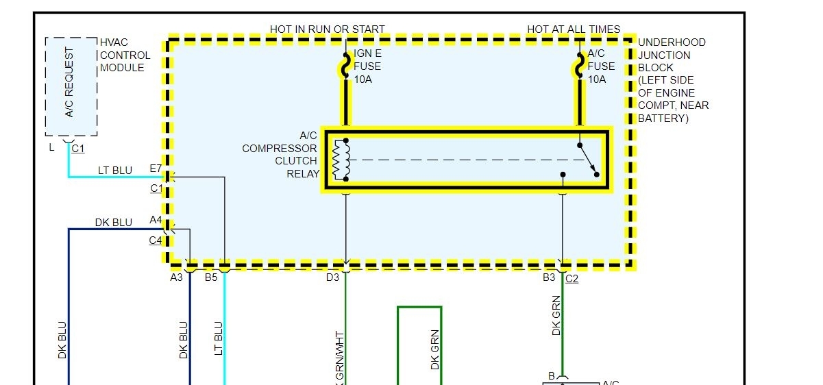

I have replaced the compressor, ,the relay, and all switches.the pressure is right all was charged when I replaced compressor. I can jump the relay the compressor will come on. But what's keeping it from working? I've got 5 volts at the low and hi pressure switches. I'm lost.
Apr 30, 2021 at 4:33 PM (Merged)

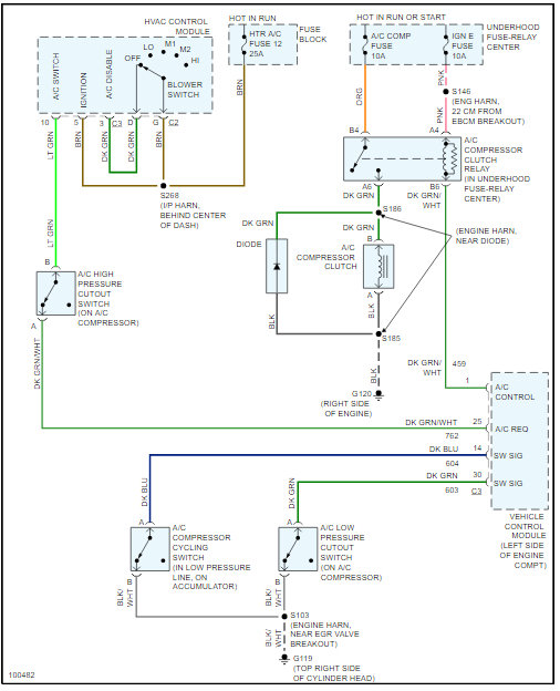

Good afternoon,
I attached a wiring diagram. Please check for 2 powers to the AC relay with the key on.
Let us make sure there is voltage at the relay.
11JIMBO
  • 10 POSTS
Yes, I have 12 volts at terminal 87. And with the key on terminal 85 is hot. Like I said I can jump the relay at 87 and 30 the compressor comes on. Unless the wire from the compressor is broke.
Okay, you have power at 30. 87 goes to the compressor.
The ECM grounds the control side of the relay or terminal 86. It will ground it and activate the compressor once it sees the correct signal from the sensor for high and low sides.
Did you try jumping the low side pressure sensor and see if the compressor comes on?

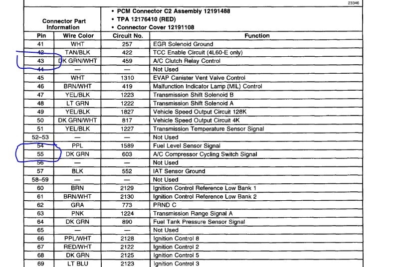

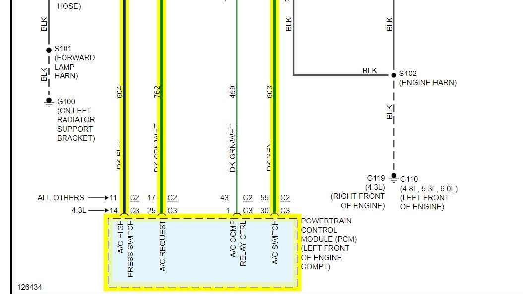

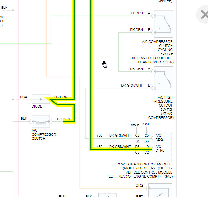

Yes sir, I have jumped the low side and the hi side I even jumped them both at the same time. I gave terminal 86 a ground and the compressor comes on but is not cycling . Well, maybe i'm wrong here I put my gauges back on the truck and it's reading low side 65 psi and hi side reads 75 psi but it is 48 degrees here.
The ECM is not grounding it.
Do you have a scan tool that can monitor the AC switches?
We are getting close to the ECM being the issue.

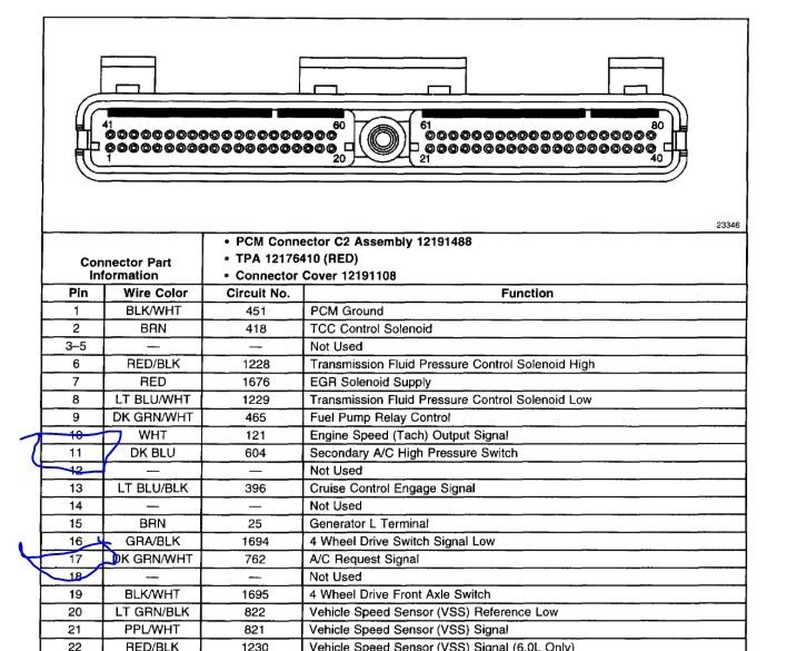

Pin 86 goes to the ECM. You need to see if the ECM is seeing the proper signals before condemning the ECM.
You need to check for voltage at the wires I circled on the red connector at the ECM for power.

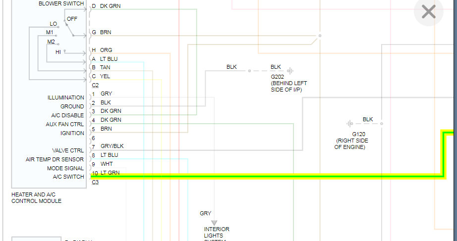

All is good except A/C button light comes on but does run ground to A/C relay pin #87 and I cannot find a wiring diagram that shows the button circuit.

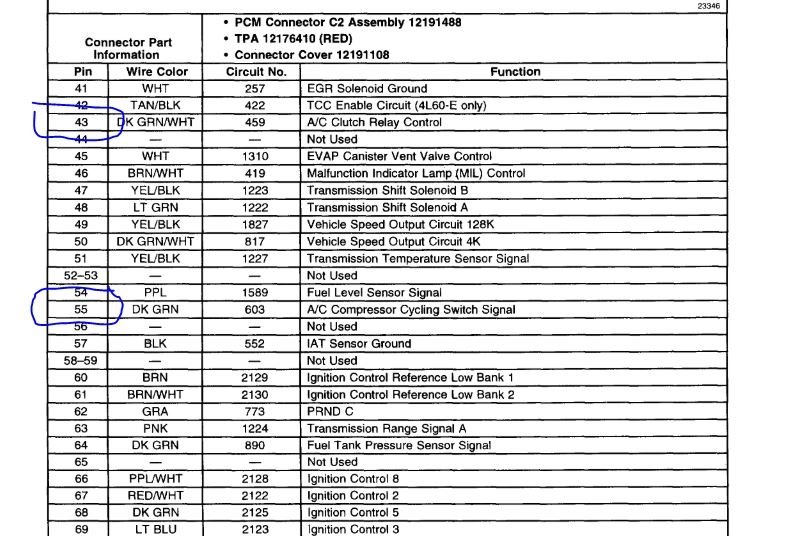

Okay, I have checked the power at the pins on the PCM. 11 pin has 9 volts,17 pin has 5 volts,43 has 12 volts and 55 has 9 volts . This with the key on and A/C on.
Okay, those are signals and they are getting there. The ECM is not grounding the relay even with the signals.
Looks like you need an ECM.

Did you check the dark green/white wire for power. That is from the relay and what needs to be grounded.

Yes sir with the key on it has power but when I give it a ground the compressor comes on but does not cycle.

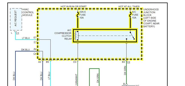

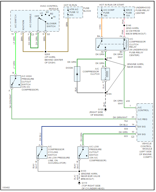

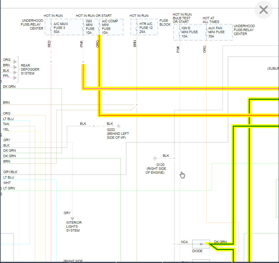

Good evening,
I attached a wiring diagram for you to view. Make sure you test all the fuses in the diagram for power on both sides. This is a power test, not a visual test.
The ECM supplies power to the low and high pressure switches as shown in the diagram.
Recheck the voltage with the key on and the A/C request on.
I am not worried about cycling.
For some reason, the ECM is seeing the signals but not commanding the compressor on by grounding that wire.
How much voltage is at that wire?

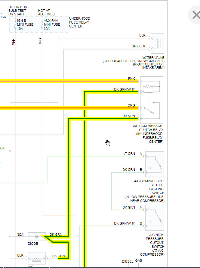

Okay, with the key on A/C on the green and white wire to pin 86 has 13 volts on it, but when I give it a ground the compressor kicks on.
Okay, good.
Keep me updated.
That is what is supposed to happen.
The ECM should be doing what you are doing.

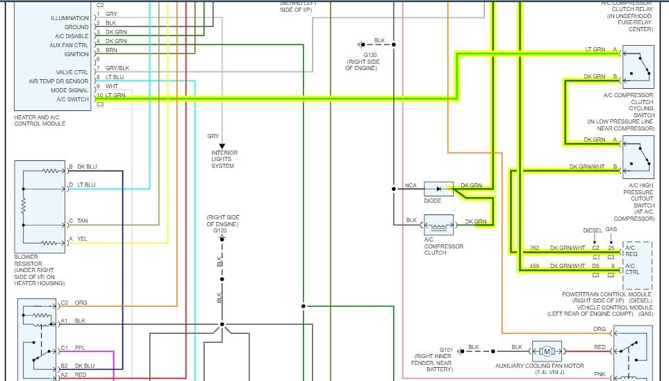

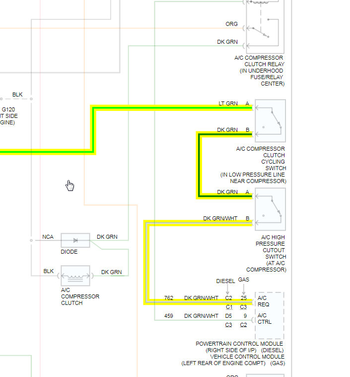

Okay. Let's walk through this. You can use a test light but depending on what we find we may need to come back with a meter.
First thing, when you turn the AC on does the indicator lamp in the control module turn on?
If so,

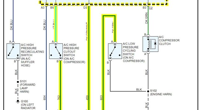

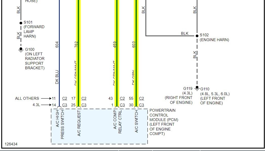

Look at the first 3 diagrams. This is the pure power feed to the clutch relay which feeds the clutch. We need to check power at each terminal at the relay with the the AC turned on. With the AC on you should have power on the two fused circuits. You should have power on the wire (Green/white) from the PCM when the compressor is commanded on. Then the green wire is the feed to the compressor. This is going to have power when the clutch is commanded on. So that means these two are going to be cycling so give it a minute. However, I suspect you have no power on either of these.
If that is the case, move onto the last two diagrams. These circuits are the command wires from the switch to the cycling switch, which leads to the pressure switch and that feeds to the PCM. Basically this is giving the info to the PCM in the following progression. You press the on button, which energizes the cycling switch, which energizes the pressure switch which sends power to the PCM. So this means if the power makes it all the way through to the PCM then the PCM says it is okay to turn on the compressor so it then sends power up to the clutch relay which sends it down through the clutch.
All of this to say, we need to know what has power and what does not and we can figure out what the issue is.
Let me know if you have questions. Thanks

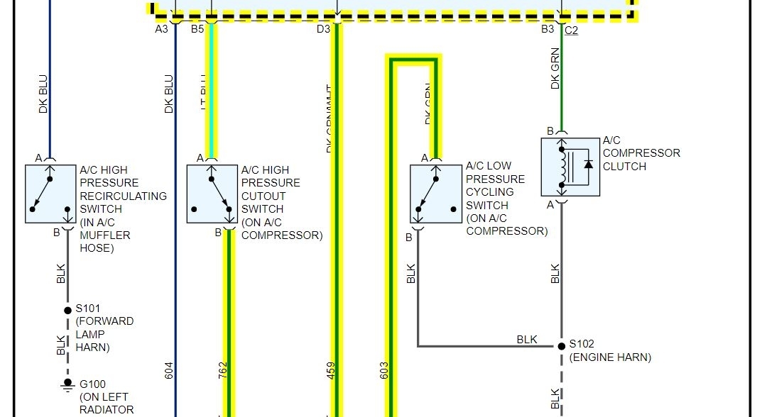

Good afternoon.
What is the high and low side pressure with the engine off?
I attached a wire diagram for you to view. Check the fuses for the clutch relay and make sure there is power on both sides of the fuses.
Did you check for voltage to the switches?
