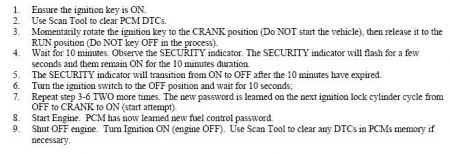

JOSHZ7198
Yea its turning the motor over but now we think the starter went out and something else happen to go at the same time. Just my luck. But we dont think its gettin any fuel for some reason. You can hear the fuel pump come on though, and it was just changed about 1 yr ago
+1
Friday, February 5th, 2021 AT 8:37 AM (Merged)
JDL
  • 16,098 POSTS
Hi, if you think the theft system might be an issue, You can try this, don't know if it will help?
https://www.2carpros.com/forum/automotive_pictures/170934_relearn_1.jpg
