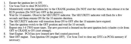

All dash lights will not come on. I was told I had a security alarm problem and reset the truck by leaving the key turned over for fifteen minutes and it turned on no problem, but it does not want to turn on anymore. I was told it was because I do not have the original key, but not totally sure. The lights do not work now and the fuel pump is not kicking on. Does anyone know what is going on? Will an aftermarket alarm system work with a factory key? It does this once or twice a year and I normally would just leave it sit, but I am stumped now. Someone help.
Thursday, September 3rd, 2020 AT 5:05 PM (Merged)

LISADOMINGUEZ
  • 1999 CHEVROLET SILVERADO
We burned something up in our truck when we used a generator to try and jump it. Smoke come up through the dash and now it will crank but not turn over? What could it be?

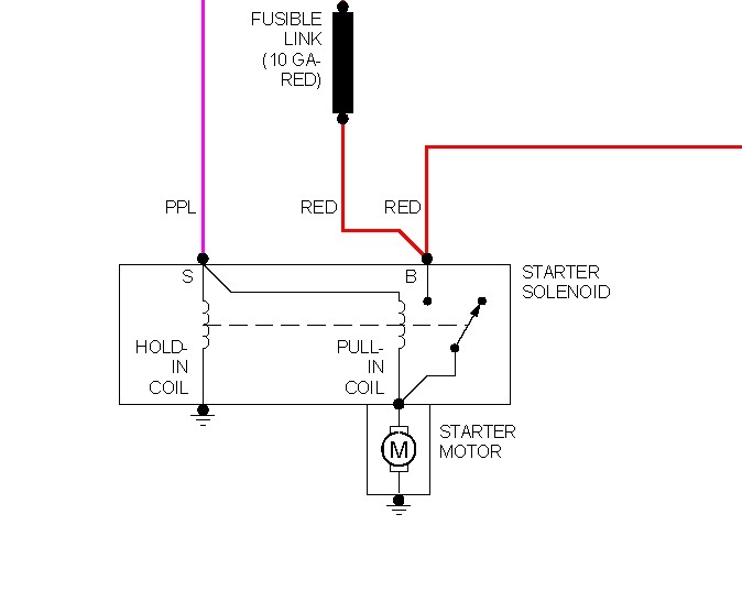

JDL
  • 16,098 POSTS
Use a digital multimeter and we can help you do some testing. Place meter leads across battery posts, everything off, what is the reading? If the battery is down, take it off and get it charged.
If battery voltage is lost, where applicable, your security system could be an issue?
You could test the starter circuits, any testing at the starter, make sure tranny is in park or neutral and the parking brake is set.
Thursday, September 3rd, 2020 AT 5:06 PM (Merged)

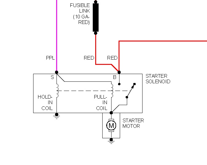

JDL
  • 16,098 POSTS
A security system shouldn't effect the starter. The purple wire at the starter S terminal goes hot with the key in the crank position. The starter B terminal is hot all the time.

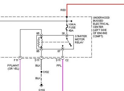

JDL
  • 16,098 POSTS
Just to add, The purple wire at the starter solenoid, should be be hot with the key in the crank position. Is it? Any testing, make sure the tranny is in park or neutral and the e-brake is set. If the wire isn't hot, check circuits at the starter relay in the underhood fuse box. There are applicable fuses, check the fuse/s. Some of the national brand autostores will test the starter for you, if you take it off and take it to them. Let us know.
