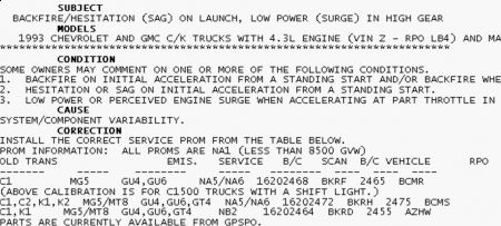

Your ECM may need a new PROM, I will email the info to you.

I actually change dthat out about 3 or 4 months ago. The actual Prom itself fried which is normally unheard of. So there is a new Prom in the computer. That was expensive considering it was in a shop that GM has specially for parts that arent being manufactored again. Was like 150 bucks for a PROM haha.

But. Well could be a long shot but the numbers of the PROMs dont match up. The one that shows on my recept says 16169705 whn the ones that you sent me are start with 162. But could be a slight difference since mine is a K1500 and not a C1500

This is for C and K series, as long as it's a standard shift, Manual transmission.
https://www.2carpros.com/forum/automotive_pictures/62217_Prom_1.jpg
