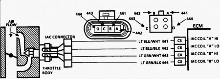

Didnt see IAC on the list, test it this way: Idle Air Control (IAC) Motor 1. Disconnect harness connector to motor. Check resistance across IAC coil terminals "A" to "B" and "C" to "D". See Fig. 5 . Resistance should be 40-80 ohms. If okay, go to next step. If resistance is not as specified, replace IAC motor. 2. Check resistance between IAC terminals "B" to "C" and "A" to "D". Resistance should be infinite. If resistance is not as specified, replace IAC motor. NOTE: Functional testing of Idle Air Control (IAC) motor requires a scan tester capable of cycling ECM output devices (bidirectional) or a special IAC Driver and Node Light Set (222L or J-37027). Flow charts in TESTS W/CODES articles in this section may refer to Tech 1 tester, General Motors' bidirectional tester. Page 1 of 1 1/28/2010 ...
https://images.2carpros.com/forum/automotive_pictures/62217_iac_3.jpg
